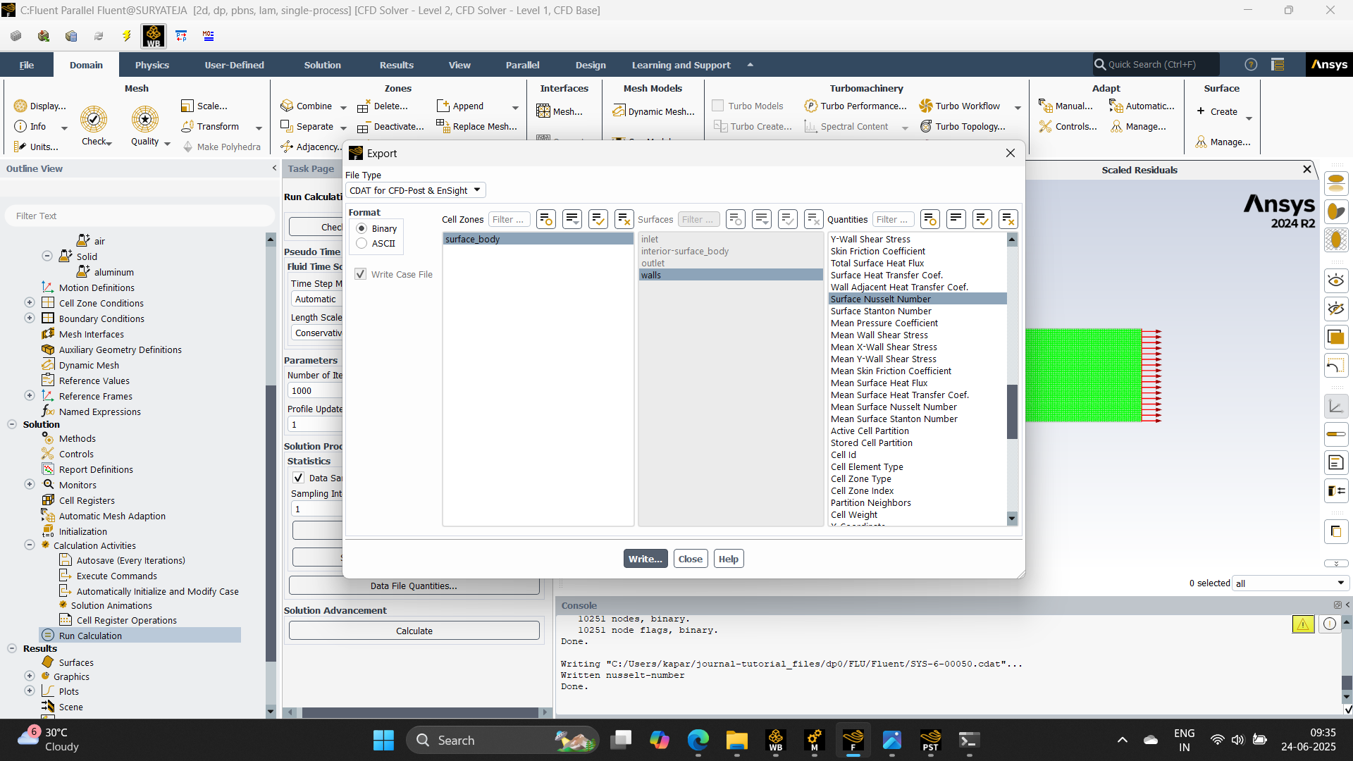

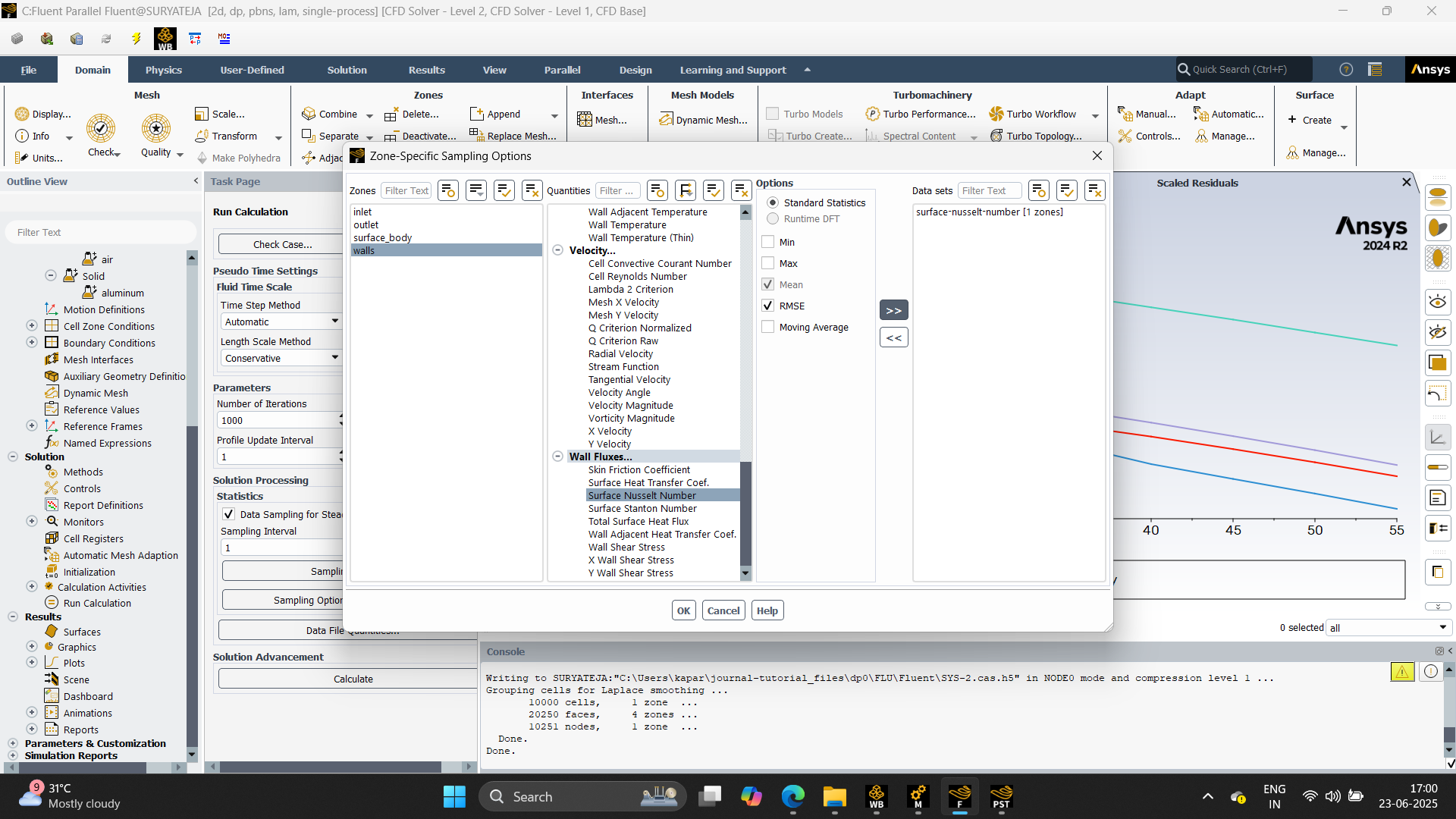

      Hello there, I'm recreating the work from a video tutorial which I've found in YouTube to link Ansys Workbench to MATLAB using journal files. I've followed the video until 3:44, but right there, I couldn't see the variable 'Surface Nusselt Number' in the Variable Selector to use inside areaAve(Surface Nusselt Number)@walls in CFD-Post for the 'Results' component system (I'm using Ansys 2024 R2). I've searched the web & prompted ChatGPT for a solution. After I've initaialized the solution in Ansys Fluent, I've even selected all of the options in 'Sampling Options...', and in 'Sampling Options (Zone Selection)...' I was able to select select 'Surface Nusselt Number' in 'Wall Fluxes...' and I've selected it for the Zone 'walls' like I've interpreted from the video (as shown in the 1st pic).

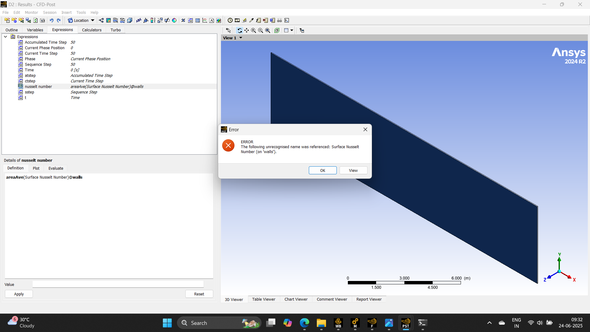

      but when I proceed to the later stages of the video in CFD-Post (corresponding to the same WorkBench Project), as I said I couldn't find the 'Surface Nusselt Number' in the Variable Selector. Even, if I try to manually type it the formula for the expression, I'm meeting errors like this:
      So, then from ChatGPT's suggestion, I've exported the solution data from Fluent as shown below in a .CDAT file to manually process it in a new CFD-Post Window:

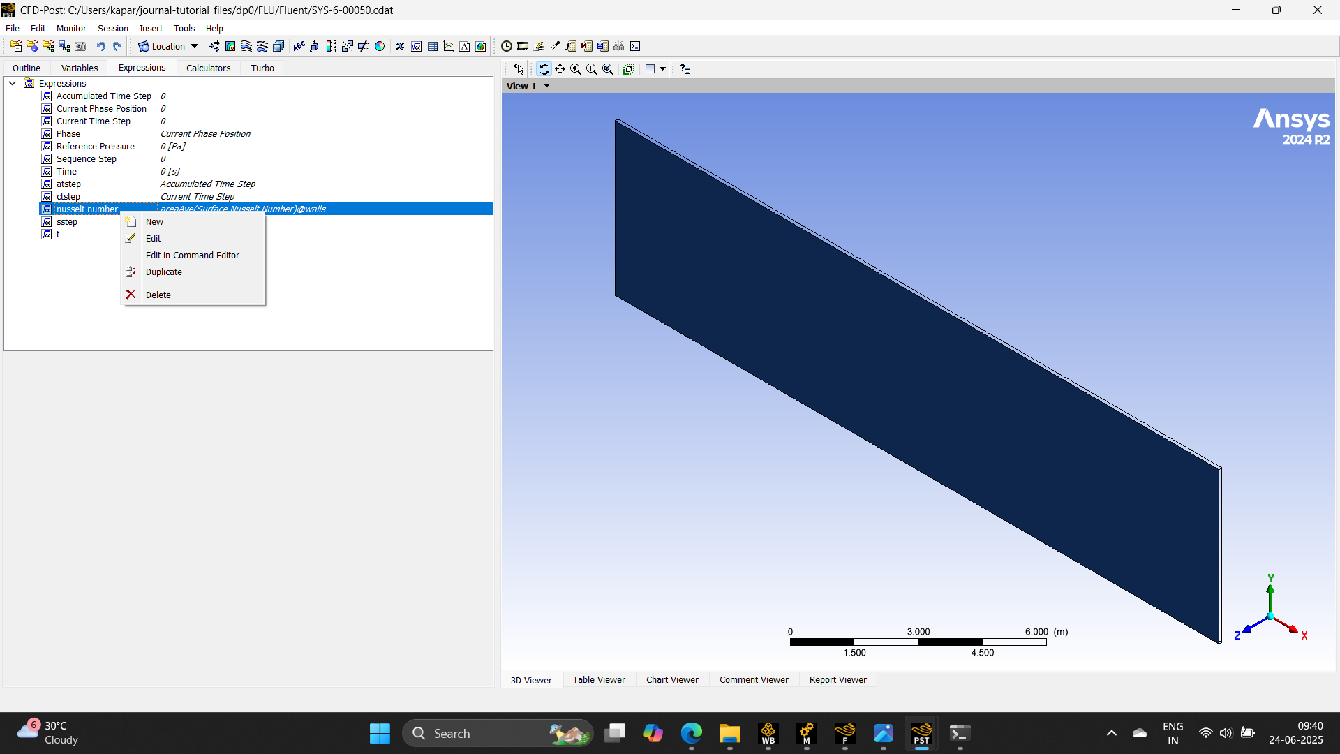

      Now I can open this .CDAT file in CFD-Post and compute the value of the variable 'nusselt number' (which matches exactly with the YT video), but I can't link this expression to be a Workbench output parameter (like I have to, to follow the next steps in the video)

      The surface Nusselt Number in Fluent has a definition in the Fluent User's Guide and as it's also then calculated from other data won't be exported by default from Fluent in the data file. It's a surface value hence something appearing in .cdat    If you create a Report Definition in Fluent that can be promoted to a parameter.
