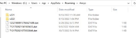

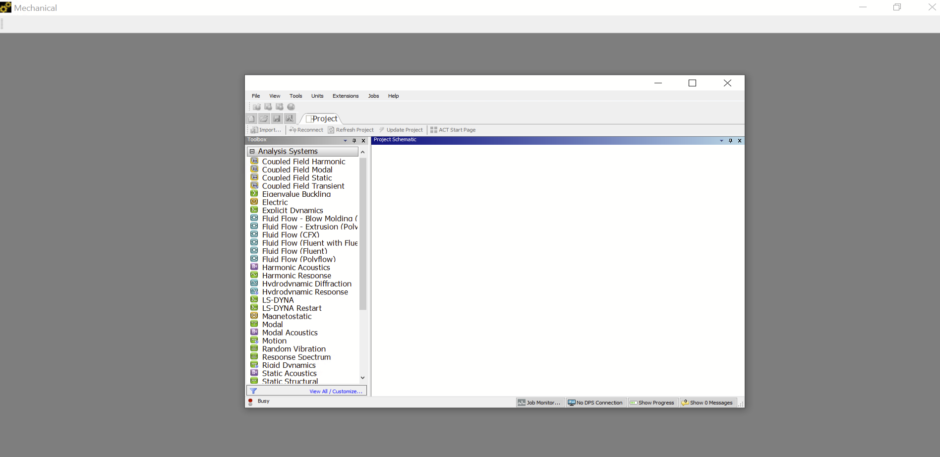

      I have a lab of 27 computers.  All were running Ansys Mechanical 2022 R2 successfully for the past month.  I was just notified that half of the computers are showing a gray screen when Mechanical 2022 R2 is started now.  Has anyone encountered this before?   Thanks.

      Gray screen usually means graphics driver needs updated/unsupported graphics card.
      First, try the following:
      Make sure no ANSYS Programs are running.
      Under %APPDATA%\Ansys
      a directory named v222 will exist.
      Rename this directory to v222.old
      Now try to run.
      If this doesn't fix the issue, check on updating the graphics driver.

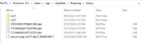

    • cmn10
      Hi George,
             Thanks for the response.  It's strange only half of the PC's in the lab are not working currently.  They all have the same hardware.  I have attached screenshots of the Ansys directory of a non-working and working PC.
      We upgraded from version R2022 R1 to R2.  Can I delete the v221 folder?  What are the .dat files?  I renamed the v222 folder in my dir to v222.old and still got the gray screen.  I upgraded the nvidia drivers for the RTX A4000, rebooted and I still get the gray screen.  Ansys was working before when it was first installed.  Nothing else was installed that I am aware of.  What else could be the issue?

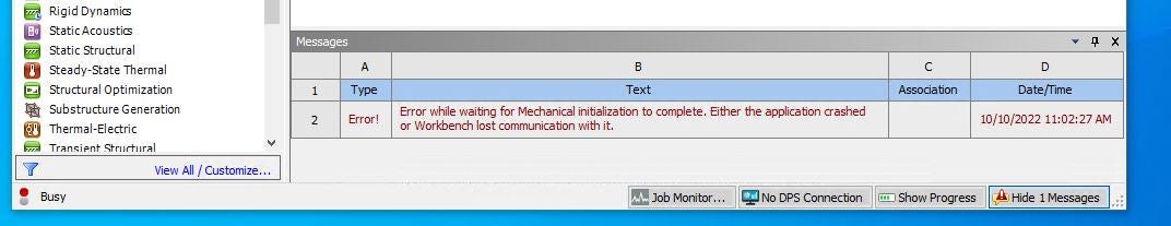

    • cmn10
      Hi George,
            I also see an error as attached.

    • MangeshANSYS
      Hello please try the steps about path and registering dlls suggested by George at
      /forum/forums/topic/big-problem-with-static-structural-model/
