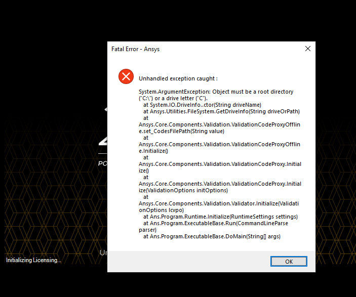

      Hi, i get this error with non-admin users at a university setting or student and faculty using Ansys:
      Any clues why this is happening?  We cannot give students or faculty local admin rights, that is out of the question.
    • George Karnos
      Are you using UNC paths?
      This error is usually do to Path not be a local or mapped network drive.
