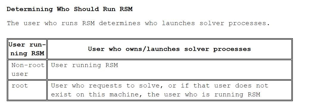

      I changed the HPC License from Pack  to Pool in the HPC and Analysis Options and the problem was resolved. I have one more question. I have some other users that need to use the  linux servers to submit jobs, but when they try the job status is unknown and only submit jobs with the account that I start the RSM service.
    • randyk
      If ansoftrsmservice is running as root and the submitting user has an account on the Linux machine - the processes should run as the submitting user.
