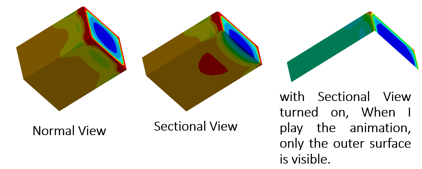

      Hello ,
      I am facing an issue in Ansys 2022 R2, while animating the results .
      With Section View turned on, when I play the animation, the model becomes hollow and only the outer surfaces are visible in the animation.
       Should I make any changes in the settings ? Someone please help me.Thank You in advance.
      Manoj

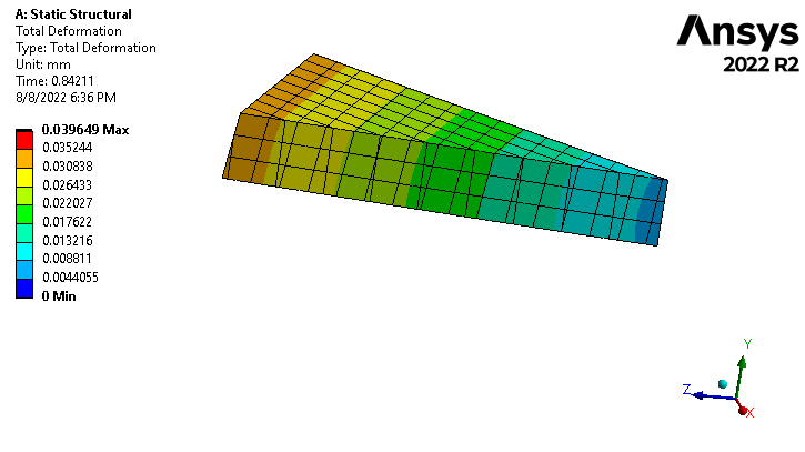

    • Aniket Chavan
      It seems case specific, as I tried this at my end simple geometry and I can see the view in section plane:
      -Aniket
    • mkumar
      Hai Aniket,
      Thanks for your reply.
      I am able to view the section. But when i animate, everything vanishes except the outer surface.
      Please set to no wireframe in the results and then try to animate. Let me know whether it is working fine or not.
      Manoj
