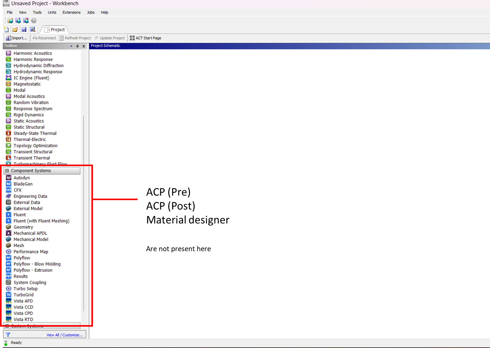

SubscriberI am a student from BITS Pilani, Hyderabad Campus, and I am facing an issue with the installation of ANSYS 2021. I have installed the software educational version on my system. However, the ACP (Pre-Post) and Material Designer modules are not appearing in the Workbench. I have attached screenshots of the issue details for your reference. Kindly assist me in resolving this problem. Thank you for your time and support.

Forum ModeratorHi,
Point me to the location from where you installed the application (screenshot is fine too)
Generally this error occurs if ACP, Material Desginer was not selected during installation, also confirm if you have license for same.
