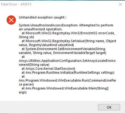

ANSYS 19.1 fatal error
    • vadim11
      When I try to open workbench I get a fatal error "unhandled exception caught"
      Tried cleaning up registry and changing the name. Didn't Work.

      Hi vadim11,
      Could you re-post the screenshot ?
      I can't see it.

    • tsiriaks
      Hi vadim11,
      I can't access this link.
      Can you download the screenshot out of it and re-upload it on here ?

      Open a Command Prompt (DOS) "as administrator" and issue the following commands
      regsvr32.exe ole32.dll
      regsvr32.exe atl.dll
      regsvr32.exe oleaut32.dll
      regsvr32.exe scrrun.dll
      regsvr32.exe jscript.dll
      regsvr32.exe vbscript.dll
      Does this make any differences ?
      If that doesn't help, check if you have environment variables ANSYS191_DIR and AWP_ROOT191 set.
      Did this v191 work before or this is the first time you install ANSYS on this machine ?
      Check your installation directory (default is C:Program FilesANSYS Inc) and see if you have install.err file. If so, please post its content here.
      Thanks,
      Win
    • vadim11
      the command prompt commands worked.
      this was the 1st time I've tried installing it on this machine.
      Thank you for the help
