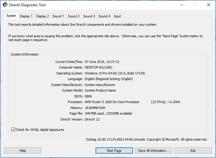

SubscriberHello,Â

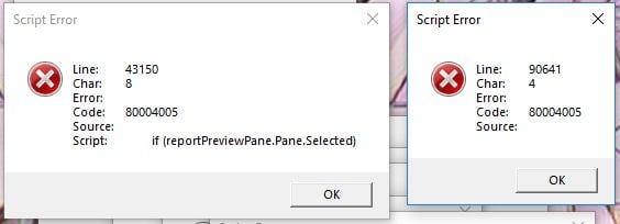

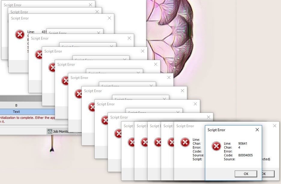

I am following along with the video tutorials from cornell and get to the step where I double click model to open Mechanical, a grey window appears and nothing else, when exited this error is shown,
'Error while waiting for Mechanical initialization to complete. Either the application crashed or Workbench los communication with it.'
I have read similar problems in other posts how ever none of the fixes worked for me. I think it maybe due to installing on a different drive to that the OS is on?Â
I have included screenshots of things requested in other threads.
Hope someone can help as Im also starting a university course where I need to use Ansys.

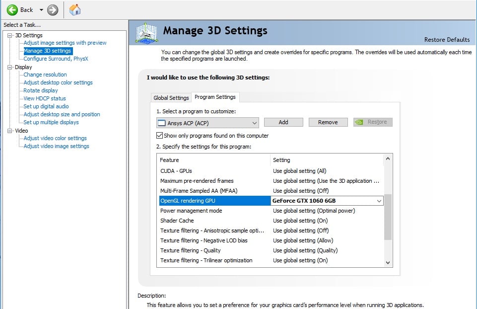

Have you tried this setting for your Nvidia ?
right click on the desktop then launch Nvidia Control Panel >> Manage 3D settings >> set Preferred graphics processor to be "High-performance NVIDIA processor.

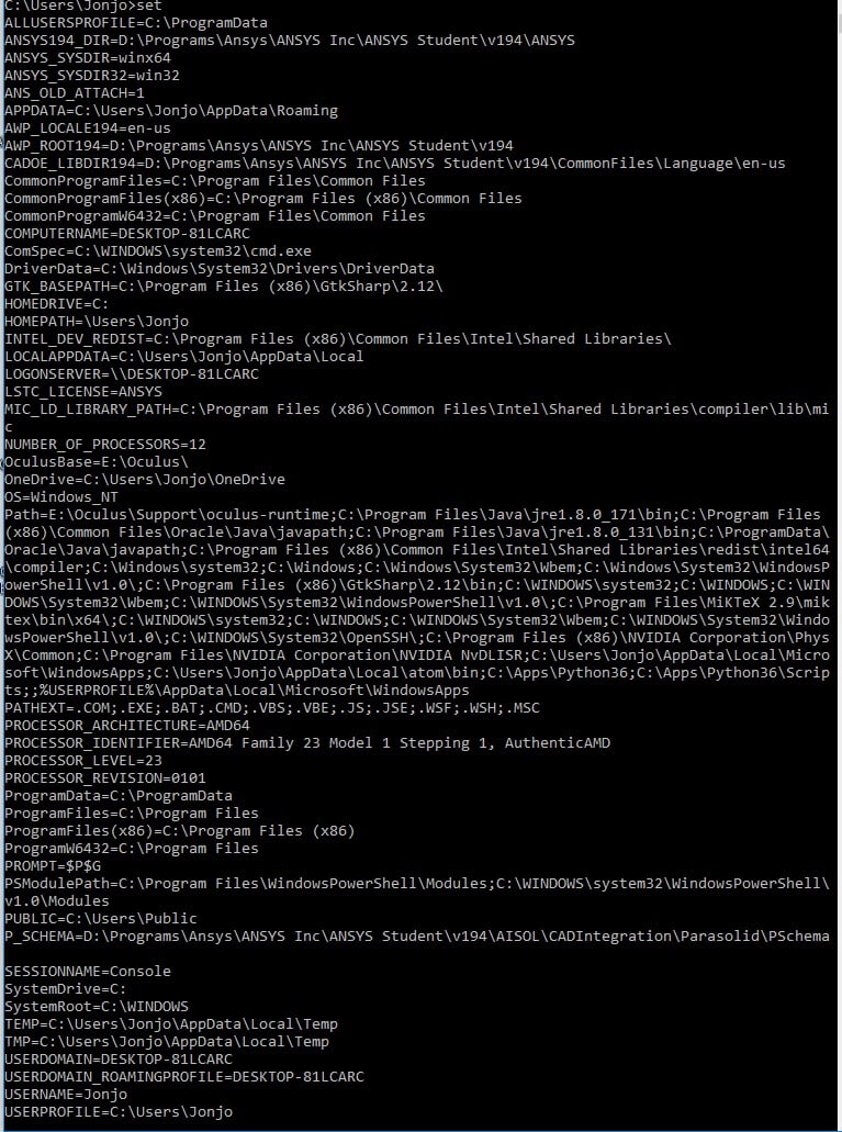

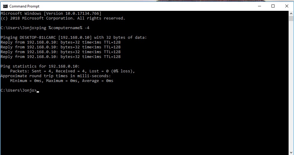

Please also post the screenshot of the output of the 'set' command (without quote ' ' ) from CMD Prompt.
Thanks,
Win
June 7, 2019 at 7:00 pm
ParsleyNeale
SubscriberThanks for the reply tsiriaks,

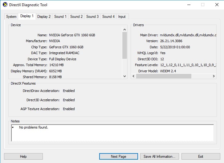

no, the design modeler opens ok and am able to use it, I have downloaded latest drivers for the graphics card, and tried turning of the anti virus.
I couldnt find the setting you suggested for the nvidia graphics card, I forced open gl to use the gfx instead of having it on auto, but this didnt help.
Here is the screen i get when i follow your directions, and also the set CMd prompt.

Please also include the top part of the output of 'set' command.
For the Nvidia setting, click 'Add' , then choose the Workbench shortcut. I think yours should be hereÂ
"E:ANSYS2ANSYS IncANSYS Studentv192FrameworkbinWin64runwb2.exe"
then, make sure that you also set to use Geforce GTX , not Auto , for the OpenGL

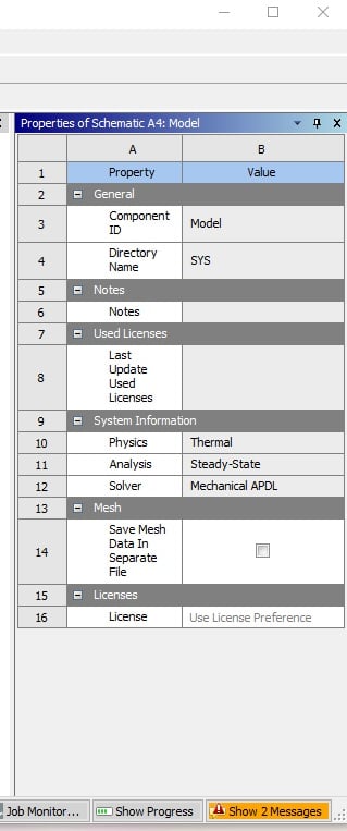

I also tried recreating the project schematic ive been using from scratch following the tutorial again, to make sure it wasnt something i'd done wrong along the way to cause this.
I really apreciate the help, and would love to try any more ideas you have?

SubscriberCould it be a license problem? I have tried starting mechanical with the property license setting set to "Use License Preference" and "ANSYS Academic Teaching Introduction "

June 12, 2019 at 11:31 pm
tsiriaks
Ansys EmployeeHmm, this looks good.
Do you have any security software (Firewall, Anti-virus, etc.) ? If so, can you try turning all of them off , for a quick test ? If it helps, we can turn them back on and add exclusions afterwards.
If that doesn't work, please post the screenshot of this grey Mechanical window with the setup in Workbench project GUI.
Thanks,
Win
June 14, 2019 at 2:00 pm
June 14, 2019 at 11:16 pm
tsiriaks
Ansys EmployeeCan you post the entire Workbench window while this Mechanical hangs ? Also, make sure to click the 'Show 2 Messages' in Workbench.
June 16, 2019 at 8:59 am
ParsleyNeale
SubscriberSure, here it is. This is while mechanical is open but greyed out, a new identical error message appears when I give up and cross off the mechanical window.
Ive waited up to an hour to make sure, but usually around 5 minutes, also when using task manager ansys and an ansys module with the same icon as mechanical comes up with 0% processing used.

ParsleyNeale
SubscriberThe pings,,,,
C:UsersJonjo>ping localhost -4
Pinging DESKTOP-81LCARC [127.0.0.1] with 32 bytes of data:
Reply from 127.0.0.1: bytes=32 time<1ms TTL=128
Ping statistics for 127.0.0.1:
  Packets: Sent = 4, Received = 4, Lost = 0 (0% loss),
Approximate round trip times in milli-seconds:
  Minimum = 0ms, Maximum = 0ms, Average = 0ms
C:UsersJonjo>ping 127.0.0.1
Pinging 127.0.0.1 with 32 bytes of data:
Trying the manual registration of DLLs now
