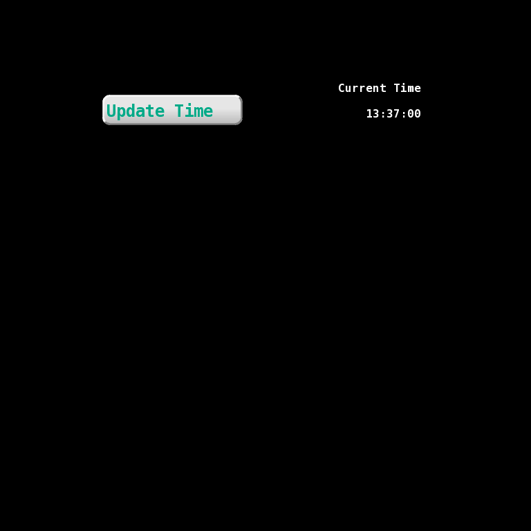

For the sake of simplicity, we will build a small DF: a label displaying the current time, and a button that updates the time value when clicked. Each update triggers a round-trip between the CDS, which detects the click, and the UA, which queries current time and sends it back.
In SCADE UA Page Creator, we’ll first create a new UA page and assign it a UA ID (arbitrarily, 1). Then, we’ll add the following widgets:
- Label (Widget ID 1) – static text – LabelString=Current Time
- Label (Widget ID 2) – time display – LabelString=13:37:00
- PushButton (Widget ID 3) – trigger to update the time – LabelString=Update Time
Finally, we position our widgets as follows on the design surface:
We can now save our project and generate the binary DF using the "DF Generation" generation configuration.

We are finally ready to run everything on our local machine: the SCADE CDS with our DF loaded and our Python UA.
.venv\Scripts\activate set "PYTHONPATH=%SCADE_INSTALL%\SCADE A661\PythonLib;%SCADE_INSTALL%\SCADE\APIs\Python\lib" python logic\UA.py
When interacting with the PushButton in the server display window, Label 2 should update with the current time.
