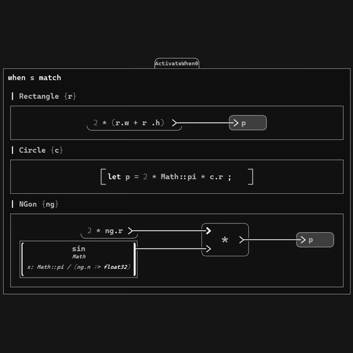

Aubanel, our director of Ansys Customer Excellence, demonstrates a new construct in Swan, the modeling language used in Scade One, called variant types.
Variant types?
A variant type defines a data structure holding a value that can take on several different, but fixed, types. The generated C code uses union in a safe, MISRA-compatible way, by using a tag field to know which type is in use.
In short, a variant type is a type that can be this or that or something else.
In the video, Aubanel showcases this with a
shapetype that can be either a rectangle, a circle or a polygon.This makes it easy to design generic operators that perform calculations on shapes, with no need to duplicate our logic to handle various cases for various shape types:
Demo time 🎬
