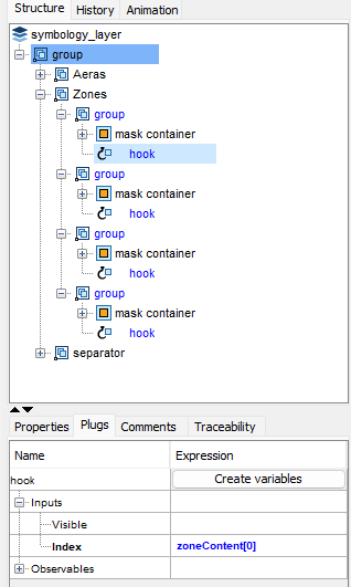

Creating SCADE Display reference objects
We want to have multiple zones and the flexibility to swap content between these zones. So, what do we need for each zone? First, a hook to dynamically display the selected object. Second, a mask to ensure that our object doesn’t overflow into other parts of the HMI, especially if it’s larger than the designated zone.
In our example, we’ll arbitrarily define four zones. To manage the indices of each hook object, we’ll use an array called
zoneContent:
Structure of ourWindowManagerreference objectThe
separatorgroup at the bottom contains a few lines to clearly visualize the boundaries of each zone.Note: we could factorize the model even further — but that would mean creating "hooks of hooks" and I don’t want to lose you this early in the article! 😄

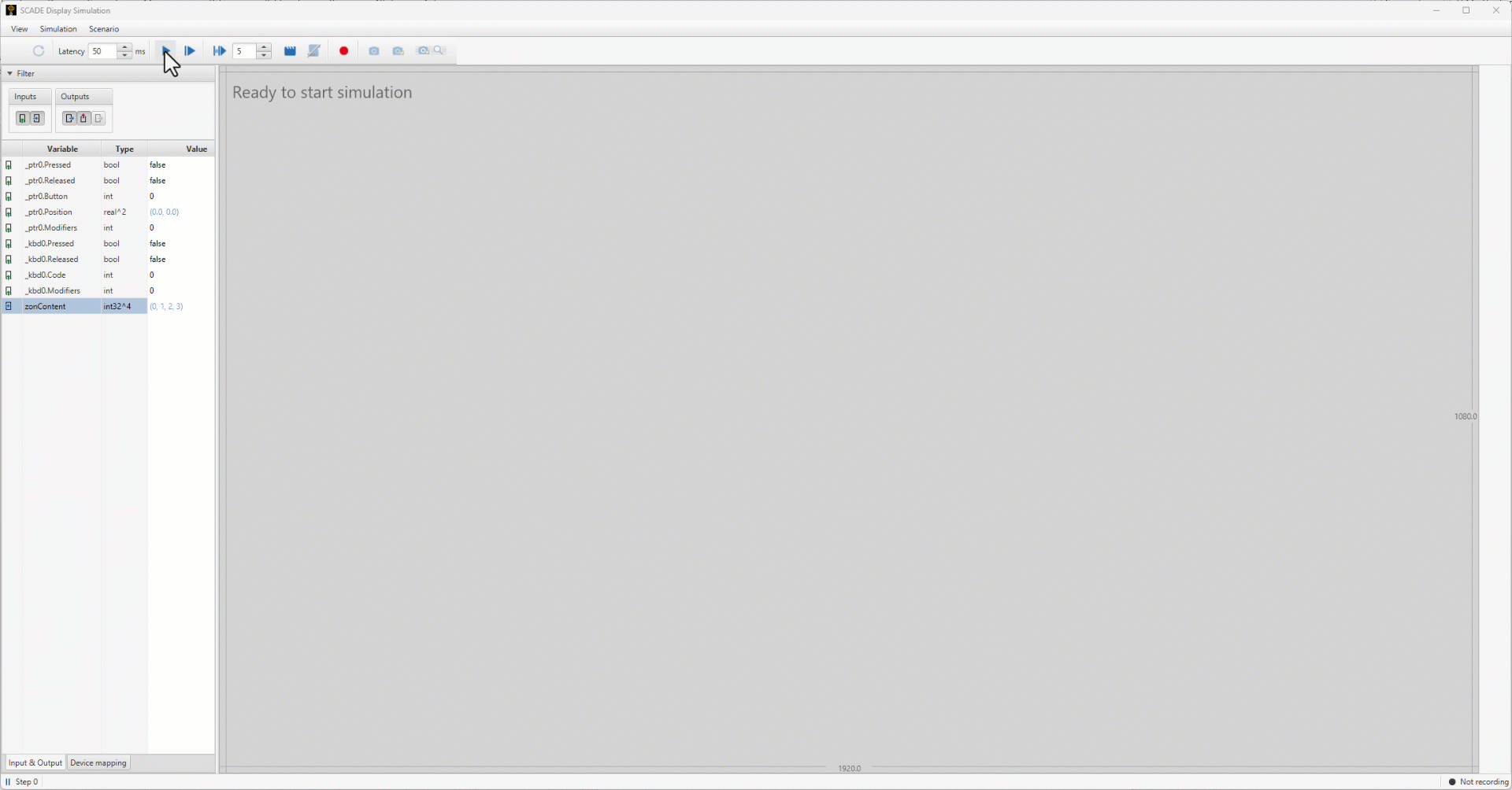

Now, let’s simulate the model and play around with the
zoneContentvariable:Fantastic! We now have the core functionality we wanted to implement. Let’s move on to the next step: adding some interactivity using SCADE Suite logic, allowing us to select two zones we’d like to swap.

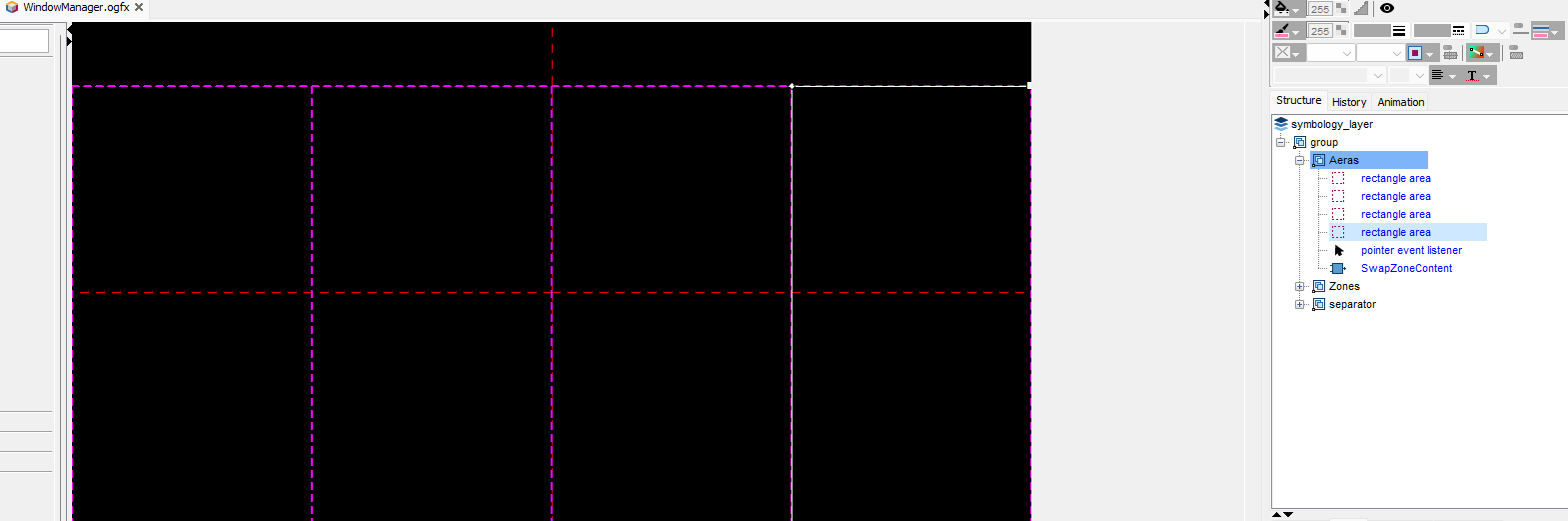

On the SCADE Display reference object side, there’s not much left to do: we’ll just need to add a pointer event listener and define active areas for each zone, allowing us to identify which zone has been clicked/touched by the user at runtime:

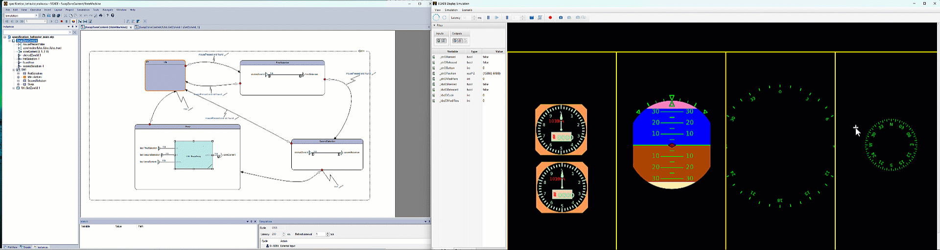

The swap algorithm is managed by a state machine with 4 states:
- Idle
- FirstSelection
- SecondSelection
- Swap
Full state machine (click to enlarge)SCADE Display co-simulation

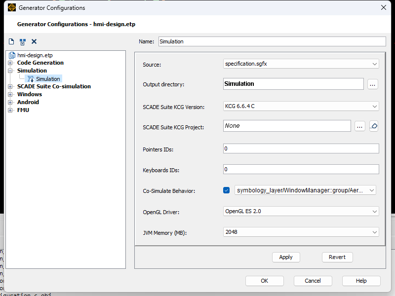

To validate the behavior of our HMI, SCADE Display allows for co-simulation with the behavior model. This makes it easy to quickly test and debug our setup. Here are the settings :
With the logic in place, we can now select two zones and successfully swap their content:
