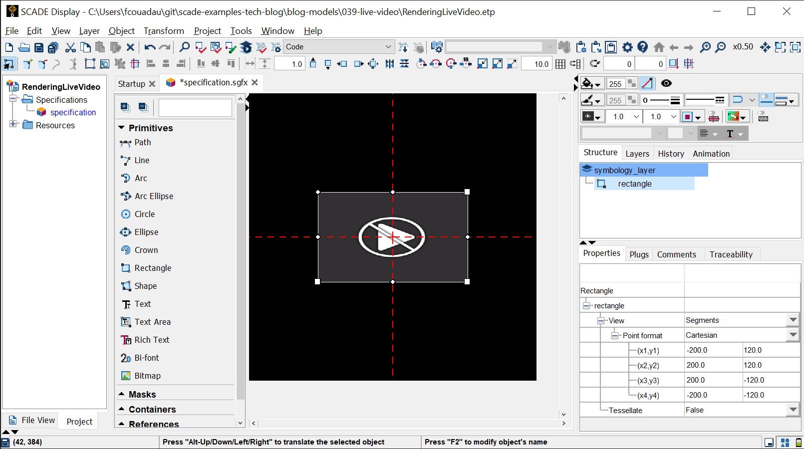

SCADE Display reference object creation
First, we create a SCADE Display model with a graphical specification. In it, we design a rectangle that will serve as the video output screen. This rectangle will continuously update with new textures, which correspond to the frames of the video stream. We assign an OpenGL texture ID to it, which will be updated at runtime.

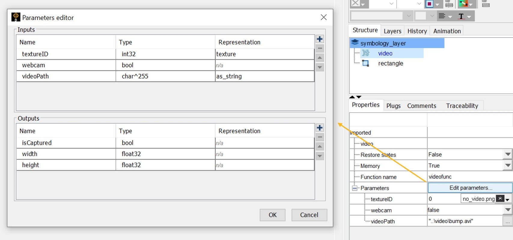

Next, we add an Imported Code Block. This non-graphical widget invokes an external, user-defined C function. This function will integrate OpenCV for capturing video frames, handle video decoding and transfer frame data to the OpenGL texture. SCADE Display will call this function on every frame update, ensuring that the texture is continuously refreshed with new video data.
In this case, we want to display video from a local AVI file. We place it in the same folder as our SCADE Display model, under
video/bump.avi. We then configure our Imported Code widget as follows:Note that the path of the video file is relative to our imported C function. In this case, we must add a
..at the beginning of it to go back up to our root folder level.Imported code explanation

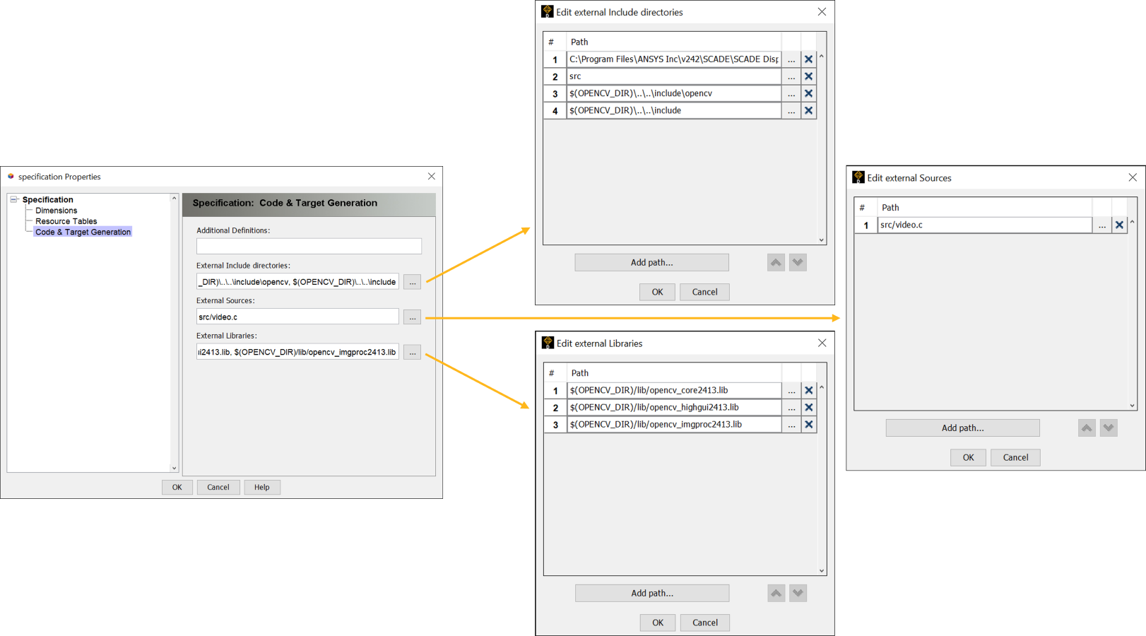

To compile and run this program, we install OpenCV 2.4.13, downloading it from the OpenCV website.
We then set up the required environment variables to add OpenCV to our Windows
PATH:%OPENCV_DIR%=c:\opencv\build\x64\vc14 %PATH%=%OPENCV_DIR%\bin;%PATH%
Next, we update the properties of our SCADE Display specification as follows:

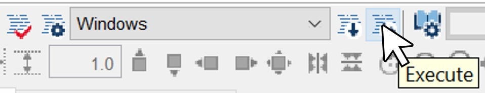

Finally, we restart SCADE Display for our new environment variables to be registered, select the "Windows" launch configuration of our model, and click Execute. SCADE Display generates, compiles, builds and runs the application:
And voila! Our graphical panel executes and we see our video looping:
