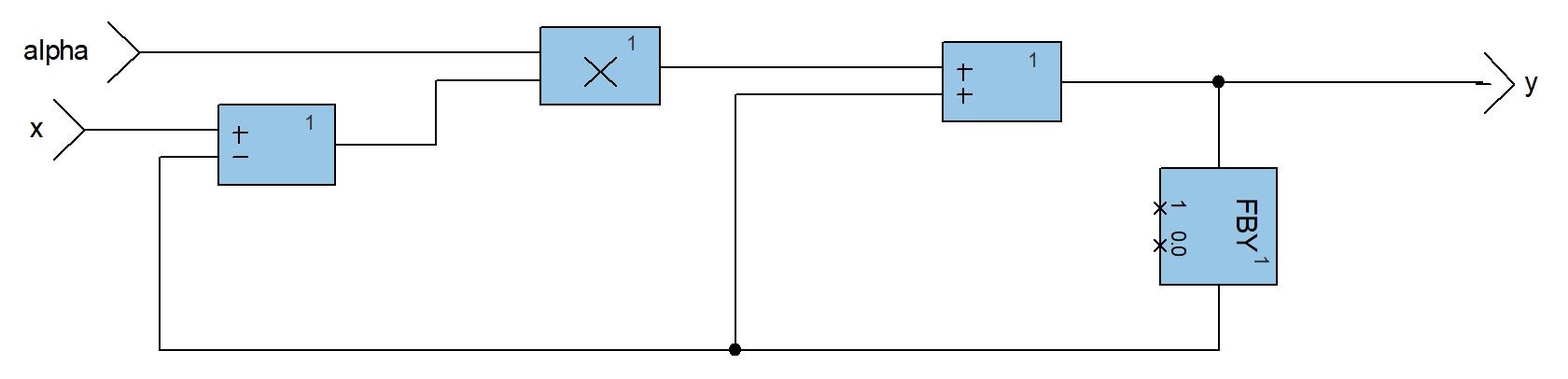

      Implementing a first order low pass filter in SCADE is quite simple and would give the following diagram:
      Low Pass filter in SCADE
      Note the use of the FBY operator, which allows us to reference the value of y from previous cycles ($y[i-1]$ in our equation above).

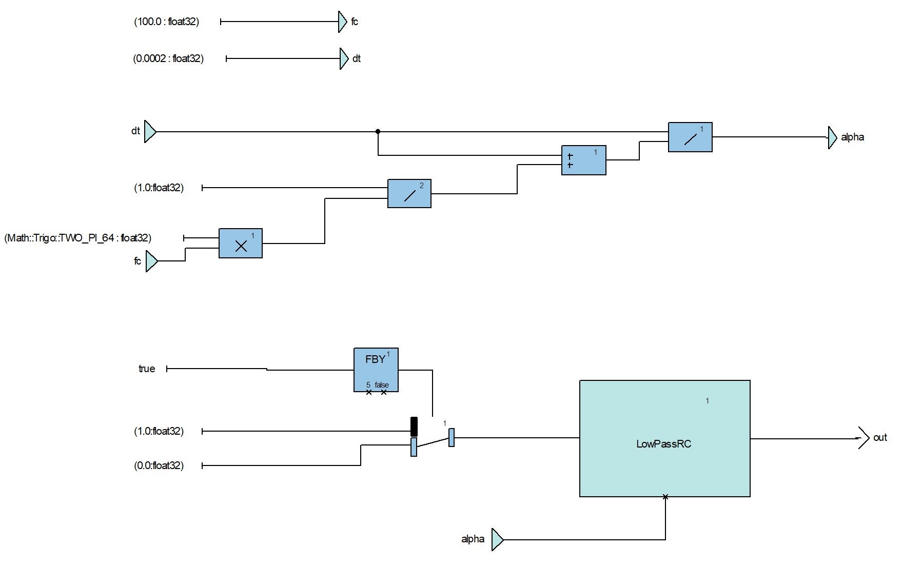

      We design a test harness in SCADE to generate the step signal:
      Step harness
      Note that we could also use a test scenario that leverages files of pre-calculated input values and expected output values.

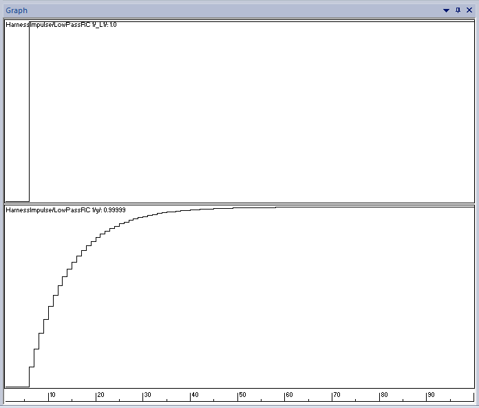

      This test harness is executed in the SCADE simulator. We can observe the response values on simple graphs:
      Step response in SCADE

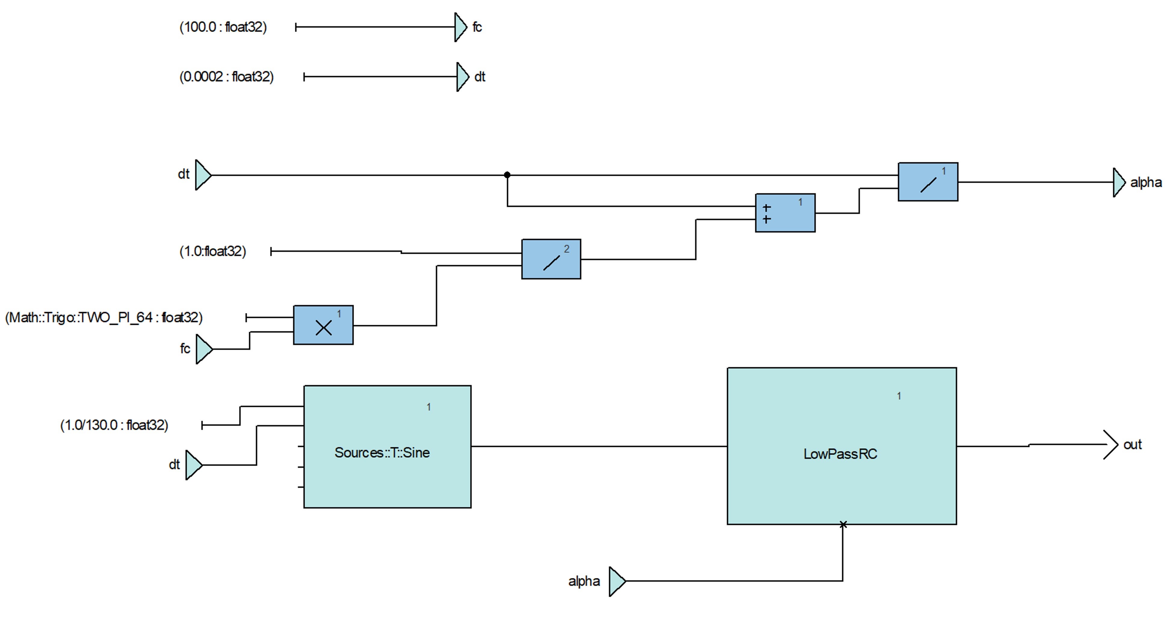

      We create a new test harness to generate a sine wave signal:
      Sine wave signal harness

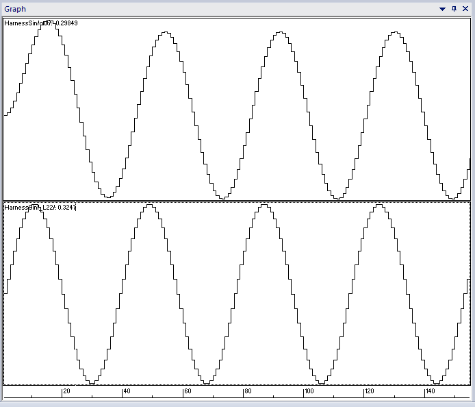

      Using the simulator, we can plot the input and output signals:
      Sine wave signal and filtered signal
      This gives us a first view of our filter’s output. However, SCADE is a software development tool and is not suited for more detailed signal analysis. We need a different set of tools to verify the frequency response of our filter.

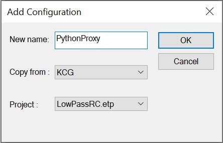

      We start by creating a new code generation configuration under Project > Configurations:

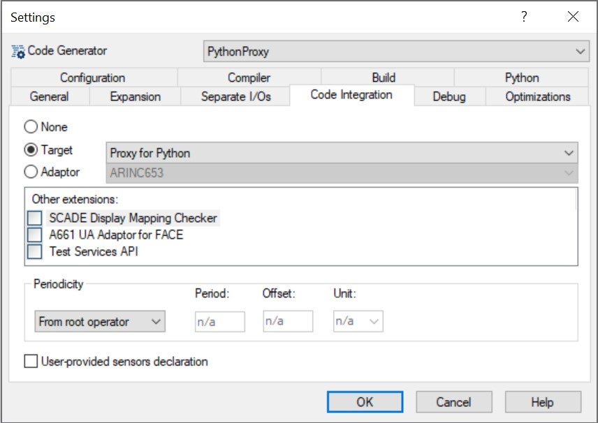

      Then, in Project > Code Generator > Settings > Code Integration, we select Proxy for Python as a Target:

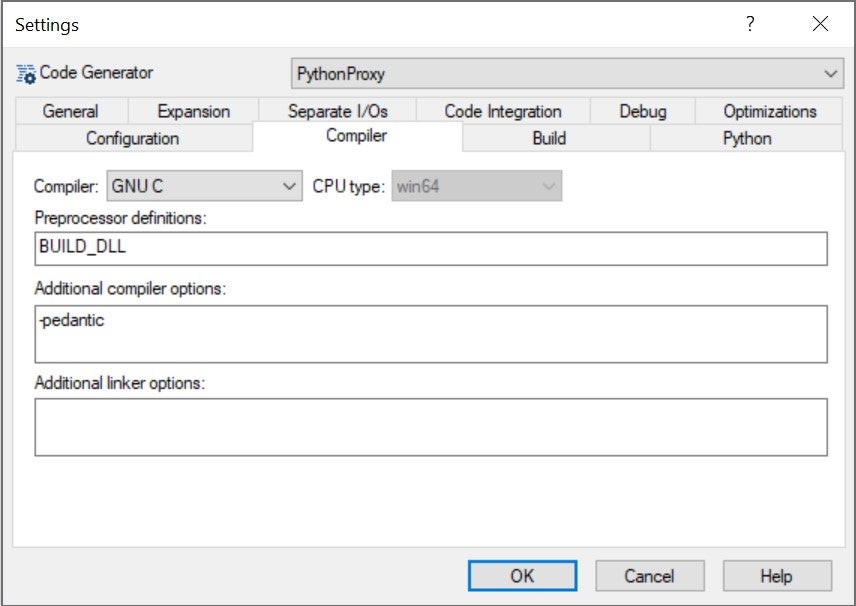

      We select, in tab Compiler, the proper options for our target environment:

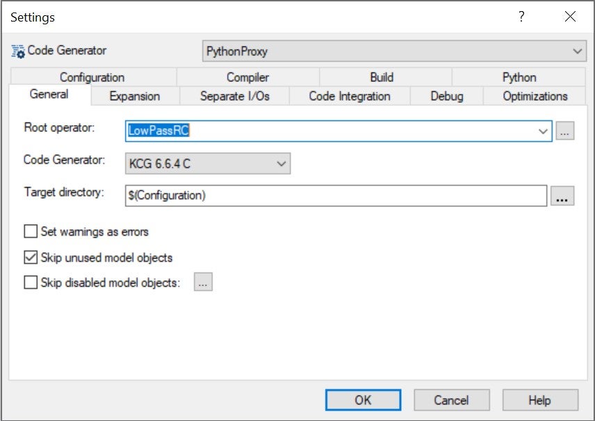

      In tab General, we check that the proper root operator is selected:

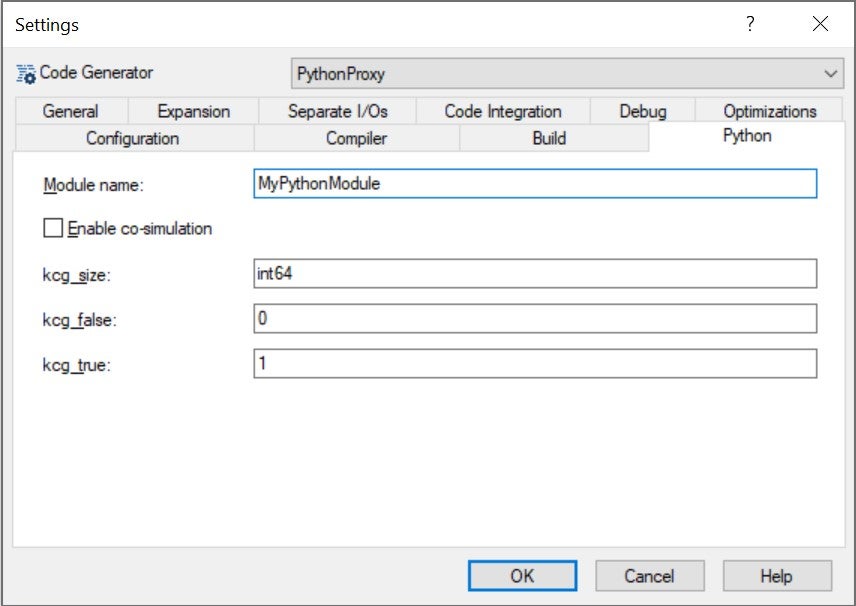

      Finally, in tab Python, we choose a module name:
      We now generate and build the module, which ends up in the target directory (as previously defined in code generator options). Two important files are generated: MyPythonModule.py and MyPythonModule.dll.
