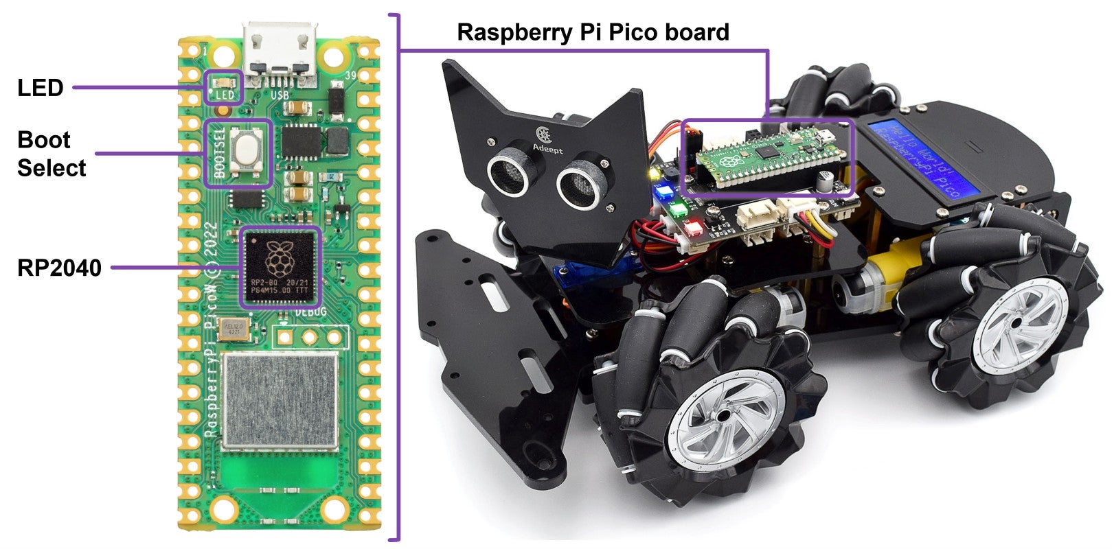

What is the Raspberry Pi Pico?
The Raspberry Pi Pico is a low-cost microcontroller board designed for embedded systems development and education. It is based on the RP2040 microcontroller, which features:
- Dual-core ARM Cortex-M0+ processors
- Up to 133 MHz clock frequency
- 264 KB SRAM
- Flexible peripherals including GPIO, PWM, SPI, I2C, UART, and timers
The Pico is widely used in robotics, control systems, and educational projects because it offers a powerful microcontroller with a simple development workflow. The official SDK allows developers to program the device in C or C++, and firmware is typically flashed using a .uf2 file copied directly to the device via USB.

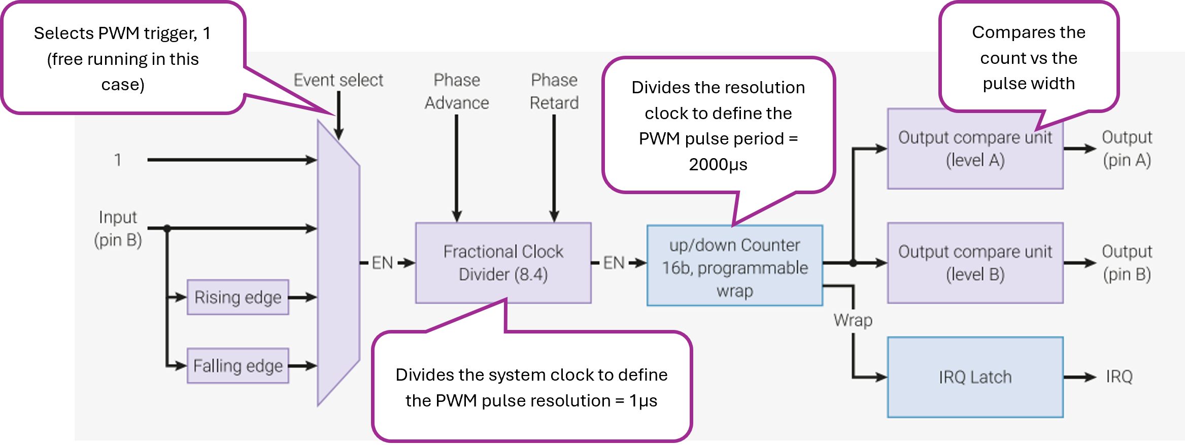

PWM Architecture in the RP2040
The RP2040 microcontroller implements PWM using independent PWM slices.
To generate a 50 Hz signal:
- The system clock (125 MHz) is divided
- A counter increments at the resulting clock rate
- When the counter reaches the wrap value, it resets
In this project:
- Clock divider = 125
- Effective PWM tick = 1 MHz (1 µs resolution)
- Wrap value = 19999
This produces: 1 MHz / 20000 counts = 50 Hz
Because each PWM tick represents 1 µs, the PWM duty cycle can be set directly using microsecond values. In this way:
- The hardware generates the PWM signal automatically every 20 ms, with width resolution of 1 µs

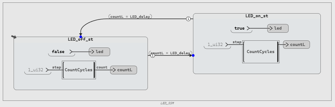

LED control
The
LED_SSMstate-machine with two states (LED_off_standLED_on_st) toggles the led output between false and true. In each state, aCountCyclescounter increments every cycle. WhencountL=LED_delay, the machine transitions to the other state, producing a periodic LED blink.Head control

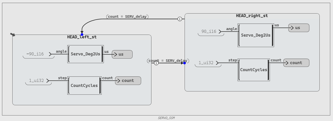

The
SERVO_SSMstate machine with two states (HEAD_left_standHEAD_right_st) alternates the servo angle between −90° and +90°. In each state,Servo_Deg2Usconverts the fixed angle to a PWM value (us), while aCountCyclescounter increments; whencount=SERV_delay, the machine transitions to the other state, producing periodic left-right motion.Simulation

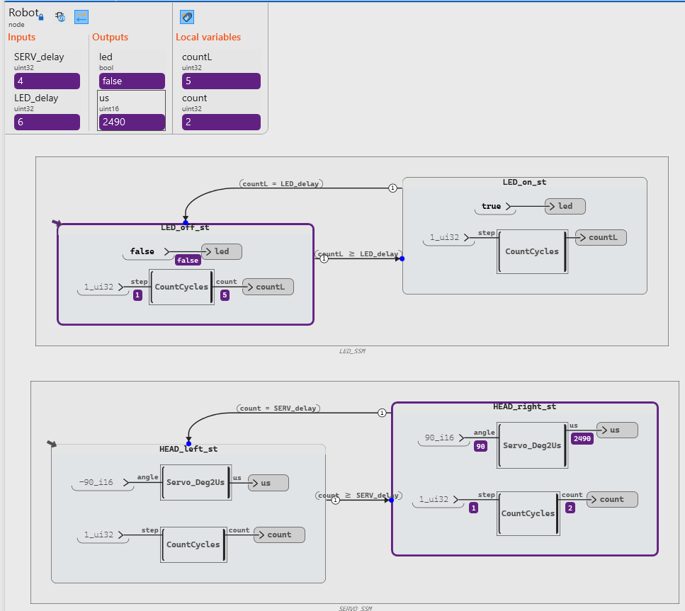

Live debug of the Robot operator in Scade One. Active state machine states are highlighted.Before deployment, it is better to analyze the behavior of the model. To do this, we launch our model in debug mode on a host laptop.
The simulation was launched and executed several steps; at this point the LED is OFF and waiting for its counter to reach 6 before switching ON. The servo is positioned to the right (+90°) and is waiting for its counter to reach 4 before switching to the left position.
