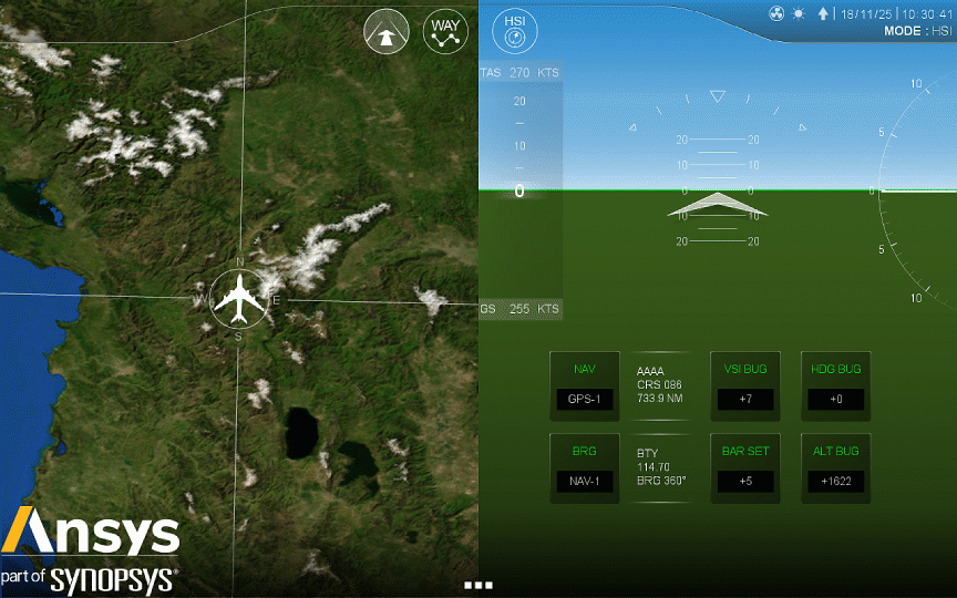

SolutionParticipantModern avionics applications increasingly rely on gesture‑based interactions: zooming into a map, rotating a tactical display, or adjusting range rings with intuitive two‑finger motions. To support these HMI paradigms, Ansys SCADE supports gesture-based controls. We illustrate these in our scade-example-multi-touch-cockpit model.
The application supports advanced multi-touch gestures for intuitive interaction:
- Swipe: Navigate between pages with a swipe gesture.
- Pinch-to-Zoom: Adjust the zoom level of the map using pinch gestures.
- Rotate: Rotate the map for customized views.
All gesture logic is implemented in deterministic state machines and mathematical operators inside Ansys SCADE Suite.
In this article, we’ll dive into it and explain how the logic for various gestures is implemented in the public example model.
But first, let’s look at all three gestures in action:
