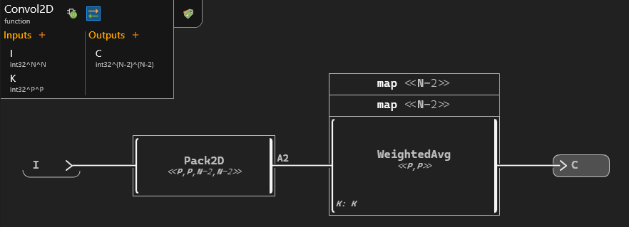

Implementing a convolution on a matrix
Let’s start by looking at a convolution algorithm. We have already shown in a previous blog how to implement convolution in Swan using nested forward iterations (the new loop-like construct introduced in Swan). Here, we will use an alternative way that only makes sense in a declarative language like Swan and is very different from an imperative implementation.
In this example, the
Convol2Doperator takes as input a square matrixI(of size N by N) and returns a matrixC(of size (N-2) by (N-2)), where each element is obtained by doing a weighted average of the neighbors using the coefficients in matrixK.This is done by using the
Pack2Doperator to create an intermediate matrix (of size (N-2) by (N-2)), where each element is the matrix of the neighbors in the input matrix I. Then, we just iterate on this matrix and apply theWeightedAvgoperator on each sub-matrix. It may seem counter-intuitive to compute this huge intermediate matrix (of typeint32^P^P^(N-2)^(N-2)!). It works because this matrix is never actually created in the generated code. The code generator transforms the iteration on this intermediate matrix into an iteration on the input matrix I, with the necessary index adaptations:/* Convol2D::Convol2D_8 */ void Convol2D_8_Convol2D( /* I */ const array_int32_8_8 *I, /* K */ const array_int32_3_3 *K, /* C */array_int32_6_6 * restrict C) { swan_size i1; swan_size j1; swan_size k1; swan_size i11; for (i1 = 0; i1 < 6; i1++) { for (j1 = 0; j1 < 6; j1++) { (*C)[i1][j1] = swan_lit_int32(0); for (k1 = 0; k1 < 3; k1++) { for (i11 = 0; i11 < 3; i11++) { (*C)[i1][j1] = (*C)[i1][j1] + (*I)[k1 + i1][i11 + j1] * (*K)[k1][i11]; } } } } }
Another advantage of this approach is that the
Pack2Doperator can be used as a library operator, without having to know how it’s implemented (using a non-trivial combination ofpackandtranspose). But, in the end, the code generated from this high-level description is as efficient as a direct implementation using nested for loops in C.Did you know? If you want to learn more about Swan, you can look at the examples provided with Scade One. The corresponding user documentation is available for free, without any registration, on the Ansys Help website.

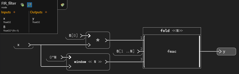

The temporal
windowoperator is also a perfect fit for implementing digital filters. Let us first consider a Finite Impulse Response (FIR) digital filter, defined by:$$y=\sum_{k=0}^{N}{B\left[k\right]\cdot x_{n-k}}$$
Since
windowgives access to the N past values of a flow (in this formula $x_{n-1}, \ldots, x_{n-N}$) but not to the current one ($x_{n}$), we put the term $B\left[0\right]\cdot x_{n}$ out of the sum to isolate what can be computed as an iteration on the window :$$y=B\left[0\right]\cdot x_n+\sum_{k=1}^{N}{B\left[k\right]\cdot x_{n-k}}$$
Supposing the filter initializes with zero, the formula above can be expressed as:
Note that this implementation is parametrized by the size N of the input array; this is an improvement over the Scade 6 language, where it was not possible to create such a generic implementation using only the
fbyoperator. The code generated in this example is again very efficient:/* Filters::FIR_filter */ void FIR_filter_Filters( /* x */swan_float32 x, /* B */ const array_float32_4 *B, /* y */swan_float32 * restrict y, outC_FIR_filter_Filters * restrict outC) { swan_size i1; *y = (*B)[0] * x; for (i1 = 0; i1 < 3; i1++) { *y = *y + (*B)[i1 + 1] * outC->window.items[(- i1 + (outC->window.idx + 2)) % 3]; } outC->window.items[outC->window.idx] = x; outC->window.idx = (outC->window.idx + 1) % 3; }
