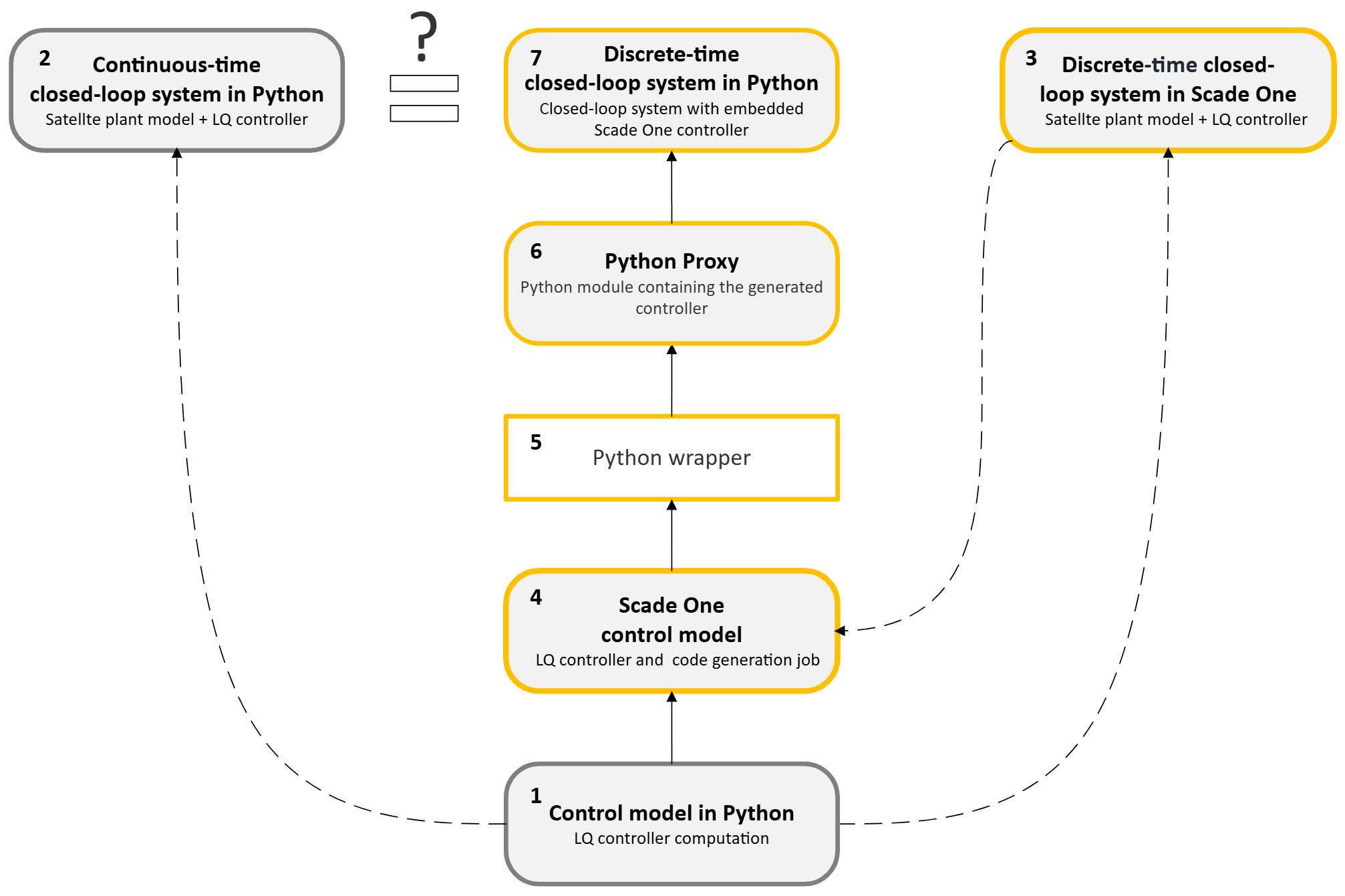

      Controller integration workflow
      The purpose of the article is to demonstrate a complete integration workflow: from controller synthesis in Python to executable model design in Scade One, and back to Python for system-level validation (see Figure 1). The behavior of the generated controller code (and, consequently, of the Python proxy) is identical to that of the initial control model designed in Python. Validation is performed through comparison between the satellite system with embedded Scade One controller and a pure Python implementation.
      The integration workflow consists of the following steps:
      • Compute the LQ controller gain in Python for a linearized satellite model.
      • Simulate the continuous-time satellite system (plant model + LQ controller) in Python.
      • Design and validate the corresponding discrete-time satellite system (plant model + LQ controller) in Scade One.
      • Generate code for the controller in Scade One.
      • Wrap the generated code into a Python proxy using the Python wrapper.
      • Integrate the Python proxy (Scade One controller) with a discretized satellite plant model within a Python script, for discrete-time simulation.
      • Compare simulation results between the satellite system with embedded Scade One controller and the pure Python implementation.
      Figure 1: Scade One controller integration workflow

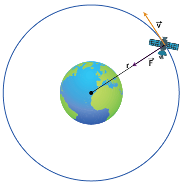

      In a simplified scenario, a satellite in orbit ideally follows a stable trajectory defined by gravitational forces (see Figure 2), and the Earth is the only influencing body and the orbit remains constant.
      Figure 2: Satellite moving on a circular orbit around the Earth

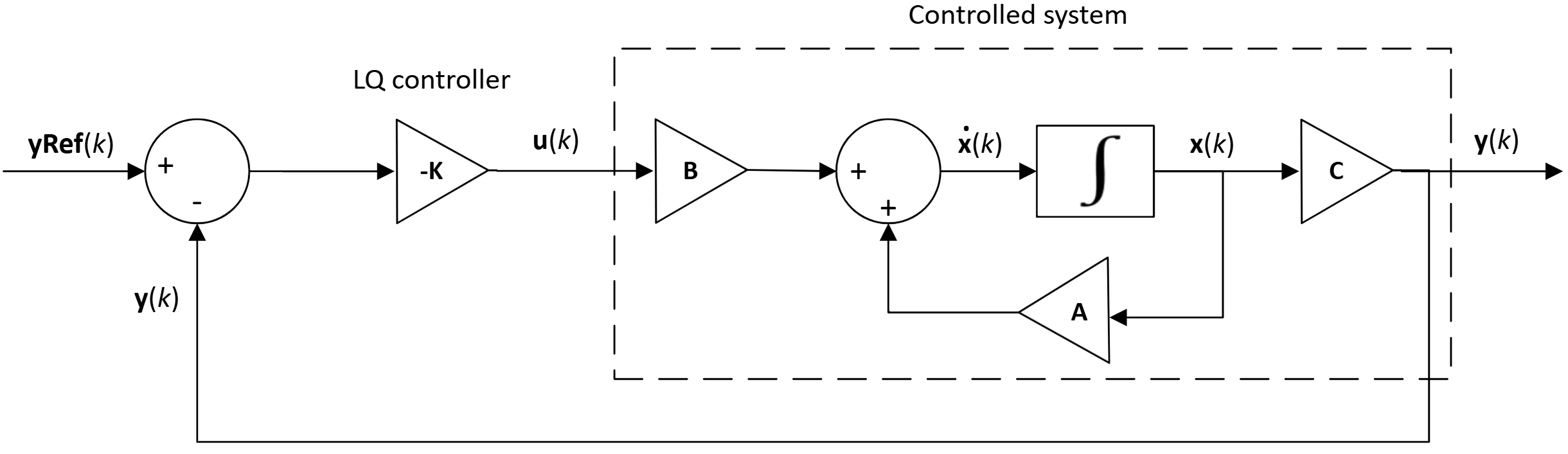

      The diagram from Figure 3 represents a linearized satellite model in combination with the LQ controller, in discrete-time domain, with an approximation of integrator:
      Figure 3: Linearized satellite model in combination with the LQ controller in discrete-time domain

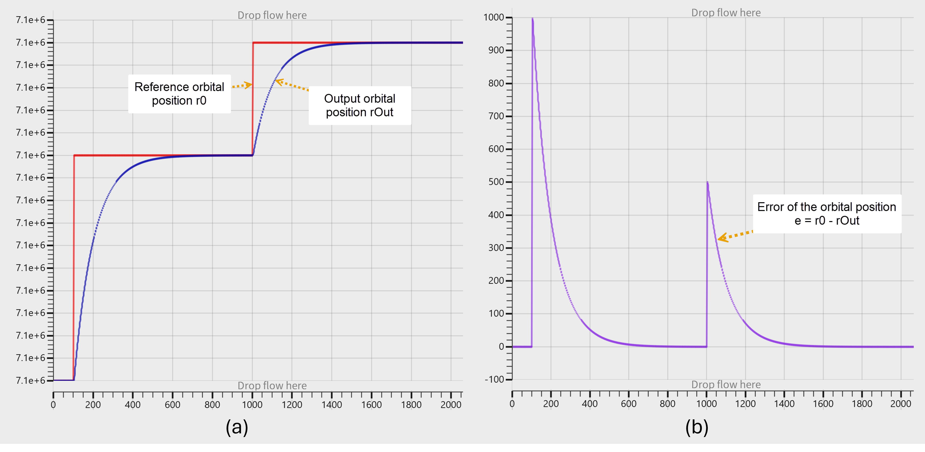

      The simulation traces (see Figure 4) show an error of the satellite position tracking: at execution step 2000 its steady state value is equal to -0.141 m. This is expected: the LQ controller does not include integral action, meaning it cannot completely eliminate constant disturbances. Despite this, the error remains very small (below 0.001%), demonstrating the effectiveness of the controller.
      Figure 4: Reference and output satellite orbital position (a) and error of the satellite orbital position (b), (continuous-time simulation in Python)

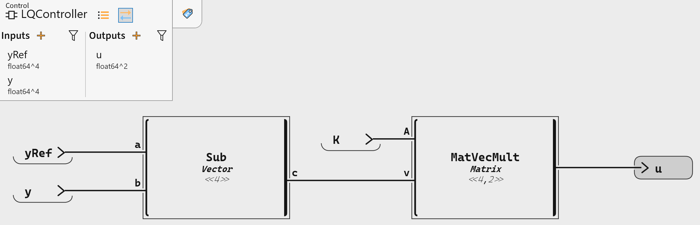

      Scade One provides a substantial collection of standard libraries, covering a wide spectrum of typical use cases. Rather than reimplementing existing functionality, you are encouraged to leverage these components whenever possible, to benefit from proven, reusable, and standardized solutions.
      Numerous vector and matrix computations are provided by the Vector and Matrix libraries included in the Scade One installation. Some of them are presented in the article Matrix operators using Scade One’s forward block. These operators are mostly based on the forward and map constructs, allowing iterations over arrays. All operators in the Vector and Matrix libraries are polymorphic, meaning that they can support any numeric type. The operators listed below are part of the satellite model:
      • Scale from Vector library – vector-scalar multiplication
      • Add and Sub from Vector library – vector addition and subtraction
      • MatVectMult from Matrix library – matrix-vector multiplication
      The implementation of the LQ controller is shown in Figure 5. It computes the difference (or error) between the reference satellite orbit parameters yRef and the model output parameters y, and multiplies this difference by the LQ matrix K.
      Figure 5: LQ controller

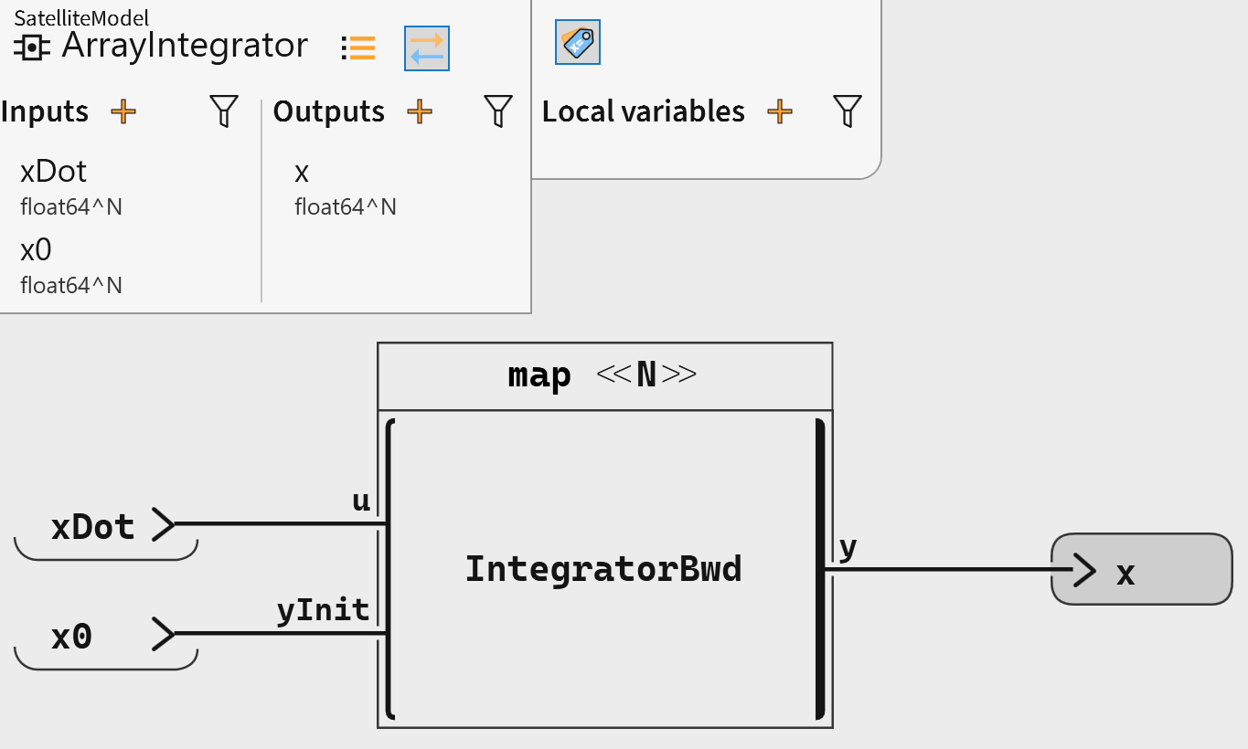

      Integral of an array
      In the Satellite model, you need to compute an integral of four independent states (flows) that will vary with time, $y=x(t)={\left[x_{1},x_{2},x_{3},x_{4}\right]}^{T}={[r,\ \theta ,\ \dot{r},\ \dot{\theta }]}^{T}$.
      To compute an array integral, the map iterator is combined with a nested integrator, see Figure 6:
      Figure 6: Integral of an array using map operator
      The constant N is defined as follows: ‘const N: int32 = 4‘. The map construct allows to process the array elements independently computing an integral for each flow (IntegratorBwd is replicated N=4 times in parallel).

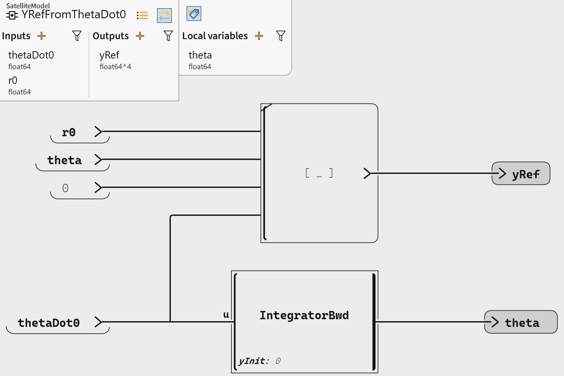

      Computation of the reference satellite parameters with array constructor
      The reference input array in the satellite model (see Figure 4) is given by the following expression: $yRef={[r_{0},\ \theta ,\ 0,\ {\dot{\theta }}_{0}]}^{T}$, where
      • The constant orbital position $r_{0}$ is considered, thus the radial velocity $\dot{r}$ is zero.
      • The satellite angular position $\theta$ is defined by the equation $\theta =\int_{0}^{DT(k-1)} \dot{\theta }\ dt$.
      To compute the discrete-time integral of the angular speed $\dot{\theta}$, you can use the backward Euler integrator approximation:
      const DT: float64 = 0.01;
      node IntegratorBwd (u: float64; yInit: float64)
      returns (y: float64)
          let y = (yInit pre y) + DT * u;
      $$y\left(k\right)=y\left(k-1\right)+DT\ast u\left(k\right)$$

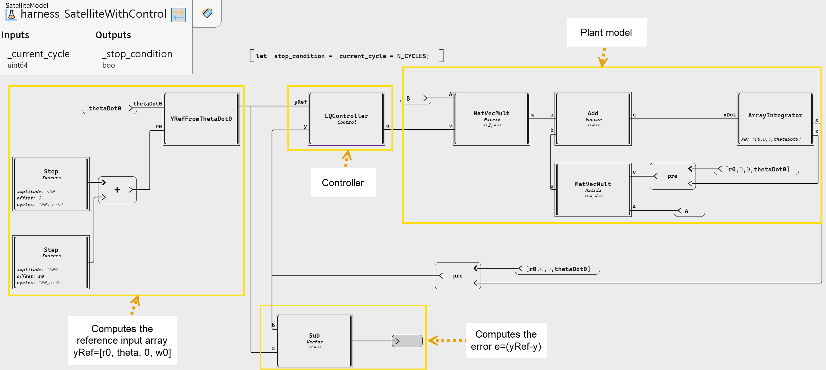

      The reference input array yRef can be designed in Scade One as follows (see Figure 7):
      Figure 7: Computation of the reference satellite parameters yRef from the constant angular speed ${\dot{\boldsymbol{\theta }}}_{0}$
      The array constructor operator ‘[ _ ]‘ allows to create the yRef array from constant orbital position $r_{0}$, constant angular speed ${\dot{\theta }}_{0}$, and computed angular position $\theta$.
      Closed-loop satellite System with LQ controller
      The implementation of the full closed-loop system (a test harness) from Figure 3 in Scade One is shown in Figure 8:
      Figure 8: Implementation of the satellite control system with LQ controller in Scade One
      To properly initialize the model in Figure 4, the following initial parameters of the satellite orbit are used: ‘[r0, 0, 0, thetaDot0]‘, where:
      const r0: float64 = 7100000;
      const thetaDot0: float64 = 0.0010553;
      Compared to the theoretical diagram in Figure 3, this model introduces two additional operators pre in the feedback loops. The pre operator denotes a unit delay.

      The simulations results for sampling period DT = 0.01 and 2000 cycles are shown in Figure 9:
      Figure 9: Reference and output satellite orbital position (a) and error of the satellite orbital position (b) (discrete-time simulation in Scade One)
      The simulation reveals a small steady-state error, at execution step 2000 it is equal to -0.161.

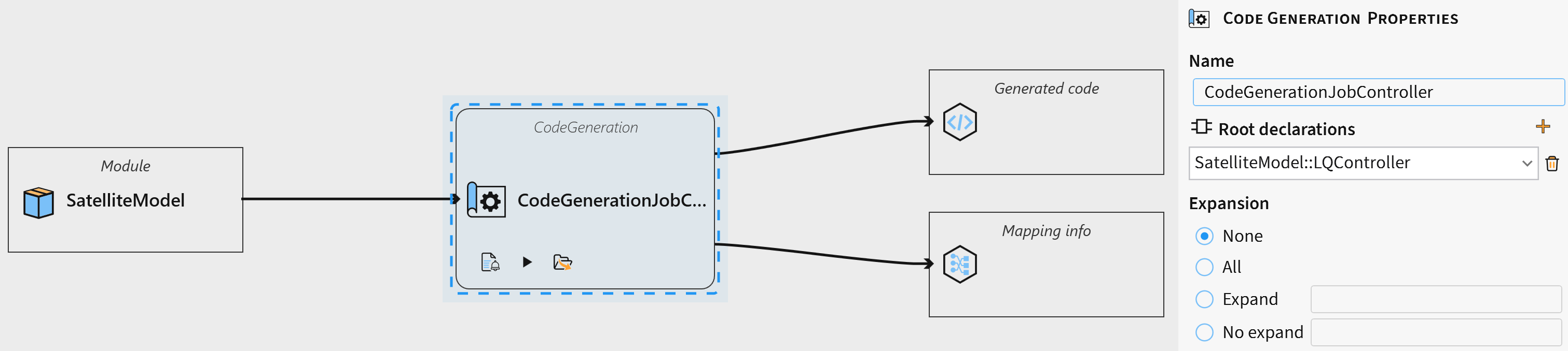

      Code generation in Scade One
      Now, you can create in Scade One a code generation job for the satellite control model (LQ controller). Set the job name as CodeGenerationJobController, select the LQ controller as root operator in the job properties and launch the job (optionally), see Figure 10.
      Figure 10: Code generation job for LQ controller
      Integration and validation of the Scade One controller in Python
      The controller code generated by Scade One is wrapped into a Python proxy using the provided Python wrapper service. This proxy is then integrated into a discrete-time simulation of the satellite plant in Python.
      Python wrapper and Python proxy
      First we’ll create a Python proxy for the Scade One controller, using the Python wrapper service (the link for the complete script is in **Next Steps):
      gen = PythonWrapper(project=prj, job=job_name, output=out_name, target_dir=target_dir)
      gen.generate()
      Once the script has been executed, a generated folder is available in the current location containing the wrapped code. Two important files are generated in the target folder: satellite_control_wrapper.dll and satellite_control_wrapper.py.
      The satellite_control_wrapper.py file uses ctypes to wrap the controller operator in a class that exposes its inputs (y and yRef), its output (u), and functions to run it.
      The next step is to import the generated Python proxy and integrate it into the satellite control system in Python:
      from satellite_control_wrapper import satellite_control_wrapper
      # Create an instance of a controller main operator
      satellite_controller = satellite_control_wrapper.LQController_Control()

      The simulation results of the closed-loop system with the imported Scade One controller are shown in Figure 11:
      Figure 11: Reference and output satellite orbital position (a) and error of the satellite orbital position (b) in Python
      The steady-state (or static) error of the satellite position at execution step 2000 is equal to -0.141.
