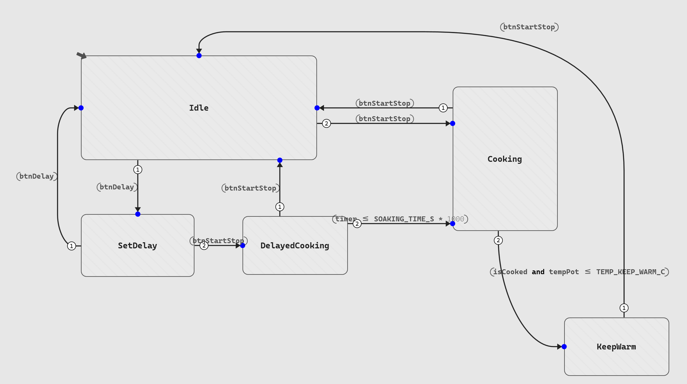

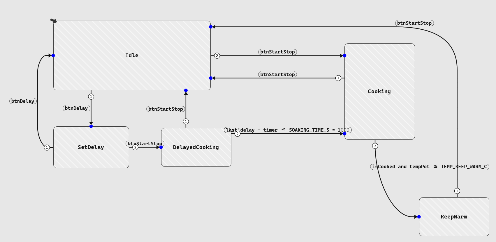

At the top level, the controller is organized into five states:
Idle: wait for inputSetDelay: let the user configure the delayed startDelayedCooking: count down to the start timeCooking: handle the actual cooking sequenceKeepWarm: maintain the serving temperature after cooking completion
Figure 1: High-Level controller statesThis highlights one practical strength of Scade One and model-based software development in general: instead of having a long sequence of conditional blocks, the operating modes are very explicit and easy to check in simulation.

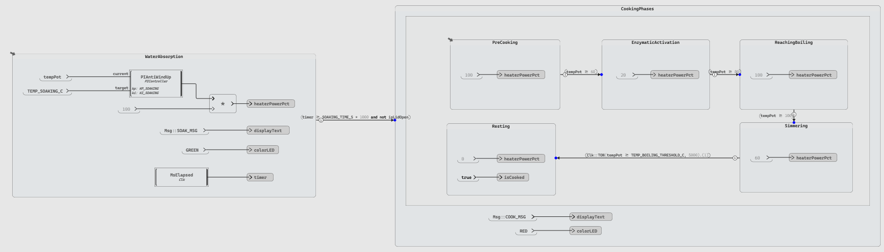

Cookingmode is the most interesting part of the model. It is itself split into several phases that match different steps for improving the taste of the cooked rice:WaterAbsorption: keeping the rice warm for some time to hydrate each grain of rice, resulting in fluffy and tender ricePreCooking: heating up to reach the next phaseEnzymaticActivation: slowing cooking between 60°C and 80°C to enhance nutrition, texture, and flavor by activating dormant enzymesReachingBoiling: reaching 100°C as fast as possibleSimmering: slow boiling until all water has evaporatedResting: letting the steam finish cooking the rice slowly and evaporating remaining moisture
Figure 2: Cooking phases inside the main cooking stateThis state machine shows where Scade One becomes particularly useful: state machines capture the sequencing while data flow logic computes timers, thresholds, and power commands within each phase. On top of that, nested state machines with the possibility to hide state content (i.e. detached diagrams) give the possibility to have a clear hierarchy of the sequencing.
Moreover, we can easily implement the closed-loop temperature control for the two phases requiring it:
WaterAbsorption, which keeps the temperature at 45°C for a configured soaking timeKeepWarm(the next top-level state), which regulates the pot around 65°C to avoid bacteria multiplication (under 60°C) or drying out (above 80°C)

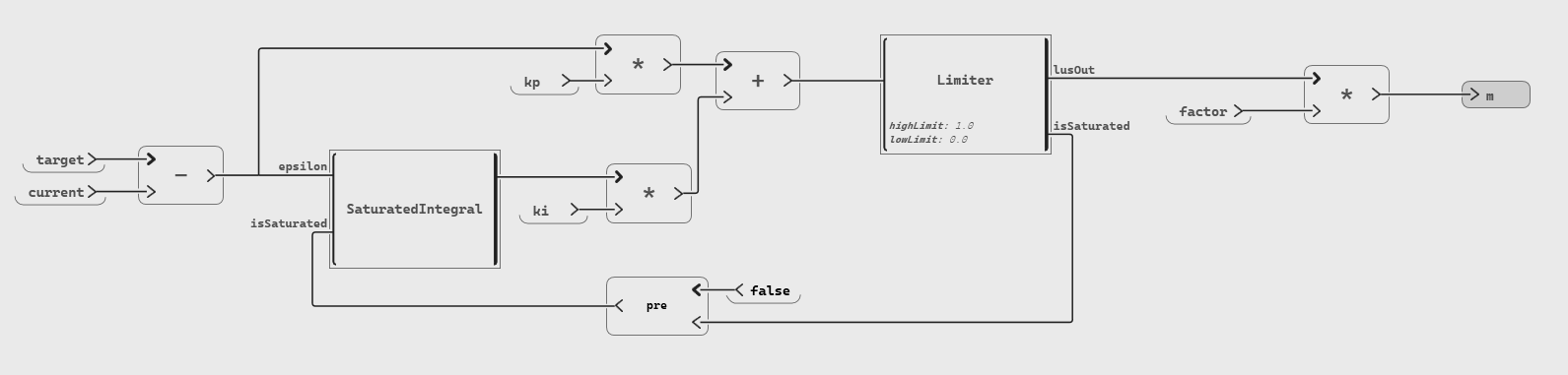

For both, a PI controller (Proportional Integral) with anti-windup is sufficient. The implementation reuses an example provided in the Scade One installation. A full PID controller would have been possible but is not needed here: the temperature changes slowly, the control objective is moderate, and the simpler design is easier to tune and explain.
Figure 3: Implementation of PI controller with anti-windup🛠️ Utility operators to make life easier

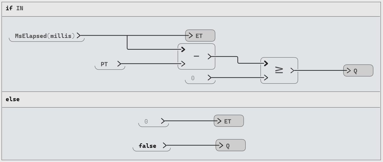

- Timer-on delay (TON): as specified in IEC 61131-3 for PLCs, validates a condition only after it remains true long enough, preventing the model from reacting to transient noise or measurement glitches
- Message formatting: helps build strings for the rice cooker screen
These utilities are the core building blocks of the application. The TON operator is especially important for the cooking-completion logic: instead of switching phases on a single temperature sample above threshold, the model waits until the condition persists long enough to be meaningful.

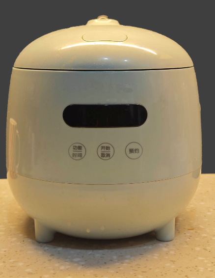

To validate the controller, particularly the change of temperature based on given input power, we need a plant model that represents the physics of the rice cooker.
Figure 5: the mini rice cooker used as our plant modelWhile plant modelling is usually done with dedicated tools, the physics here can be reduced to a set of equations simple enough to implement directly using Scade One.

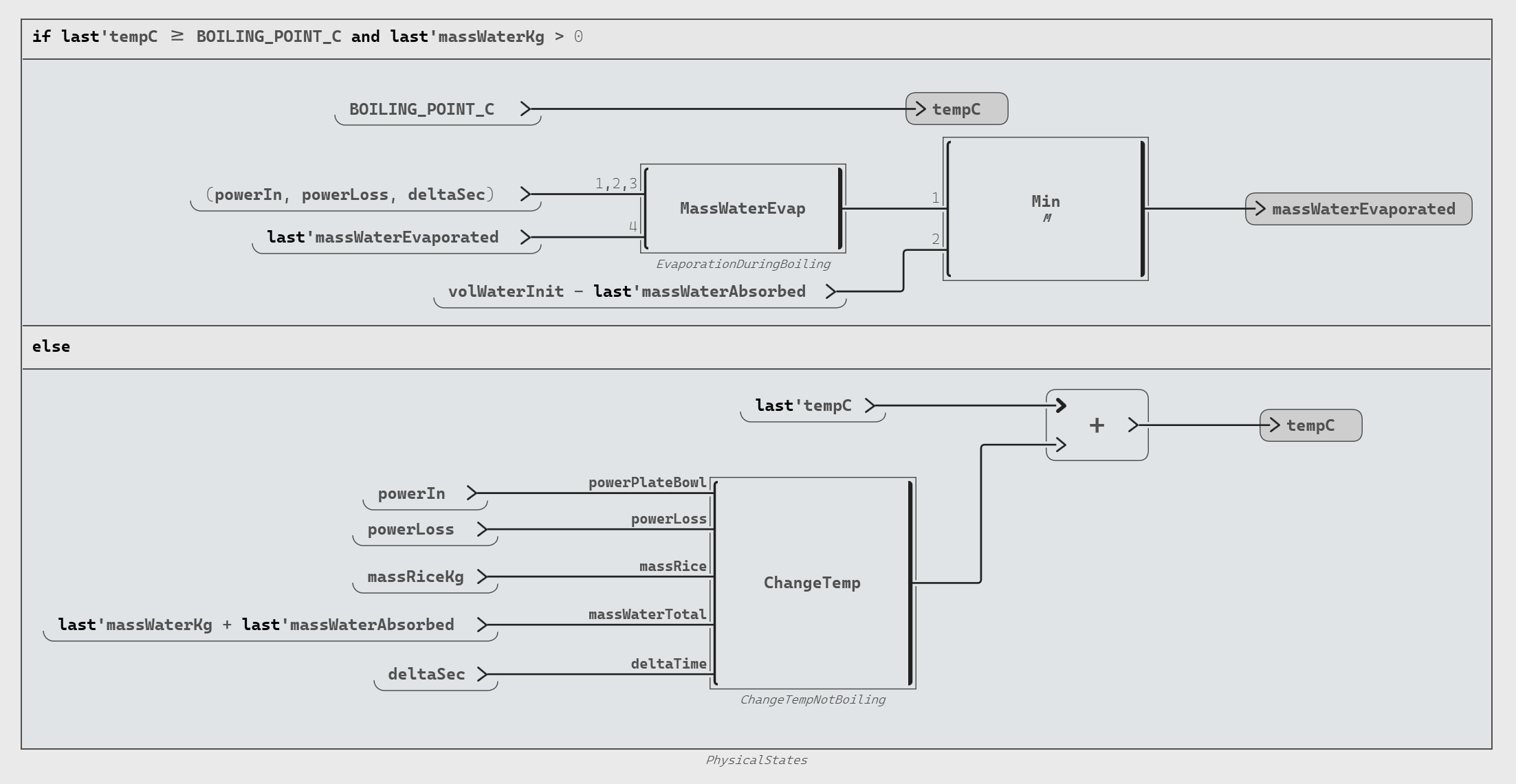

During the boiling, the mass of water that evaporates across a time $\Delta t$ due to a given input power is expressed by the energy-mass relation , $\Delta m_{w}=\frac{(P_{in}-P_{loss}) \Delta t}{L}$ with $L$ being the latent heat of vaporization for water.
During other phases, the change of temperature across time is using a linear energy balance equation depending on the total heat capacity of the system (with being given constants):
$$\Delta T = \frac{(P_{in}-P_{loss}) \Delta t}{m_{al} C_{p,al} + m_{rice,init} C_{p,rice} + m_{w,total} C_{p,w}}$$
Figure 6: The plant model distinguishes boiling and non-boiling behavior💡 TIP: Computation of the different physical characteristics (mass, volume, power, etc.) can be made clearer by using dedicated operator or being grouped with diagrams (used as named zones).

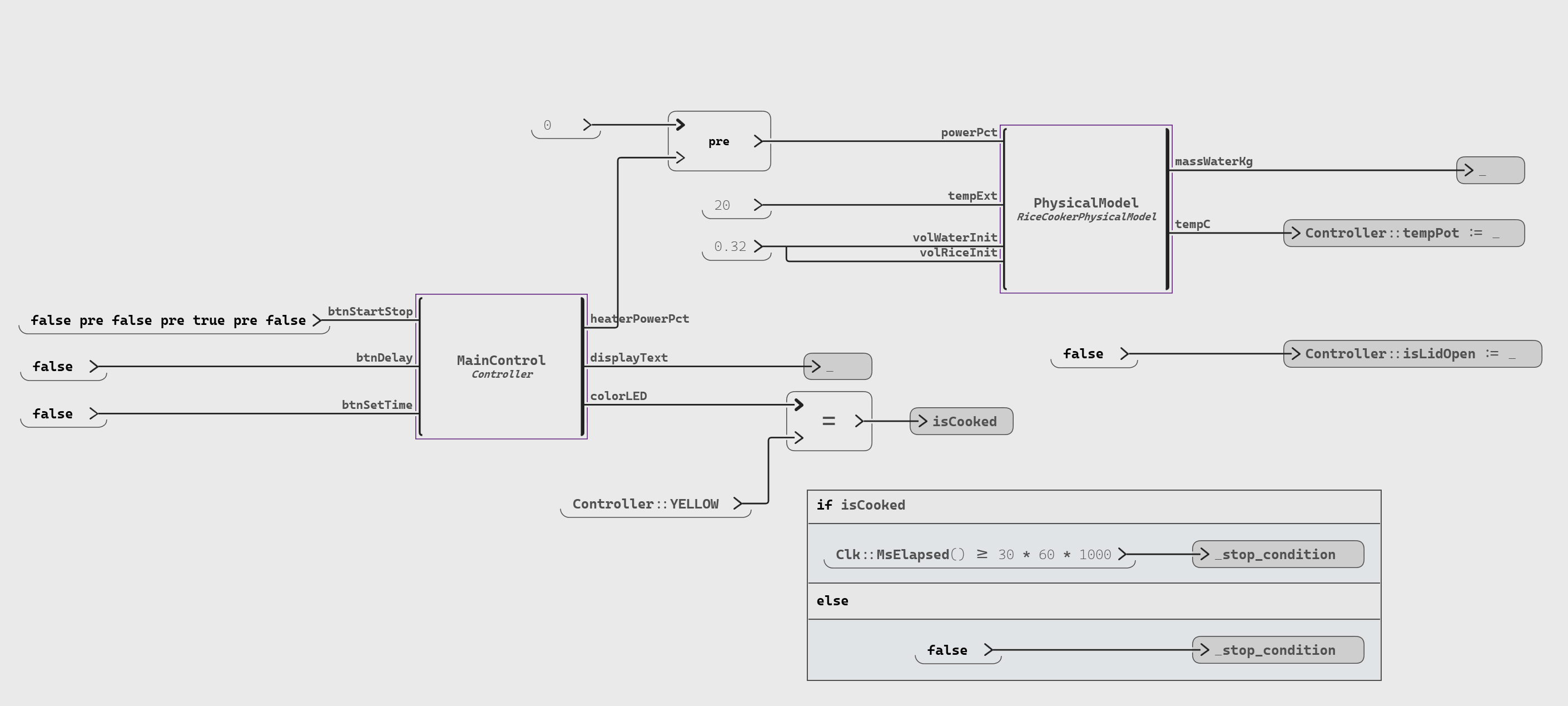

Once the controller and plant model are available, they can be connected in a test harness. The controller sends heater power to the plant model. The plant model returns the pot temperature and water-related values. Those signals then drive the next controller cycle.
We will stop the simulation 30 minutes after the rice has been cooked.
💡 TIP: The temperature of the pot and the lid sensor shall be connected to “Set Sensor” blocks (a Scade One test harness mechanism that injects values into sensor inputs).

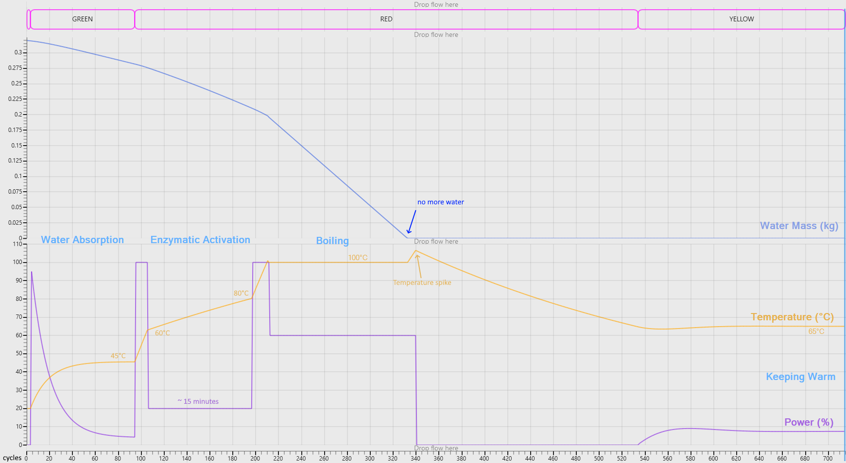

Figure 7: Controller and Plant Model connected in a test harnessThis closed-loop simulation really pays off as we can observe the whole cooking sequence and easily verify the behavior:
- Temperature ramps up in multiple phases during the heating until reaching boiling point
- At boiling point, the water decreases drastically
- Once the water is depleted, the temperature spikes
- The controller detects that spike and stops cooking
- The keep-warm PI controller stabilizes the temperature around the target
Figure 8: Simulation traces for water, temperature, and heater powerThat temperature spike is the key moment in the whole example. It shows that the controller logic is not switching phases on an arbitrary timeout alone. It reacts to a physical signature produced by the plant model.
This is exactly the sort of early validation Scade One is good at. Before deploying any embedded code, we can already check whether the control strategy makes sense, whether the thresholds are plausible, and whether the overall behavior is correct.

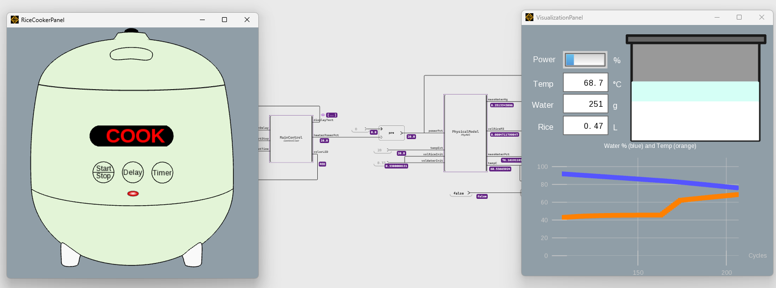

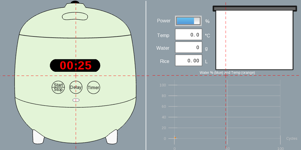

📲 Making the model interactive with graphical panels
To validate the model from a user’s perspective, we can use graphical panels created with SCADE Rapid Prototyper, a companion tool to quickly build graphical front-ends connected to Scade One:
- a front panel representing the rice cooker itself, with buttons, display, and status LED
- a monitoring panel showing values such as temperature, power, water level, and rice volume
You can find more information on building a graphical panel and integrating it with Scade One in this blog post on Ansys Innovation Space.
💡 TIP: For creating our graphical panel based on the real rice cooker, we can import the SVG file in Rapid Prototyper, potentially using GenAI tools to create that SVG.
Figure 9: Two graphical panels for user interaction and signal monitoringThese two panels are more than a visual bonus: they allow us to interact in the way a user would. We can select a delay, press Start/Stop, watch the cooker moving through the phases, and even interrupt at any time we want. The second panel also shows us the engineering view to understand the physical behavior.
That combination is powerful. It lets one model serve two audiences at once:
- a system designer who wants to inspect states and physical variables
- a stakeholder who wants to see realistic appliance behavior without reading model internals
