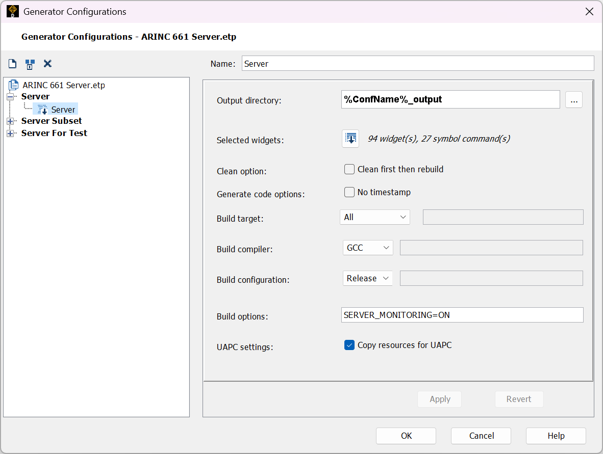

Before we start monitoring the server’s performance, we need to enable monitoring features. This is achieved by setting build option
SERVER_MONITORING=ONand going through the build process.
SCADE server creator with monitoring build option setThroughout the server code, monitoring features are locked behind
#ifdefs. This ensures that performance monitoring code is inactive when the server is built for production usage. This helps lighten the workload of DO-178C review activities and ensures that no computation resources are expended if monitoring is not needed.Available options
