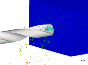

      1. Bond Model Module
      The Bond Model module allows you to create cylindrical shaped bonds between pairs of neighbor particles. The module also allows you to specify the normal and the tangential strength limits of these bonds, which will break when the external loads acting on them exceed these limits so the particles will not be bonded anymore.
      The image above shows an example of how this module can be applied. The process of drilling a hole in the wall is simulated where neighboring particles are bonded to represent the concrete. As the rotary drill bit forwards against the wall, the bonds strength limits are exceeded, and the hole is formed.

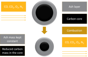

      2. CFD Particle Combustion Module
      The CFD-Coupled Particle Combustion module enables you to consider the reaction of coal particles during combustion. In this problem, conduction and convection are considered in the heat transfer modeling, as the local temperature affects the combustion rates. Radiation effects can be included through the Thermal Radiation module. Because of these abilities, it is designed to work with Ansys Rocky’s 2-Way Fluent coupling method, and Thermal Model.
      As illustrated in the image above, the fluid reacts with the solid particle. The carbon core will be combusted, and its mass reduced, whereas the ash layer will not react.
      Two reactions occur in parallel. In the first one, the oxygen from the air oxidizes the particle’s carbon content. This leads to the oxygen and carbon consumption, carbon dioxide generation and the consequent particle size reduction. Similarly, in the second one, the carbon dioxide from the air reacts with the particle’s carbon content to release carbon monoxide, reducing the particle size as well.

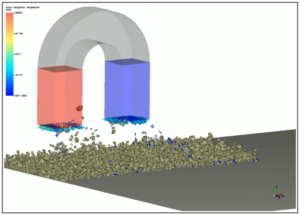

      3. Electromagnetic Coupling Module
      The Electromagnetic Coupling module enables you to add electromagnetic physics to the simulation, such as, Electrostatic forces for particle-particle and particle-boundary interaction; charging and discharging effects on particles due contact with boundary surfaces and field forces on charged or dipole particles immersed in electric/magnetic fields.

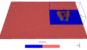

      5. Particle Freeze outside region
      The Particle Freeze Outside Region module enables you to save calculation resources and drastically speed up processing  by freezing the particles that are outside all the regions of interest and then disabling them from contact calculation.
      The image above shows an application example of the Particle Freeze Outside Region on a disk harrow simulation, in which the goal is to evaluate the soil tilling according to the disks angulation and spacing.
