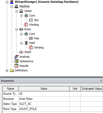

I followed all the steps of the online guide and rmxprt examples. And I have designed the Wound rotor synchronous machine, it finishes the simulation without any error but there are no results. can anyone help me out and explain why?
After this problem, I checked other given examples, they also finished the simulation without any errors and they also don't have any kind of results. why??

SubscriberHi,
I Design the Synchronous wound rotor synchronous machine In RMxprt from Generate RMxprt Solutions>General>Rotating-Field Synchronous machine.
or in other words, it is a Generic Rotating Machine (Rotating Field Synchronous machine).
And an example I mentioned; its path is as follows
Open examples\Examples\RMxprt\grm\SalientPole.aedt

RMxpr can not provide full performance results for this machine type.
It is mentioned at the end of the Design sheet for the analysis.
It requires an FEA analysis.
You an create a maxwell design using the RMxprt setup and continue your simulation in Maxwell

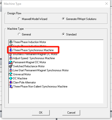

I actually found that I was just hoping that maybe there is another way around.
like there is another similar machine in standard Machine type "Three-phase synchronous machine" which was helpful but that has damper windings, and can't proceed without damper.
So, is that possible without damper???
