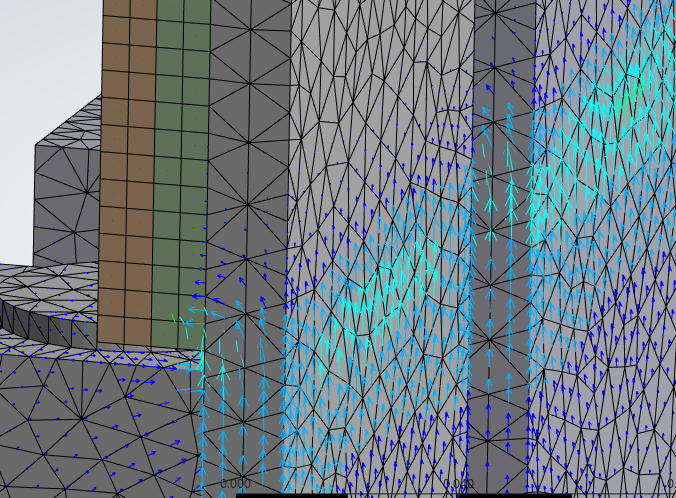

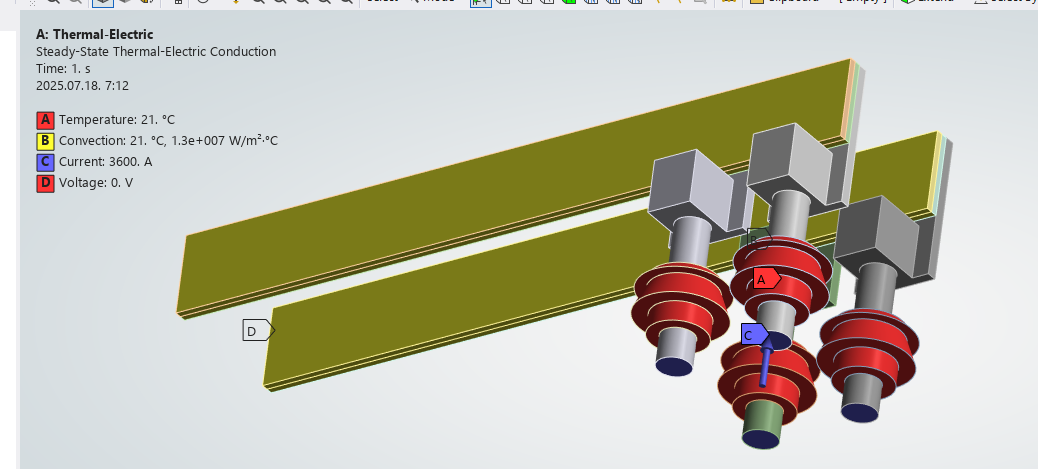

      Hello, I would like to create a simulation in Workbench (Thermal-Electric) with the following boundary conditions (image attached).
      The vector heat flux shows that for some reason the heat flux does not transfer to the busbars. How is this possible?
      The flag and the support rod form a single body in the geometry (same material), I set a share topology between the two 10 mm thick busbars in Spaceclaim. The connection between the flag and the inner busbar is bonded (it does not allow anything else).
      The busbars and the flags are made of different materials (brass and copper), so I had to define them as separate bodies.
      I set the 0 V voltage on the far side surfaces of the busbars (it is not visible in the image).

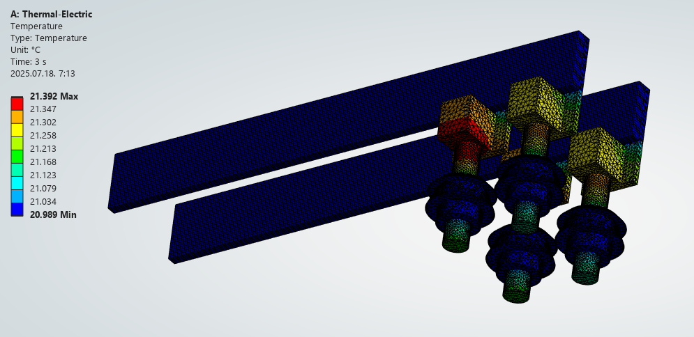

      Did I set something wrong? The result looks pretty incredible (the busbars do not heat up to a temperature higher than the ambient temperature).

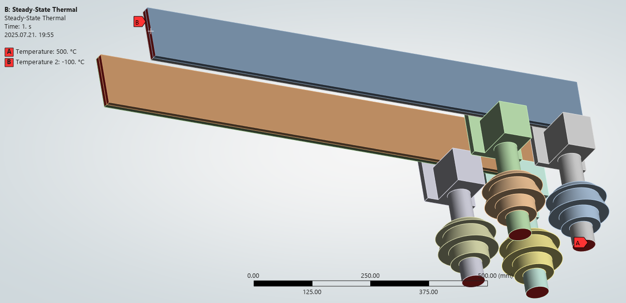

      Apply 0 deg on one end of model, then 100 deg on other and make sure you can get a proper gradient.

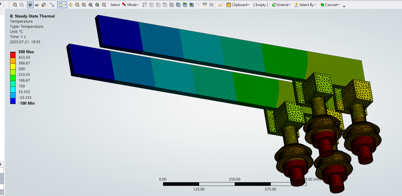

      I tried as you suggested, with the same model, using the following boundary conditions and it looks like the gradient works in this case. Why not in the thermal-electric study?

      I made a crude model with similar setup so I could try some things, such as change what's in contact, and the electric and thermal conductance on the contacts and other contact settings. Although this did make difference temperature contours, nothing approached your result, until I noticed your very high convection coefficient. In my test model, I made something closer to your result by using a high convection coefficient and manually specifying thermal and electric conductance value from the busbar to the post. Can you verify all these values in your model? As a sanity check, try setting the thermal and electric conductance to program controlled on the contacts, and lower the convection coefficient to see what you get.
