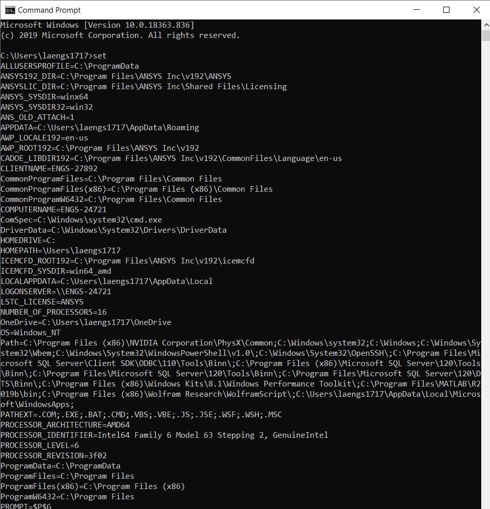

      I'm using a windows 10 departmental machine which has had a fresh install of Ansys (academic license). When opening Ansys Fluent, the program launches without any problems, however when launching Ansys Workbench I get the following error:
      "Not connected to a license server for licensing actions."
      As a result of which none of the Analysis Systems options (such as Fluid Flow (Fluent)) appear in the Toolbox window:
      Any ideas how this issue can be resolved???

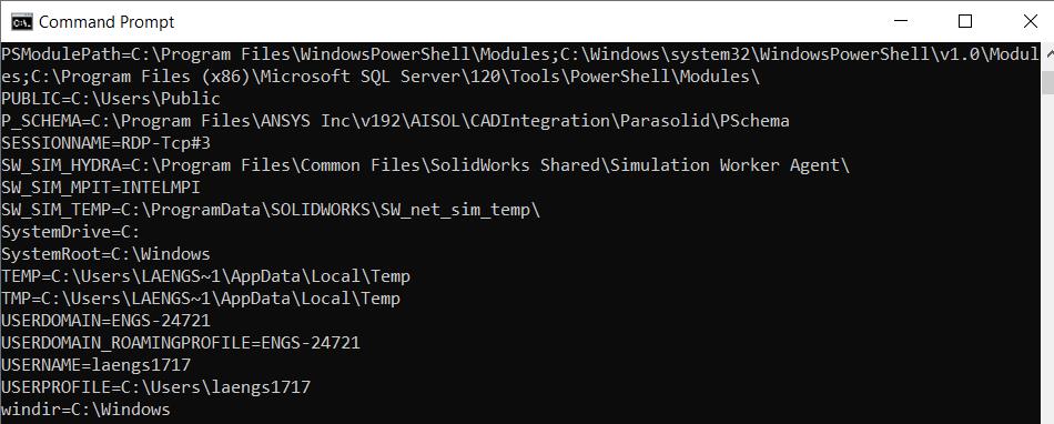

    • abolghasemi
      In order to provide more detail, here is the output from my License Preferences:
    • abolghasemi
      Also, I've checked the environmental variables and can confirm that ANSYSLI_ELASTIC and ANSYSLI_LCP do not exist and here is the output from running the "set" command in windows command prompt:

    • abolghasemi
      I also tried Configure Products and CADs by running ProductConfig.exe with 'run as administrator' and everything selected, but it hasn't resolved the issue.
    • abolghasemi
      Looks like the problem was that I was running version 19.2 on my client but the license manager was on a lower version, 18.2. Upgrading the license manager to 19.2 seems to have solved the problem.
