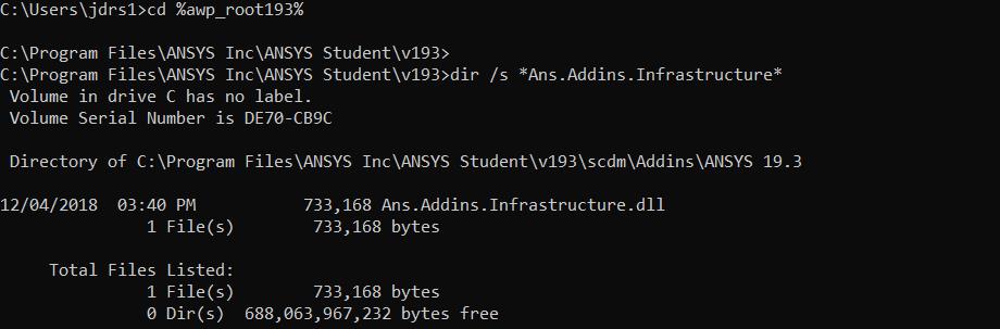

      I keep getting MANY errors saying I am missing files when I open Workbench. Workbench opens and is stable, but no tools show up.
      Copyable Error Text from first error:
      System.IO.FileNotFoundException: Could not load file or assembly 'Ans.Addins.Infrastructure, Version=19.3.0.0, Culture=neutral, PublicKeyToken=null' or one of its dependencies. The system cannot find the file specified.
      Fusion log:
      WRN: Assembly binding logging is turned OFF.
      To enable assembly bind failure logging, set the registry value [HKLMSoftwareMicrosoftFusion!EnableLog] (DWORD) to 1.
      Note: There is some performance penalty associated with assembly bind failure logging.
      To turn this feature off, remove the registry value [HKLMSoftwareMicrosoftFusion!EnableLog].
      Call stack:
         at ACP.Addin.Load(AddinLoadContext context)
         at Ansys.Core.Addins.AddinManager.setupAddin(String path, String name, AddinBase addin)
         at Ansys.Core.Addins.AddinManager.LoadAddin(String name, String path)
      I have tried uninstalling and reinstalling many times.  I even extracted the installation folder into the ANSYS Inc folder and then installed by "Run as Administrator". So far nothing has worked.

    • tsiriaks
      Hi Jake,
      Can you post the screenshot of the entire error message ?
      Also post the screenshots of the output of the following commands from CMD Prompt
      1.
      cd %awp_root193%
      dir /s *Ans.Addins.Infrastructure*
      2.
      set
      3.
      "%awp_root193%commonfilesIronPythonipy.exe"
      Thanks,
      Win

    • fluffy592fury
      If the problem still persists try disabling your antivirus, then installing ANSYS.
      Had the same issue, later found out that my anti-virus was isolating the addin files, disabling it
      seem to have fixed the problem.
