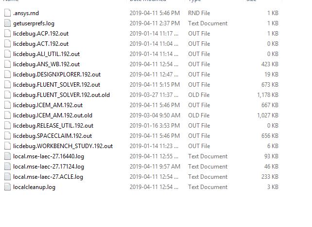

    • sumykk
      Hi Win,
      This is screenshot of my folder:
      Thanks,
      Ali
    • tsiriaks
      Hi Ali,
      Sorry, you have to sort by  'date modified' , then open the files with recent date. On each file that you open, search for the term 'denied'
      Thanks,
      Win
