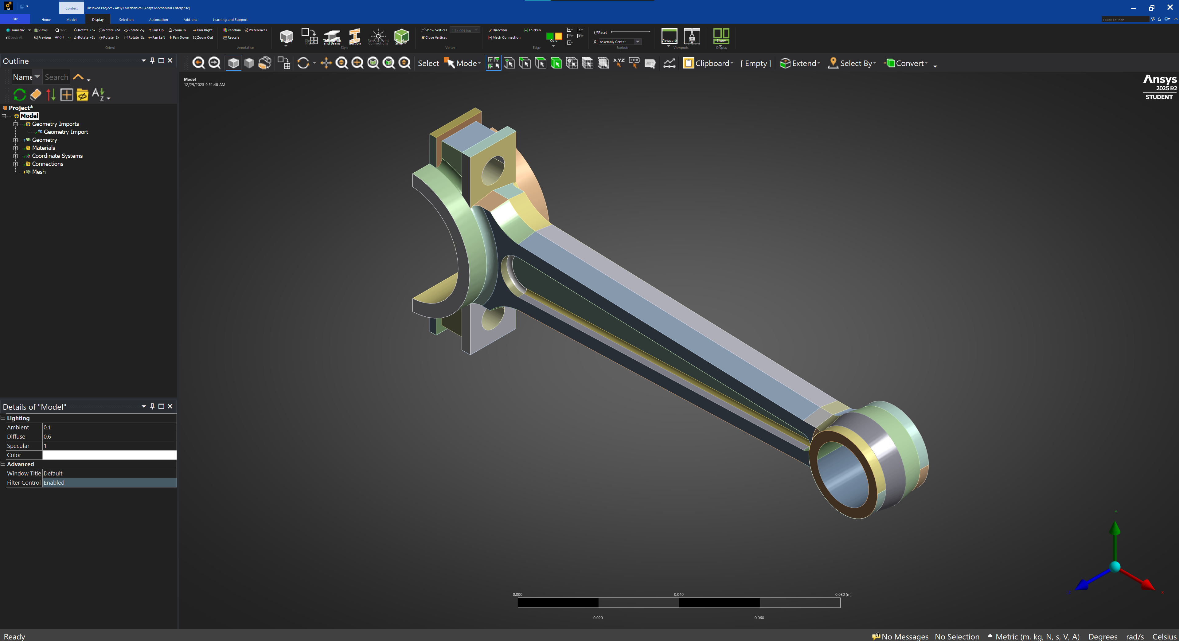

I have ansys products 2024R2 installed on a HP laptop. This is a windows 10 machine.
I connected a new HP 4K monitor (HP Series 7 Pro 27 inch 4K Thunderbolt 4 Monitor - 727pk) to this laptop last week and since then i am happy difficuties in viewing contents of the ansys workbench or any other modules. I tried with the solutions given to change the DPI, e.g.,Â
1.Change the High DPI settings under compatibility settings." Properties of workbench > Compatibility > Click on Override high DPI scaling "
2. Change the "Scaling performed by" option to "System(Enhanced)"But not has worked for me so far. This issue is hindering the work progress. Any help please?
Thanks
Venki

v.venugopal
SubscriberFollowing the above, opening the Ansys aqwa toolbox, cuts down the work window. please see an image attached. I have tried applying DPI settings to AnsysFWW.exx, RunWB2.exe and even on workbench 2024 R2.exe and all show the same.
Removing the DPI setting, atleast brings back the full window in Aqwa but resulting in blurry view. The animation is so worst and very poor quality.
