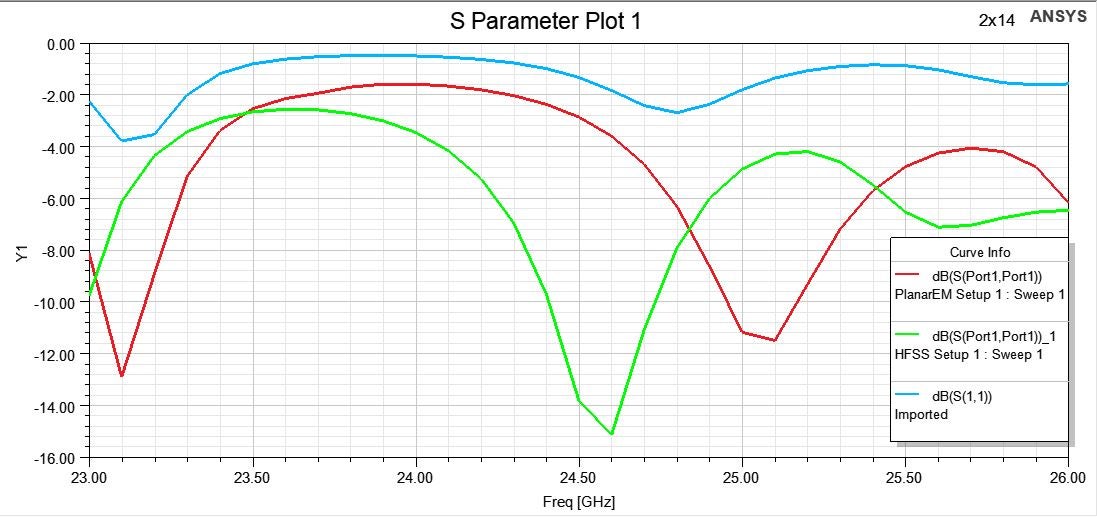

SubscriberH─░ Thank you for reply. I am sharing screen short of results. The results have three graphs. The red one is for the planarEM setup, green is for HFSS setup ( These both are obtained through ) HFSS layout tool while the blue one is for the result achieved by using HFSS 3D tool. As you can seen non of results are matching .

I suspect that the difference in results may be because of the differences in the simulation setups.
Are you using cosimulation with circuit and pushing the excitations into the models?
If so, can you check whether the excitations are set properly?

SubscriberNo I am not using co simulation . For PlanerEM setup and HSFF setup in layout are exactly same. I have import the dxf file and used edge port to excite it obtained Planer EM solution and HFSS solution without changing any thing
