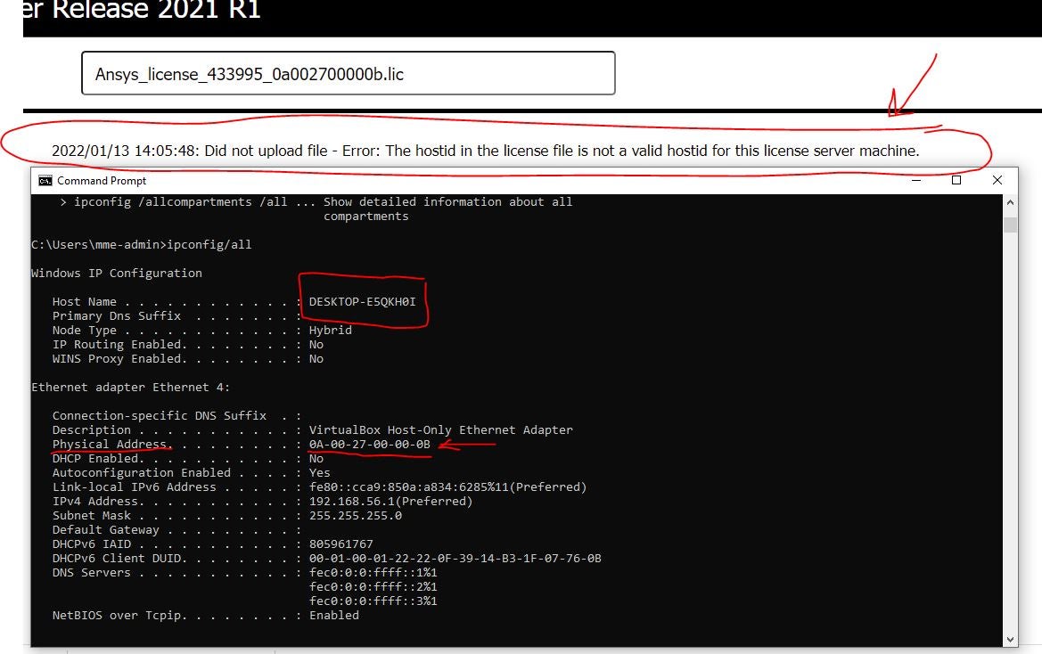

Why I’m getting this error? The host id in the license file is not a valid hostid for this license s

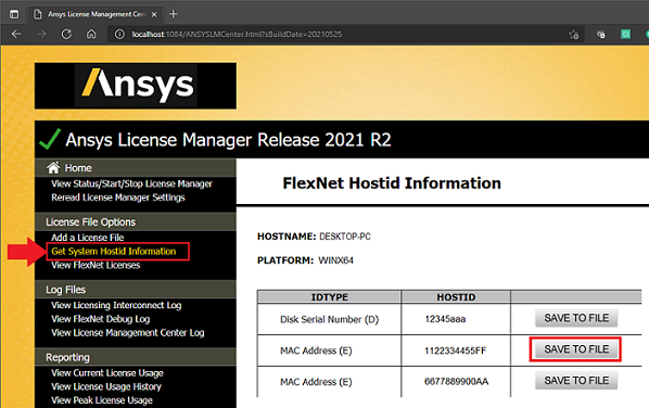

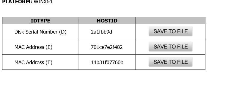

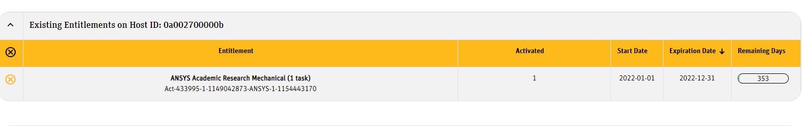

Ansys EmployeeFrom the command prompt, the mac address you are using is a "Host-Only" virtual box address. This could be the reason why it is not seen by Ansys LM. Use the HostID information found in the Ansys LM Center. You can use any of the Hostid information available in the Ansys LMCenter. "Save to file" and click on the "Re-host" icon in the Ansys licensing portal -> Manage Activations section. When prompted use the "Upload License..." option. Generate/Save and download the new license file.
January 14, 2022 at 1:16 amali.afrouzian
SubscriberThank you so much.
The issue has been resolved.
