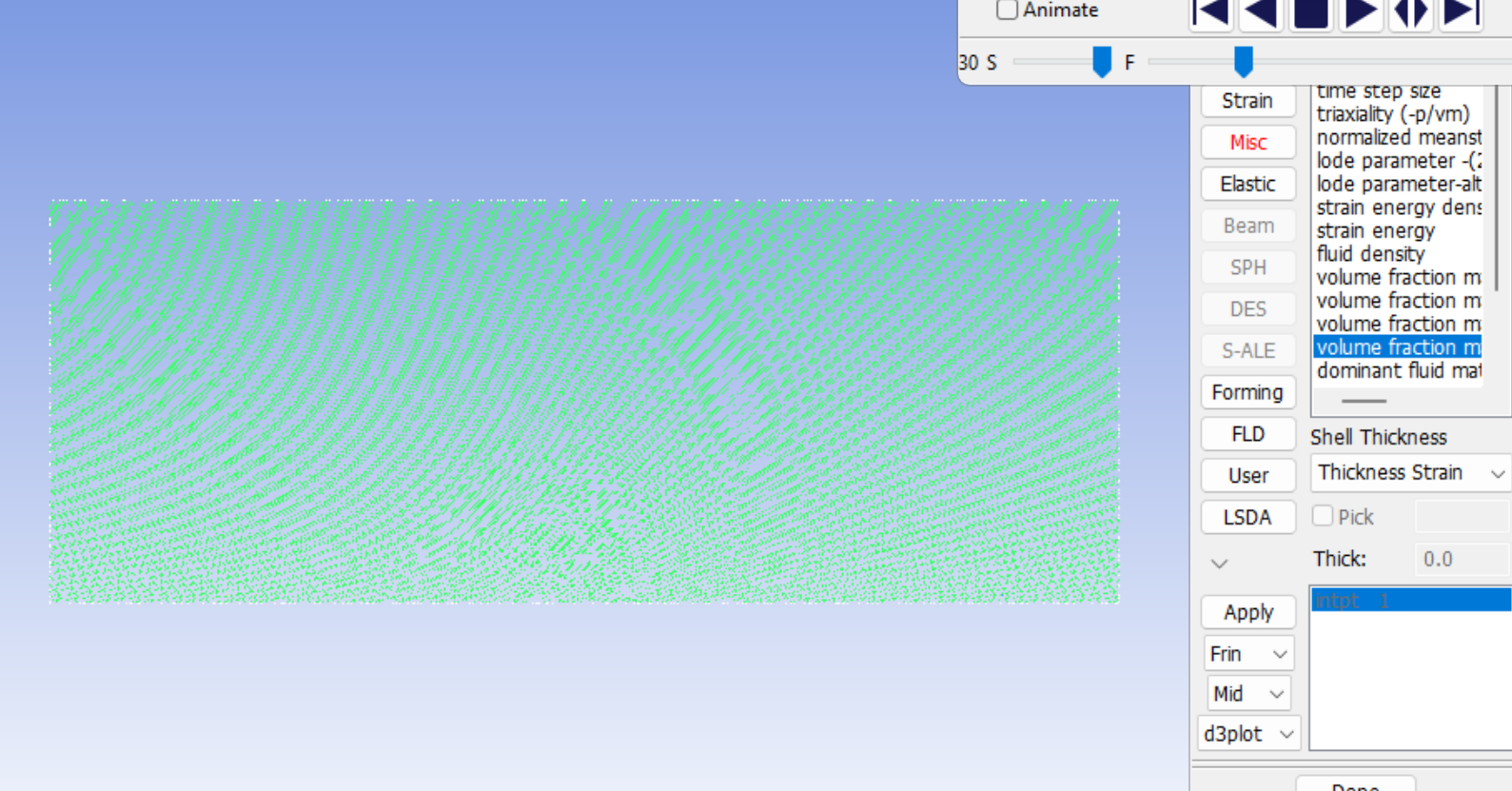

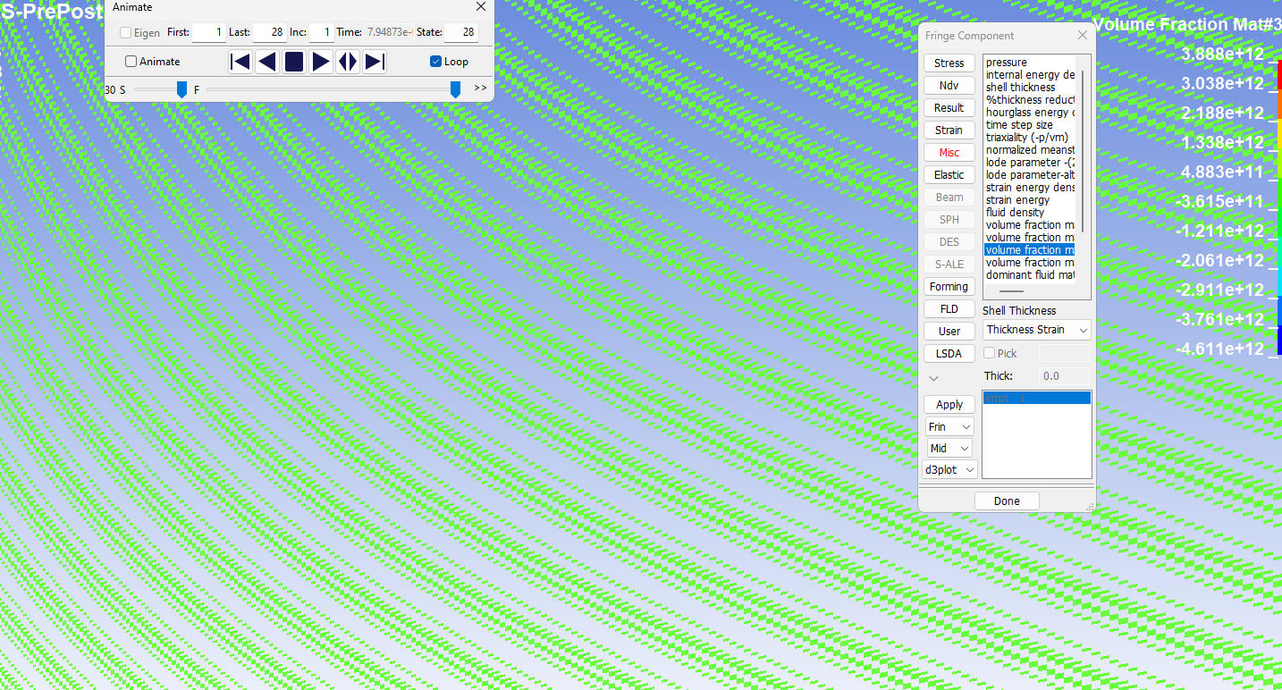

SubscriberAThe first d3plot looks fine, but every one after the first one starts looking like this. I have tried resaving folders, or doing the setup again froms scratch. Is it a mesh issue?Â
I exported Ansys workbench mesh as .k file, then opened in prepost to run. It was working fine, then i made a mesh refinement and did the same thing, now regardless what i do, when i open the post, the plots look like this. As if the index of the mesh cells got messed up or something. I have plotted graphs of energy etc, so my simulation is definitely not blowing up to cause this.
ALE axisymmetric no Lagrange bodies.
Does anyone know what is going on? Any help would be appreciated! -

What is the date of the LSPP version? Have you tried it with the latest LSPP 4.13 or 4.14? If it doesn't help you, you may want to try to delete your LSPP configuration file, supposing it is the Windows platform, with the following steps:
- Close all sessions of LS-PrePost.
- Enter %appdata% in the Windows Explorer address bar.
- Go to LSTC/LS-PrePost4.XX/Â
- Delete everything.
Additionally, are you running LSPP remotely or locally? Windows or Linux platform?

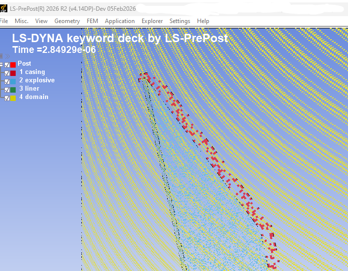

SubscriberI have been using 4.10. Workbench 2024R1. It is through AppsAnywhere with my school, so do I have to ask them to upgrade it? Windows platform. I was confused as before mesh refinement it was working fine and displaying correctly.Â

SubscriberI have figured out, it is due to the mesh I imported from workbench. I do not know why it did not like it, maybe because the scale factor was too big, but once I started using the structured ale mesh as the background, it now works.Â
