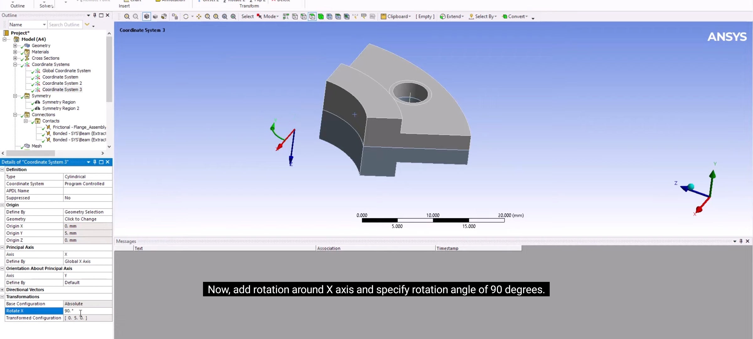

SubscriberIt is said that cylindrical CS should match with axis of symmetric model, but even after rotating it doesn't match, why it is done ?

SubscriberThis is in When to take advantage of symmetry in ANSYS mechanical Youtube video

Ansys EmployeeHi,
After rotating the angular coordinate (y-axis), is matching with geomtery.Thanks,

SubscriberNo, in mid of video, they have assigned a co-ordinate system for the symmetric plane, but this cylindrical coordinate system and symmetry plane assigned coordinate system didn't match
