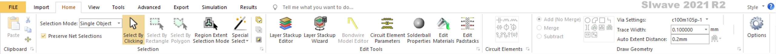

      I have been working on PCB design with SIwave and I have a recurring problem where suddenly the circuit editing tools get disabled and I can't figure out how to re-enable them. When I reload the model they'll work a while and then get disabled again at some point.
      Here's an screenshot of the top ribbon with the Circuit Elements and Draw Geometry greyed out:

      I have the same issue. I am not able to place circuit elements or draw geometry in any of my SIwave files. I am using 2022R2 version of SIwave thou.
      Did you find a fix for this issue?
    • AnttiP
      Yes, you need to have the Top-Down View enabled form the View ribbon. If you rotate the PCB even half a degree those tools are greyed out and you can't use them.

      It works now! Thank you for the help, i was trying to find the solution to this for while now!
