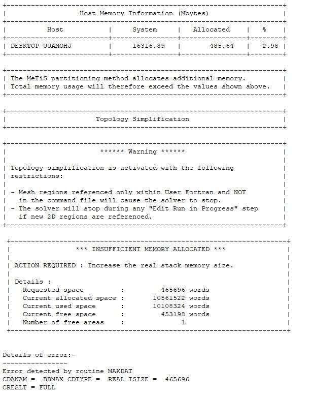

      I'm working with Vista CPD, Turbo Grid and CFX. I created geometry of impeller and volute, than mesh of impeller in TG and mesh of volute in ansys meshing, set settings in CFX-Pre and every time, when I would like to run solution with parallel option I have this error:
      Update failed for the Solution component in CFX. The solver failed with a non-zero exit code of: 2
       Details of error:-
       Error detected by routine MAKDAT
       CDANAM = XMAX CDTYPE = REAL ISIZE = 1048576
       CRESLT = FULL
         Current Directory : /FLOW/MESH/TSTEP0/CLOOP0/ZIF1/SRF_FRAC1

      What did you try? Can you show the head of out-file where the memory has been increased with that factor?

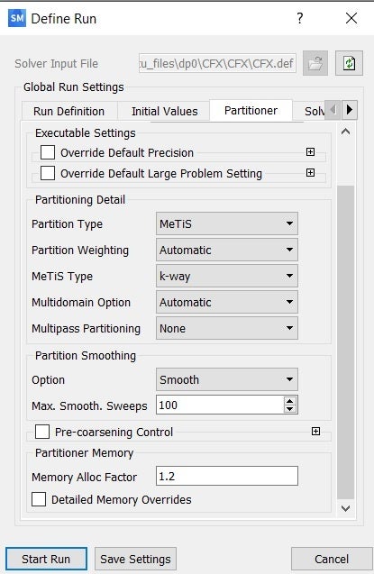

      I changed Memory Alloc Factor in partitioner to 1.2. I attached pictures
    • DrAmine
      Then just increase that factor or just increase under Partitioning Tab the Model Overrides the Real Memory to 20M
    • kacperw201100
      It worked! I've changed all factors to 10 and set problem as Large Problem. Thanks!
