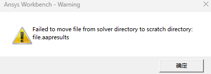

Ansys EmployeeHello Cheng,
Normally this warning comes when you clear generated data of solution and it remain still present in your solver directory somehow. You can go and manually delete the the file in solver directory like *.rst etc. Or duplicate the analysis system and solve the new system again.
Hope it helps.
Nanda.
May 29, 2023 at 7:27 pm
wancheng gao
SubscriberHello Nanda,Â
Thank you for your reply, will it affect reading the results without moving the .rst file before running the model?
The model is still running right now...
May 30, 2023 at 1:56 pm
Nanda
Ideally it should not affect reading the results. Ansys overwrites the previous files and this is just a warning. But a general guideline would be to follow the steps mentioned in my initial response.
Nanda
May 30, 2023 at 6:17 pm
wancheng gao
Thank you for your reply! Will follow your advice next time when i see this message again.
Hopefully nothing is gonna be affected...
