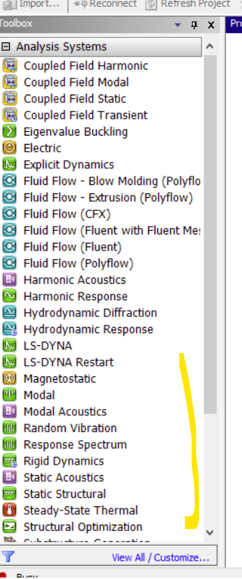

    • SIDDHARTH MOHAN
      Thanks for the reply, I will check that. Can you please also let me know how to see HFSS in the available utilities of Ansys Workbench in the left hand pane just like the other features shown below like ICEPAK etc... ? I do have both the AEDT & Workbench installations on the same machine.
      regards
    • Praneeth Munaga
      Hi Siddharth,
      Yes, it is possible to access Ansys HFSS from Workbench by integrating Workbench with AEDT. Please go through - "Ansys Workbench Integration Overview" chapter of the HFSS Help PDF document. Alternatively, you can also go through this topic using the online help link - Ansys Electronics 2023 R1 - Welcome to HFSS Help.
      Best regards,
      Praneeth.
