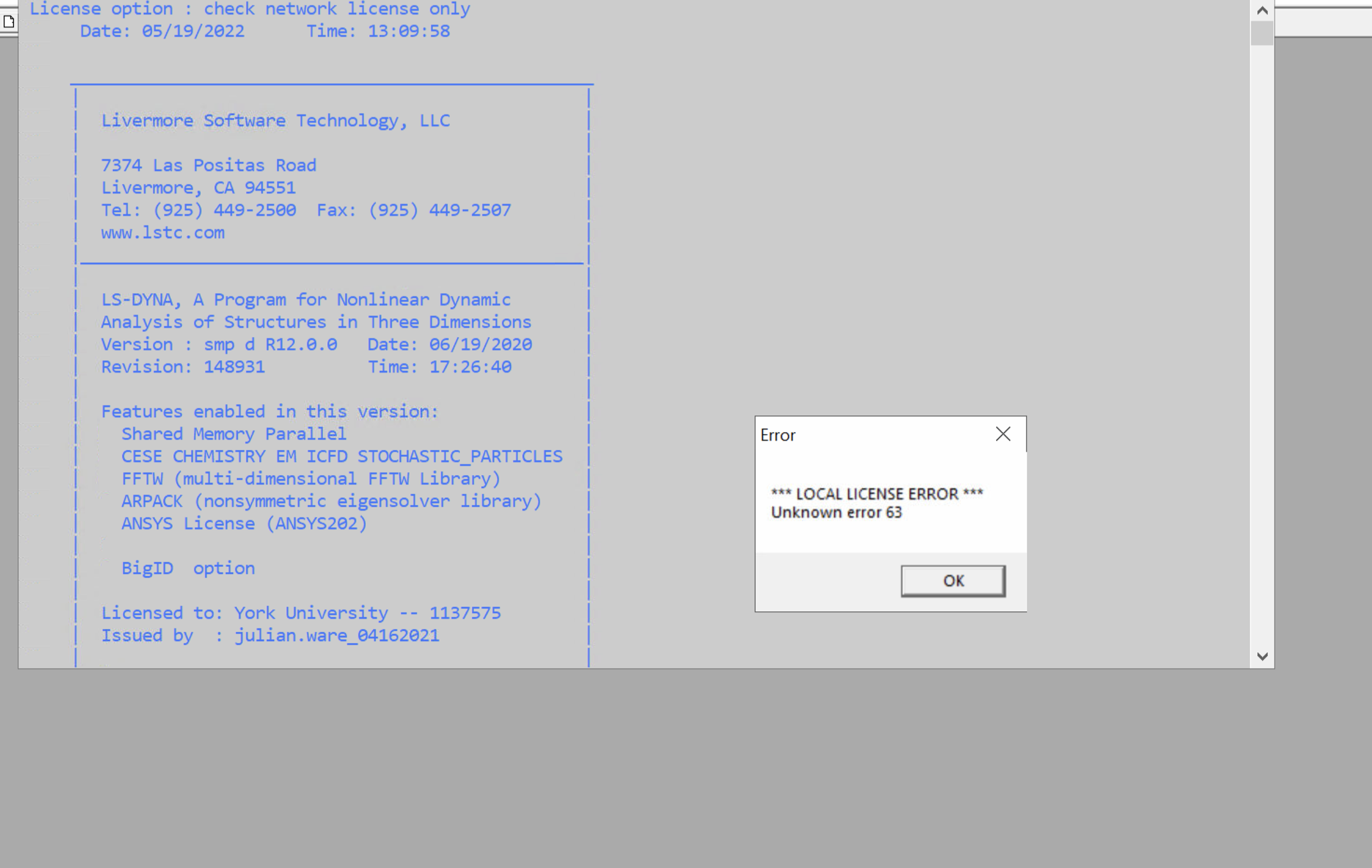

I don't see the images you sent. Can you write the error messages that you are getting?
What error message are you getting when running LS-DYNA? The error message is in the messag file.
What error message do you get when you try to start the LSTC license manager?

SubscriberThe first is "Local License Error Unknown Error 63"
The second says "Failed to Open LSTC License Manager Service. Access is denied."
The third says "Cannot Open Service with START access. Access is denied."

Try running the lstclmui.exe as administrator and try starting the LSTC license manager again. If this does not work, try to Uninstall, then Install, then Start. Let me know if this helps or not.
For the LS-DYNA error, this error message is not useful. Is it the error message from the messag file? I am not looking for a pop-up window error message; I am looking for the LS-DYNA solver error message from the messag file or the d3hsp file.

SubscriberIt worked! Thank you!!
