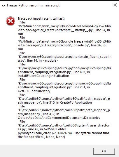

We use SCCM ( now known as MECM) to deploy software to our staff and computer labs. SCCM uses the SYSTEM account when it installs
However when installing as system it throws up the following error :
The commandline I am using is:
ansys-rockybundle-bin-22.2.X-win64.exe /SILENT
There is another post about this exact issue but the response given is not the solution:
Rocky installation under the SYSTEM account fails (ansys.com)
When I run the install command with my user account with administrator privileges it installs without error
Can anyone provide a solution why this error is showing when installing as system?

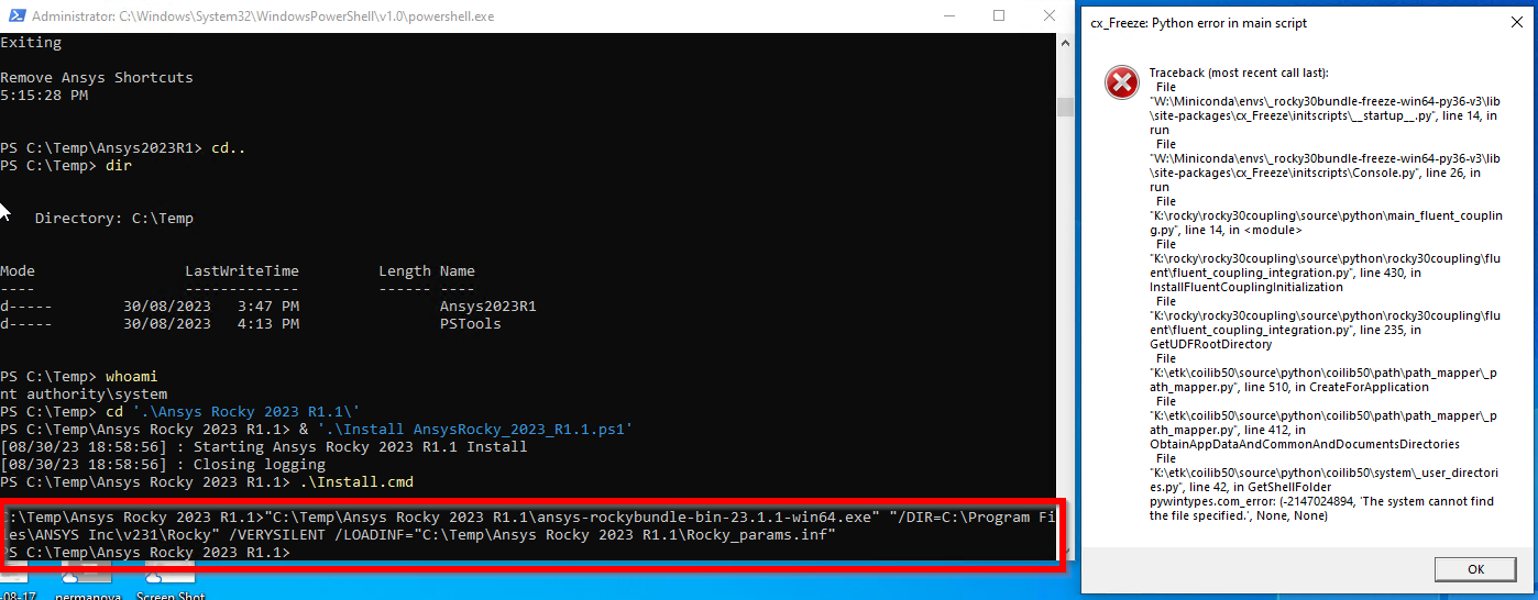

p.guerrisi
SubscriberÂ
Hi
Thanks for the reply again
I was able to do a regular manual install with the parameter /saveinfo and unchecked all the desktop icons. This resolved the problem with the "failed to expand Shell Folder Constant "userdesktop" error I was getting
I have been testing this on a VM with Windows 10 on it
I still get the original error even with setting the directory install location which is strange
See below what my install string is and that error that keeps showing at the end of the install ( as system account )
The process exe is named Fluent_coupling.exeÂ
I could just kill that process at the end.Â
Install string used is:
"ansys-rockybundle-bin-23.1.1-win64.exe" "/DIR=C:\Program Files\ANSYS Inc\v231\Rocky" /VERYSILENT /LOADINF="%~dp0Rocky_params.inf"

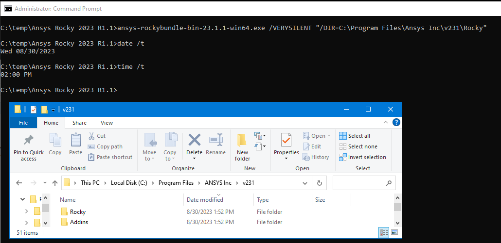

MangeshANSYS
Ansys EmployeeHello,
I used a test machine with Rocky 2023 R1 not installed. downloaded and unzipped the Rocky 2023 R1 update with full package .zip file and extracted to the path you are using
I also used the command line as shown. Rocky installed in minutes without any errorsÂ
I am not sure where the references to K and W drive are coming from. Please check the system's path and other environment variables if it is runnign python from those locations. perhaps try unsetting those portions of the path / environment ?
What else is being done in the .inf file ?Are you also trying to install the Fluent export plugin ?
hope this helps

p.guerrisi
SubscriberDid you use psexec to install via the system account?
If not that would be why you get no error
I've tried on multiple machines and even with a brand new Frehley imaged window 10 install and when I use the system account I get that error at the endÂ

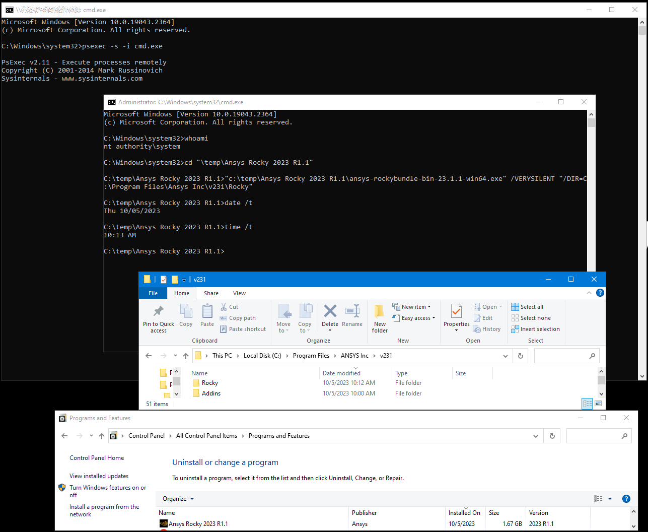

Using "psexec.exe -s -i cmd" (a Sysinternals/Microsoft tool), you can initiate an elevated Command Prompt session under the SYSTEM account to replicate the issue.Â
If you are unfamiliar with the procedure, kindly assign this task to another Ansys support employee.I can confirm that the Rocky 2023r2 installation has the same problem.

MangeshANSYS
Ansys EmployeeHello
It worked with psexec as well
I uninstalled the old version
I opened an elevated command prompt and launched cmd under system account and ran the .exe /VERYSILENT with the DIR= flag as seen below
Are there any other issues with your account or administrator rights ? Perhaps have another system administrator run this to verify if this is not an issue with your account ?I hope this helps

Ansys EmployeeIt is important that the process be launched from an elevated prompt. could it be possible that your workflow is not running the command as elevated user ?
The machine where i ran the test is a Windows 10 laptop (not a VM) . the test above was to duplicate the other's setup. so I installed approproate utilities from sysinternals (I believe psexec) made sure to launch it elevated. (see output of whoami in screenshot above)ÂI hope this information is helpful
