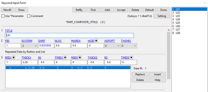

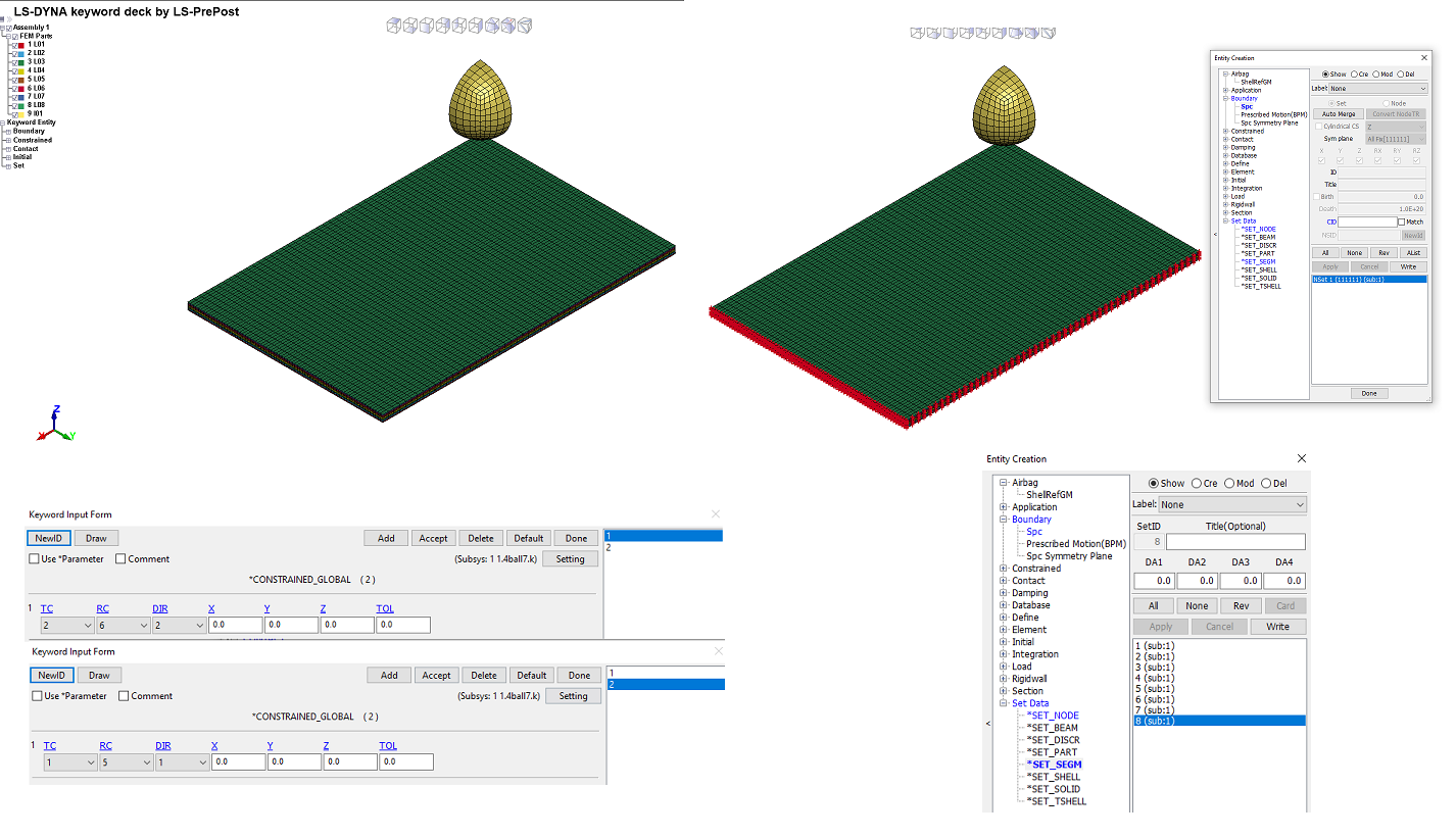

      I am going to try to depict my problem through images, but let me know if you need any further data. This is my 1/4 model (with L0x representing a given ply, and I01 the ball) and its boundary conditions, symmetry condition and segments created (with the same number of the respective part).

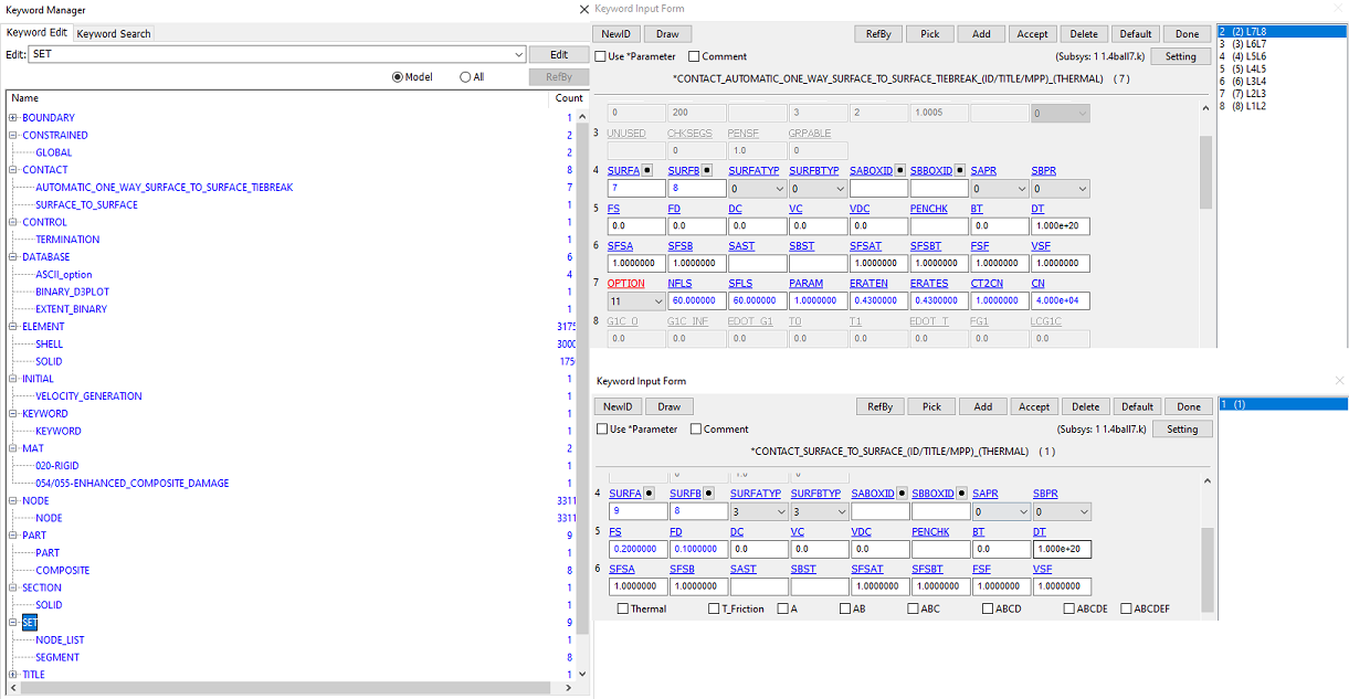

      The list of keywords, the contacts (tiebreak and ball to plate) and the generation of a *PART_COMPOSITE for each ply are as follows:

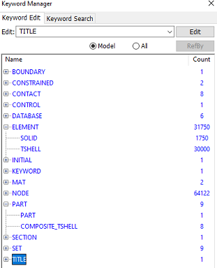

      This simulation runs correctly to its termination. The only thing that changes for the Tshell simulation is the definition of Tshells instead of thin shells:
      This simulation ends at the first timestep, with all entities disappering (with visualization with the d3plot file). This is an excerpt of the lsrun.out file:
             1 t 0.0000E+00 dt 9.00E+05 flush i/o buffers            06/04/23 17:00:12
             1 t 0.0000E+00 dt 9.00E+05 write d3plot file            06/04/23 17:00:12
       *** termination time reached ***
             1 t 9.0000E+05 dt 9.00E+05 write d3dump01 file          06/04/23 17:00:12
             1 t 9.0000E+05 dt 9.00E+05 write d3plot file            06/04/23 17:00:12
       N o r m a l    t e r m i n a t i o n                          06/04/23 17:00:12
       Memory required to complete solution   :    4243K
       Additional dynamically allocated memory:      17M
                                         Total:      21M
      Again, if you need more data please detail me what you need. Bear in mind that I am unexperienced in FEM and LS-DYNA, so it could be that the mistake is something rather basic, but I believe it should be something about the Tshell elements as with the thin shells the simulation runs fine. Thank you very much in advance.
