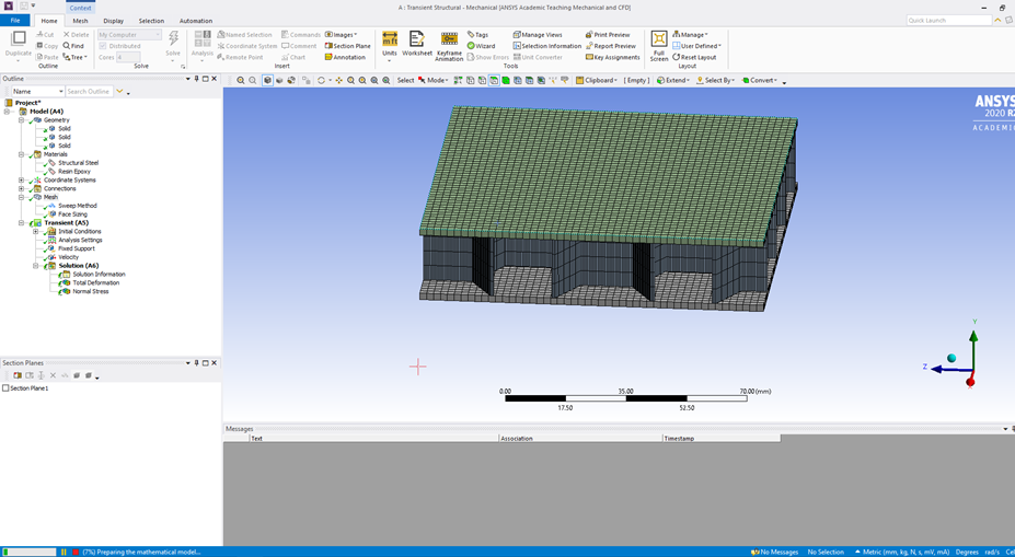

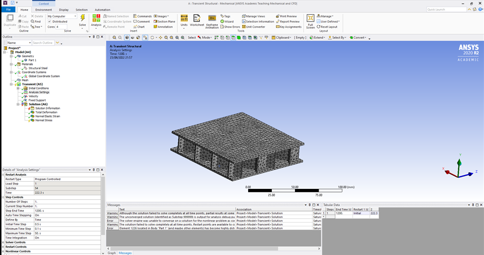

I'm using ANSYS Mechanical 2020, to simulate a compression test on imported geometry. When solving, the solution cannot converge and fails. I'm unsure of what is causing this and have unsuccessfully tried several different methods. Belo are some screenshots of the analysis.

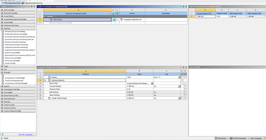

Currently It is default structural steel as I am waiting on the resin material to be unlocked by my admin, which is what I intend to apply to the model. Any properties will likely be taken from the ANSYS database.

SubscriberThe details of the material model for the resin will make a big difference in how the structure will collapse.
When you have those details, please show them.
You will also need a mesh with at least 4 elements through the wall thickness.

SubscriberI ran a model with an element size of 0.25mm to allow for 4 elements within the walls, however this resulted in a very long meshing time. If there is a way to implement this that is simpler it would be greatly appreciated if you could help.
April 27, 2022 at 2:20 ampeteroznewman
SubscriberThe part is sweepable if you slice the top and bottom plates using the faces of all the walls.

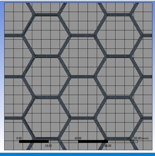

SubscriberShow the pattern of the core. Are there planes of symmetry? If so, you can cut the model on the symmetry plane and reduce the size of the model, but that enforces symmetry on that plane whereas the full model might have buckled in a non-symmetric way.
April 27, 2022 at 1:30 pmApril 27, 2022 at 8:55 pmpeteroznewman

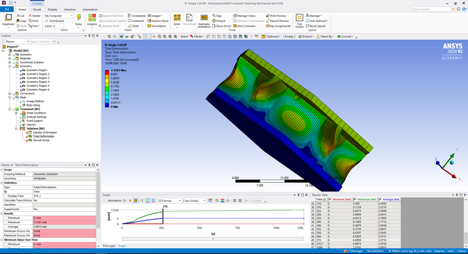

SubscriberI see 8 full cells in the center and many partial cells on the edges. You could cut it down to a smaller section with fewer full cells. For the smallest model, you could use 6 planes and cut it down to a single cell. I would put the cutting planes at the halfway point along the cell side walls so you have a hexagon with six short walls extending out. Use a Symmetry Region and create coordinate systems with an axis direction aligned with each of the six short wall segments to create a symmetry boundary condition that represents the other half of the wall scoped to the cut face of the short wall.

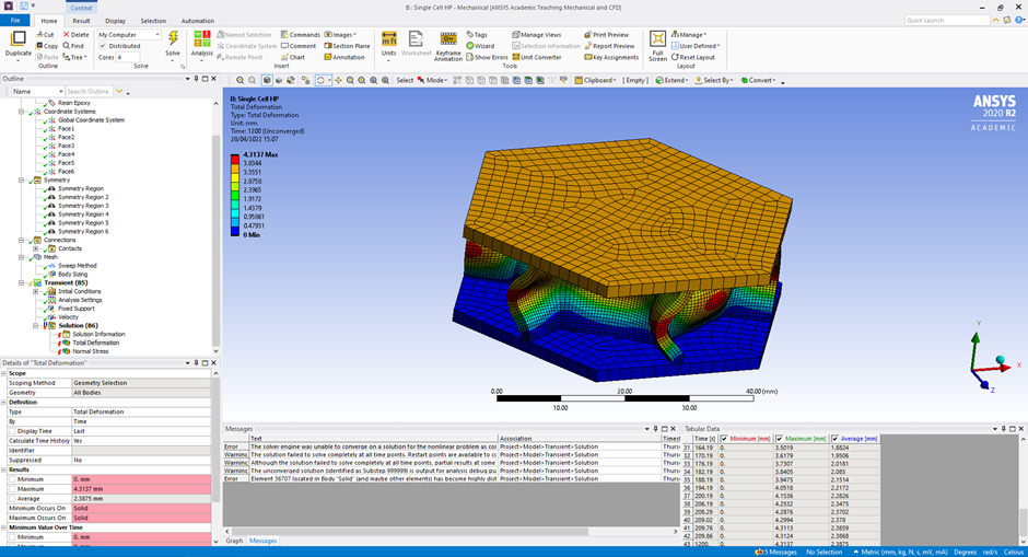

April 28, 2022 at 2:20 pmSjames22
SubscriberI did as you said this cut down the computational time somewhat, thank you for this.
However, It is failing to converge at about 200 seconds.

April 28, 2022 at 3:44 pmApril 28, 2022 at 8:43 pmSjames22
SubscriberThe required memory for the model is about 6GB, the computer that it has been run on only offers 1.5GB for the Model. Warnings about bottlenecks are given.

April 28, 2022 at 10:07 pmpeteroznewman
SubscriberThe required memory is for solving it fast. It can solve it slowly with less memory.
If you are using Structural Steel, that is a linear material, so there is no yield point defined in the model.
Try changing to Structural Steel NL which has a Plasticity material model so that the steel has a yield point and the metal gets permanently bent.
This model is being compressed slowly, so you don't need Transient Structural, you can get the same result in Static Structural.
It would be beneficial if you don't have bonded contact between the cell walls and the face sheets. In SpaceClaim, on the Workbench tab, use the Share button. Then add Multizone mesh control to the top and bottom face sheets. This should flow the mesh from the walls into the facesheets so that the mesh will be connected at the nodes instead of with bonded contact.

SubscriberI have been using the Epoxy Resin material as shown above, for these tests. All the values that I have are shown in that picture. Will this not be sufficient for the test?

SubscriberThe inertial forces for a velocity of 1mm/min are practically zero, therefore a Transient Structural and Static Structural solution will provide the same result. All that matters in Static Structural is the total displacement.
The Epoxy Resin you show above has only linear elastic material properties so no material failure is defined. You need to add some kind of material damage model to see the material fail. Ductile materials such as steel exhibit plasticity after exceeding the yield strength. You can add a Plasticity material model to allow the material to flow after the material exceeds the yield strength. There are also viscoplastic material models which might be relevant to an epoxy resin. You need to do a lot more study of material failure models and figure out what is appropriate for your material.
