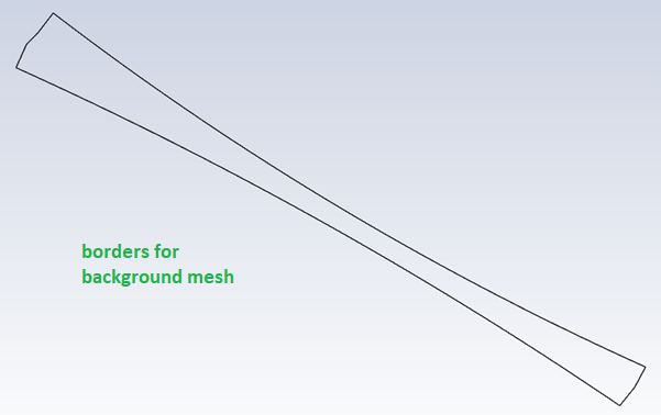

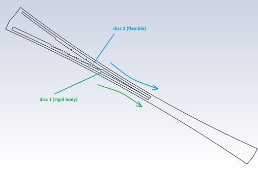

SubscriberThank you for your answer. In the following, I put some photos with explanations. To clarify, each of the objects is a part of a disc which rotates.n(Please note that here I'm showing the ideal case where the motions are all defined by Mesh motion. As the Fluent cannot receive the Location, I have changed the model so that the meshing for disc 2 is stationary and instead, the wall movement for that disc is solely caused by Structural. I wished there was a better solution ? )nAll solid objects and the domain are shown in the below picture. Arrows indicate the directions for rotations.n
The background mesh is inside the below picture (The mesh itself is not shown):n

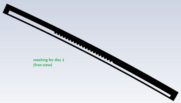

The component mesh for the disc 1 is shown here. Note that the mesh is very fine and we see the meshing part in black. The borders for the mesh are all defined as Overset.n

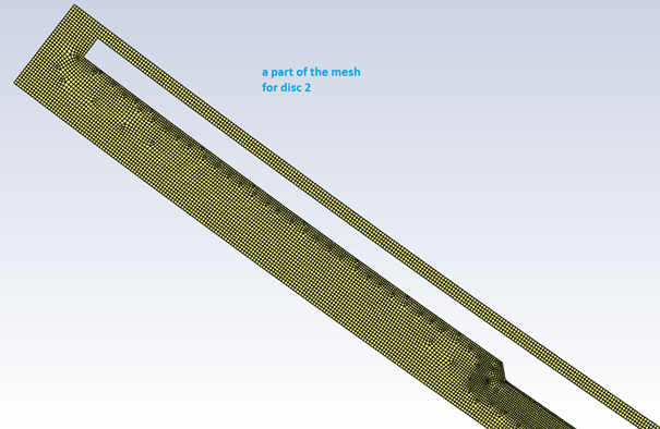

nThe following picture shows the walls for the disc 2 which is surrounded by a mesh. The borders for the mesh are all defined as Overset.n
