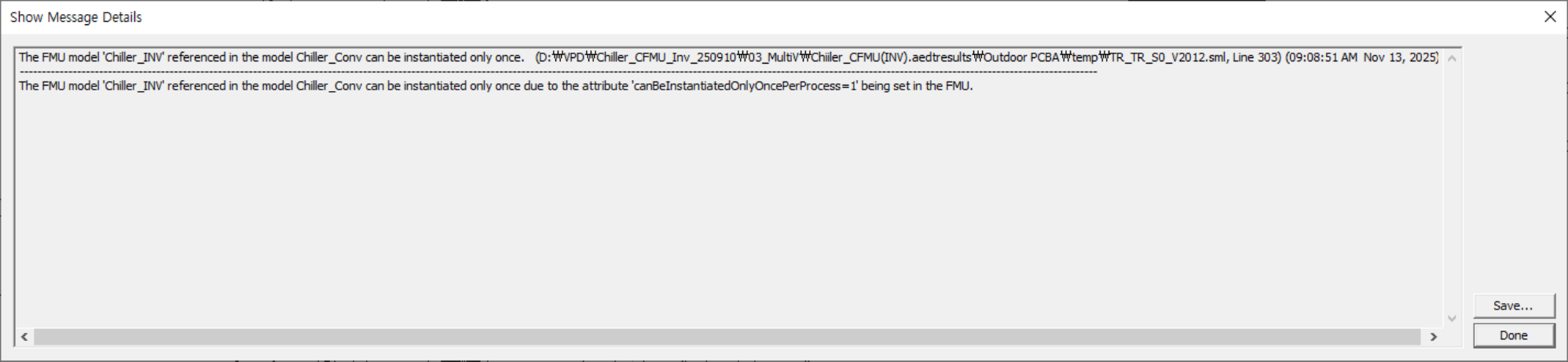

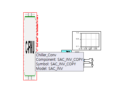

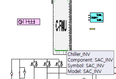

However, the following error occurs.
How can I solve this?
I want to know.
Thank you.Â
Error Message :Â
The FMU model 'Chiller_INV' referenced in the model Chiller_Conv can be instantiated only once due to the attribute 'canBeInstantiatedOnlyOncePerProcess=1' being set in the FMU.Â1) CFMU(1)
2) CFMU(2)
3) Error MessageÂ

Ansys EmployeeTo address the limitation of the FMU model 'Chiller_INV', you may try the below:
Use Separate Processes: Since the FMU can only be instantiated once per process, you can run multiple instances of the FMU in separate processes. This approach allows each process to have its own instance of the FMU, effectively bypassing the limitation
Modify the FMU: If you have access to the source code or the ability to modify the FMU, consider changing the 'canBeInstantiatedOnlyOncePerProcess' attribute to allow multiple instantiations. However, this requires a deep understanding of the FMU's internal workings and should be done with caution.
Utilize a Master Tool: Implement a master tool that can manage multiple FMUs by coordinating their execution. This tool can handle the instantiation and communication between different FMUs, ensuring that they operate within the constraints of the FMI standard. The FMUs act as slave components, and the master tool organizes their execution. Introduction to Ansys SCADE Suite - Ansys Learning Hub
Consider Co-Simulation: If the FMU is used in a co-simulation setup, ensure that the simulation environment supports co-simulation FMUs. Ansys Fluent, for example, supports co-simulation FMUs using FMI 2.0, but only one FMU file can be imported at a time. This setup might require restructuring the simulation to fit within these constraints.
By implementing the above strategies, you may be able to effectively manage the instantiation limitation and ensure that your simulation environment can handle multiple FMUs efficiently.
