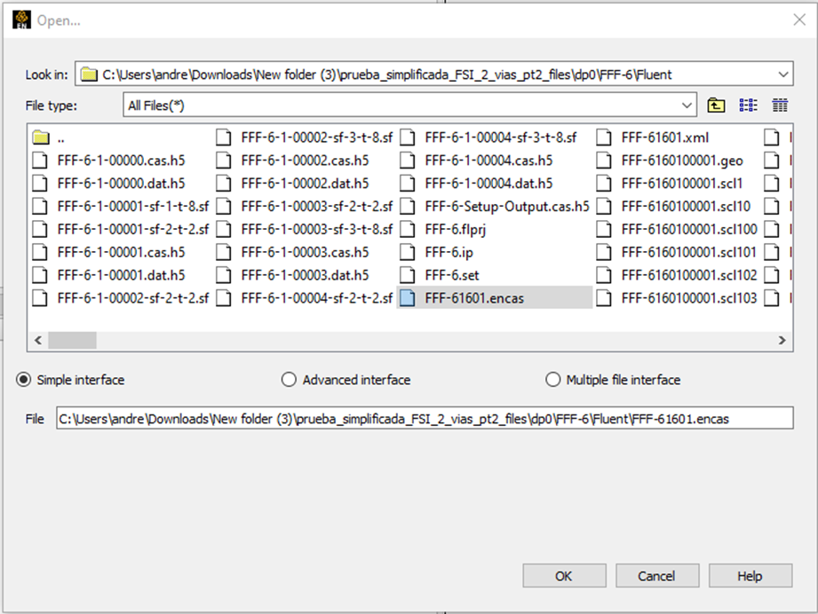

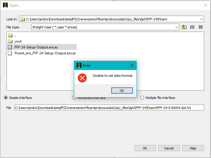

andres.baeza
SubscriberThank you for your responses.I was trying to add the Fluent case without System Coupling in EnSight, and when I opened the ".encas" file in EnSight, I had no problems (in Fluent, I used Export -> Solution Data and selected "EnSight Case Gold" as the File Type).However, after creating another Workbench and running System Coupling between Fluent and Transient Structural, when I tried to open only the Fluent ".encas" case in EnSight, I got the error "Unable to set data format." I don't know if it was a coincidence that one worked and the other didn't, or if it's related to simulating with System Coupling and then trying to open the ".encas" file associated with Fluent in EnSight.What could be the causes, solutions, and/or recommendations so that I can open the Fluent-associated case in EnSight after running the FSI simulation with System Coupling?
January 23, 2026 at 4:22 am
Anilkumar
Ansys EmployeeHi,
I think your are giving wrong inputs.
Can you please give the correct file path for encas? in the image it is showing dat file and that is why you are getting this error. you can go to advanced interface and choose the format to be Ensight Gold and give the correct file path then you should be able to import the file.
Anil

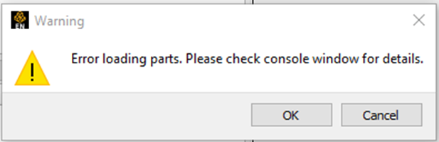

andres.baeza
SubscriberThank you so much for your answers.I created a second example where I fixed the previous problem, but I encountered another error:How do I find the "Console" window? What could be causing this error, and how can I fix it?Is it possible for someone to make a video demonstrating an example using Ensight with system coupling (also including Fluent and Mechanical cases)? (optional)
