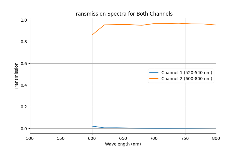

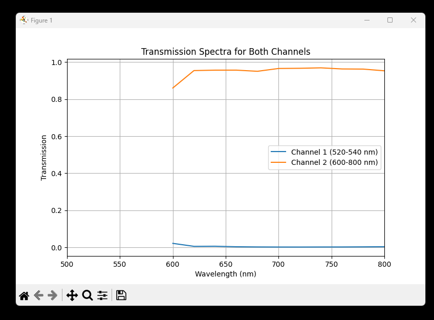

August 7, 2025 at 8:05 pm
Taylor Robertson
Ansys EmployeeHello,
I don't believe that the optimization has run to completion, but it looks like the Transmission targets are pretty close to the target. I don't believe that DFM is being allowed to complete. Maybe reduce the max_iterations ~200.
Because you have two channels and wavelength targets there are multiple simulations being run. The results you are looking at are for the second target 600-800nm. You can look at "opts_0\forward_0.fsp” to see the other wavelength target.
Alternatively, I would adjust the bandwidth in the final simulation and plot the results for 500-800nm.
fdtd.load(fsp_path)
fdtd.switchtolayout()
fdtd.setglobalsource('wavelength start',500e-9)
fdtd.setglobalsource('wavelength stop',800e-9)
fdtd.setglobalmonitor('frequency points',100)
fdtd.run()
Some other things to consider, you are using a single index value of 2.417 for the whole bandwidth, while there is likely dispersion. The filter_R parameter is the radius of the convolution filter used in the grescale and binarization. This isn't guaranteed to to achieve a minimum feature size, but is intended to close out small features in the topology object - box blur. There is no definitive answer here, you can play around to see how this effects performance and minimum feature size. The DFM step, actually penalizes the FOM when minimum features are present, and then optimizes; however, I don't think you have run the DFM step for this device.Best Regards,

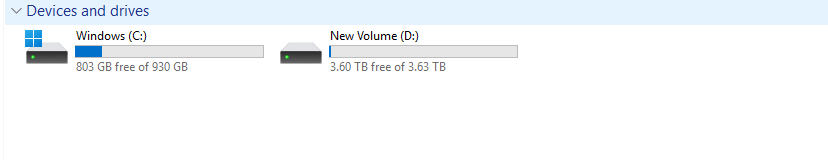

October 8, 2025 at 9:42 pm
raano1
SubscriberHello ANSYS Support Team,
I am running my simulation using the D: drive, which has plenty of free space (as shown in the attached image). However, during my inverse design simulation in ANSYS, the computer shuts down automatically after about 10–12 steps.
Previously, the same code ran successfully up to 120–175 steps without any issues.
Could you please advise on what might be causing this and how I can resolve it?
Thank you,
October 14, 2025 at 5:00 pm
Kirill
Forum ModeratorDear Subscriber,
This issue does not appear to be related to the Lumerical itself, but rather to a hardware stability problem. Since the system is shutting down completely, it’s likely caused by thermal or power limitations.
As a first debugging step, I recommend running a standard FDTD simulation on your system to confirm whether it behaves the same way. You could also try saving and running your simulation on the C: drive to check if performance or stability improves.
Additionally, please monitor your system’s CPU, GPU, and SSD temperatures during the run. If the SSD overheats, some systems may throttle or even shut down to prevent damage. Ensuring good airflow or using SSD thermal pads or heatsinks can help maintain stability during long simulations.
Best regards,
Kirill -

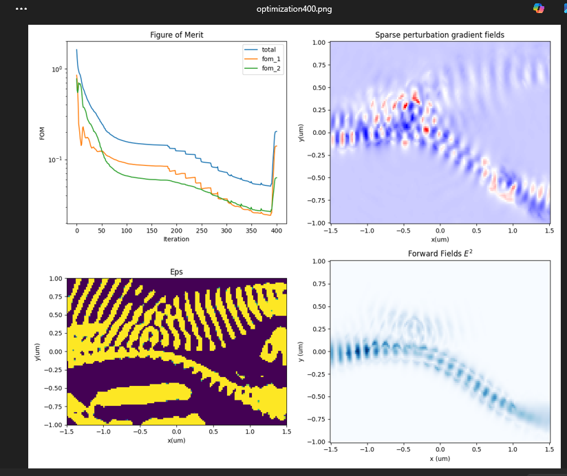

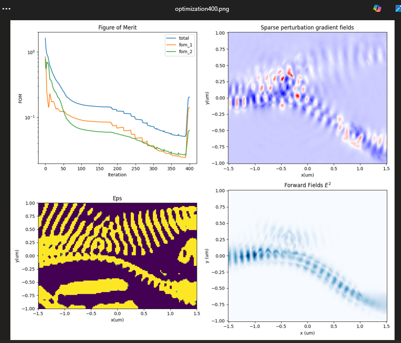

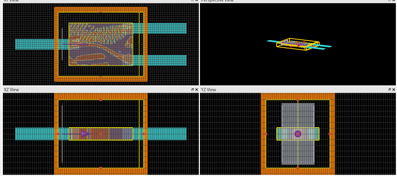

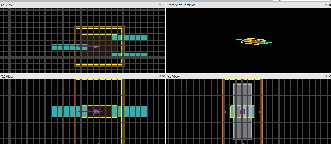

November 4, 2025 at 4:17 pm
raano1
SubscriberDear Ansys Support Team,
For the results, I’m using the python code method and I got the result. In the case of the GDS file, I’m using a direct Python code-will it automatically create the GDS file? Is that possible?
Could you please guide me properly? -
November 4, 2025 at 6:44 pm
anna.wirth-singh
Ansys EmployeeThanks for the updates. From your first image, it appears that the topology optimization may not have fully completed – as described in Optimizable Geometry - Python API – Ansys Optics, there should be a binarization step after the greyscale optimization in order to discretize the permittivity into the two levels:
Since there is a lot of color range in the plot, it appears the structure has not yet been binarized (material/ no material) – it may still be a gradient refractive index. Did you get any error messages on this run?
For GDS export of topology devices like this, we recommend the getcontour - Script command – Ansys Optics method as described in this article: GDS pattern extraction for inverse designed devices using contours method – Ansys Optics
For the issue with the visualizer – can you please check the z position? Possibly the index monitor is not viewing the desired cross-section. Alternatively, if the structure has not fully binarized so there are no sharp edges, it may struggle to identify any contours.
Best,
Anna
