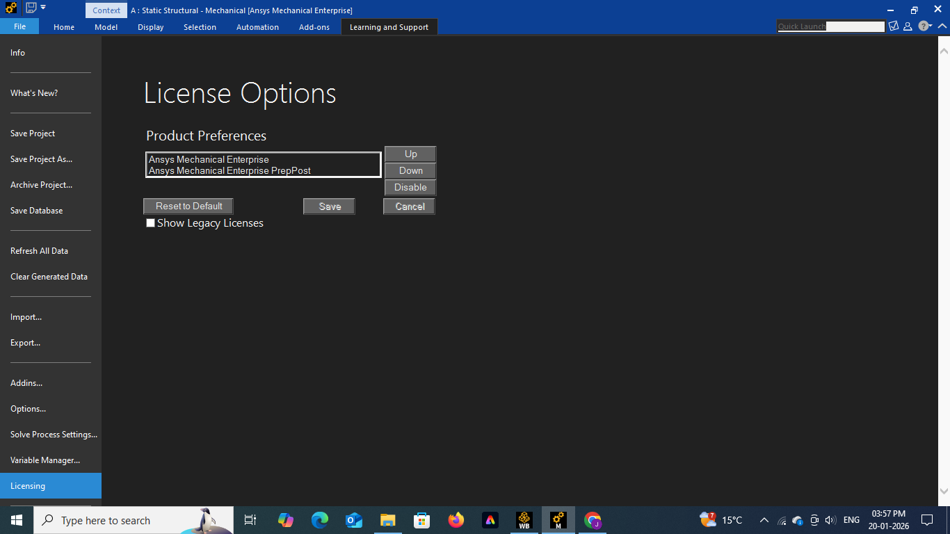

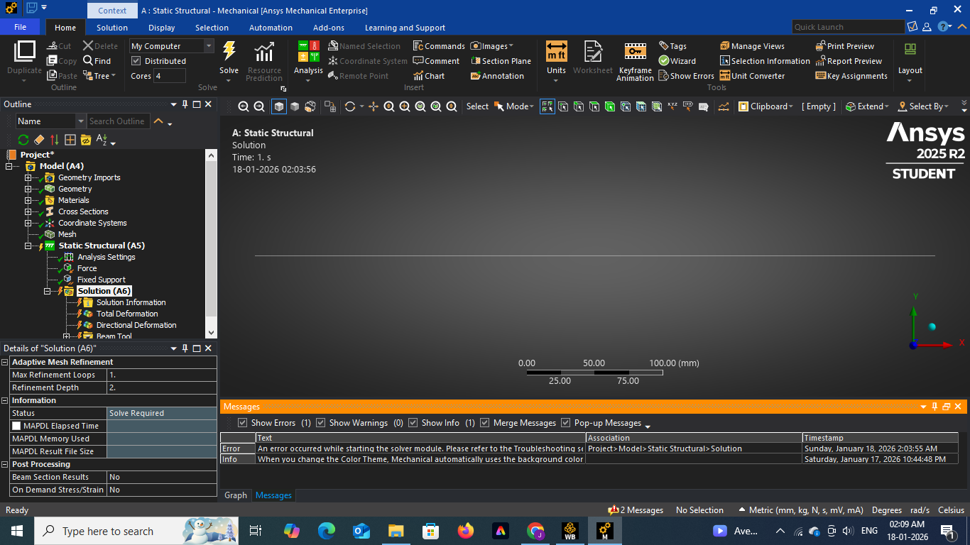

In Ansys Mechanical Student version 2025 R2, if I try to solve the solver window appears but closes immediately after initialization without giving results. I have tried so many times to fix the problem, reinstalled it, tried running as administrator, tried changing the cpu cores, also checked visual C++ redistributables, also made the ansys folders in the virus and malware exception list. During troubleshooting I also noticed that in ansys mechanical the license itself showing enterprise version, not student license version but in the corner of the GUI it showing as Ansys 2025R2. Since I have low space in my C drive I installed it on my D drive, I have 4 GB RAMÂ and running on Windows 10 Pro operating system. Please resolve this issue as soon as possible. Thank you. -

Ansys EmployeeLets make sure the solver itself runs...
In your Ansys 2025R2 Program group, look for Mechanical APDL Product Launcher
Select the license, select Shared Memory Parallel, then Run.
See if the GUI starts.ÂÂ
January 20, 2026 at 7:53 pm
jyotirmoysaikia05153
SubscriberI have tested using the  Mechanical APDL Product Launcher but when I tried to open it a black window appeared and vanished immediately i.e., the GUI window doesn't open. Please tell me what I have to do now.
January 20, 2026 at 8:03 pm
Gary_S
Ansys EmployeeÂ
In the MAPDL Launcher, there is a setting for the Working folder.Â
Please look in that folder to see if any error files or log files. Examine them with any text editor.ÂÂ
