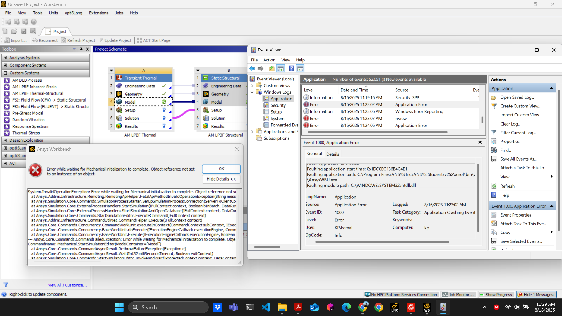

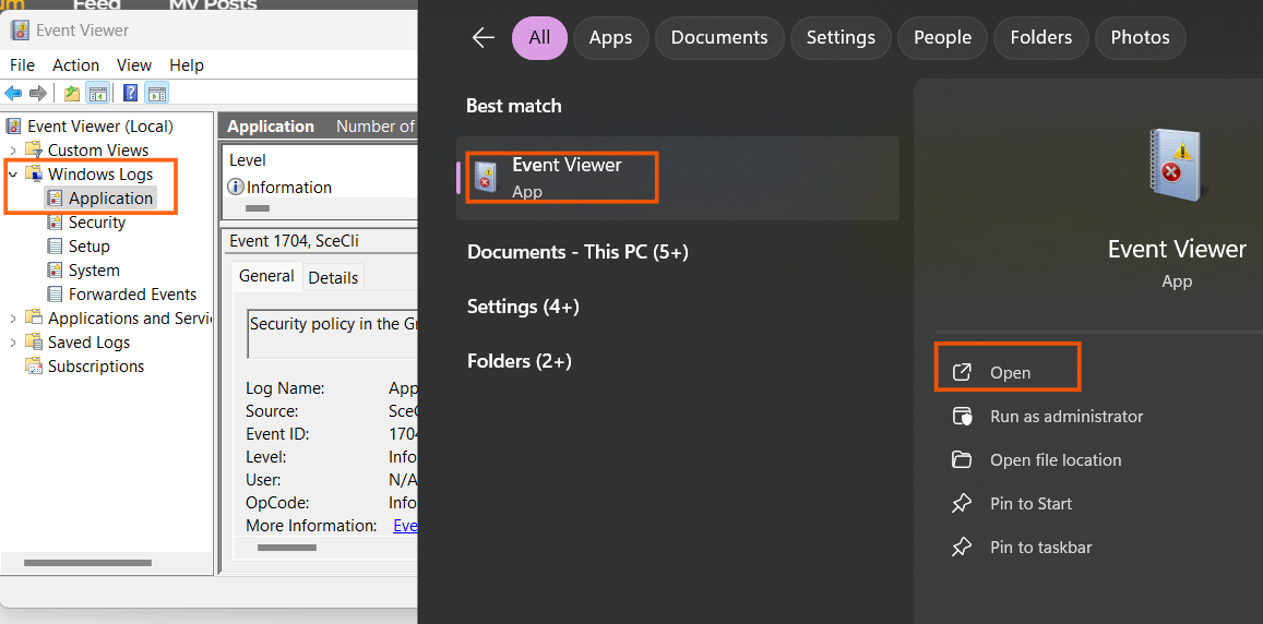

launch the workbench and re-produce the error then goto start menu> Event Viewer> Expand Windows log> Application> check if any error is visible related to Ansys Workbench.
The error mentioned in the screenshot is a generic error and can be caused due to multiple reasons, ex: old graphics driver, system's *.dll blocking the software or 3rd party software blocking the application.

Thank you for the reply. The message I get is "Error while waiting for Mechanical initialization to complete. Either the application crashed or Workbench lost communication with it." I tried reinstalling the software but I get the same error.
