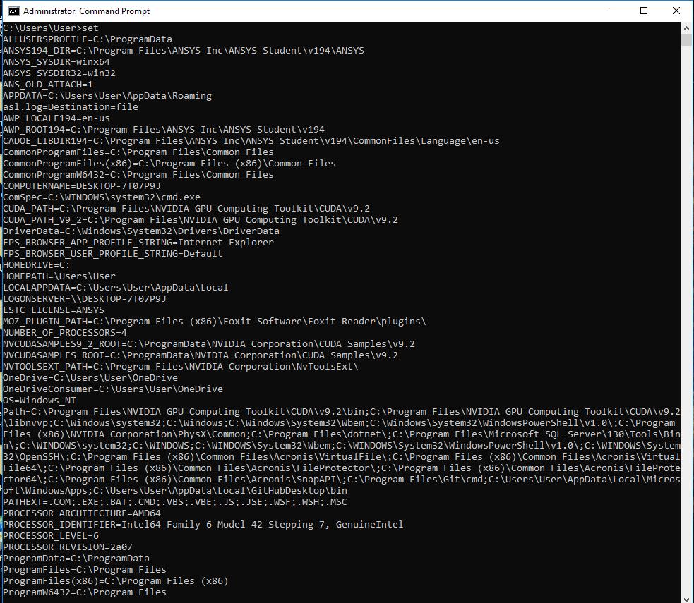

      When you are logging in as Alexey , open CMD Prompt, then type
      set
      and post the screenshot of the output here

       I undestand you mean. But what should i do? This is screenshot: https://ibb.co/x743FNT
    • user deleted
    • tsiriaks
      I meant for you to type 'set' (without quote ' ' ) in the CMD Prompt , then press 'Enter' . This would print out certain info I wanted to see.
      But I think I got the info I needed just by this screenshot that you post.
      Your username is not showing in English. You can see in the CMD Prompt that it's showing
      C:UsersA#####
      So, you will have to create a pure English username Windows account , login as that user, then try the mesh again.

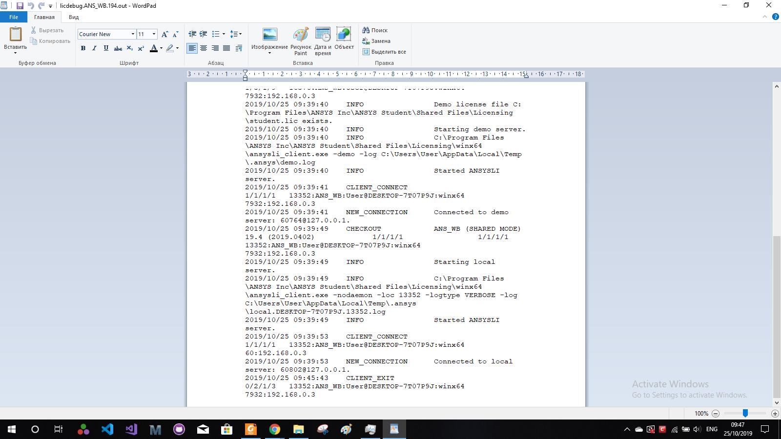

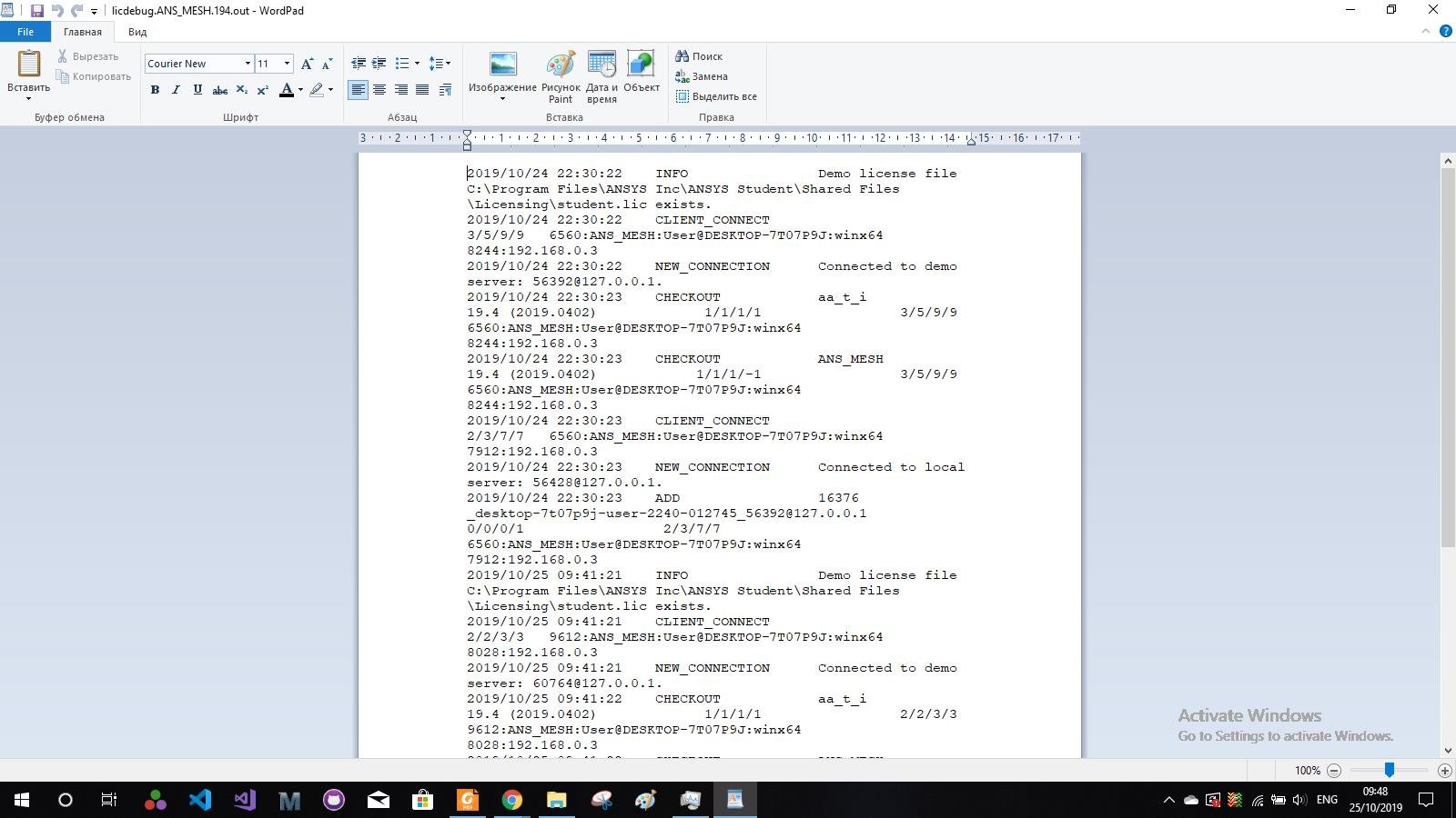

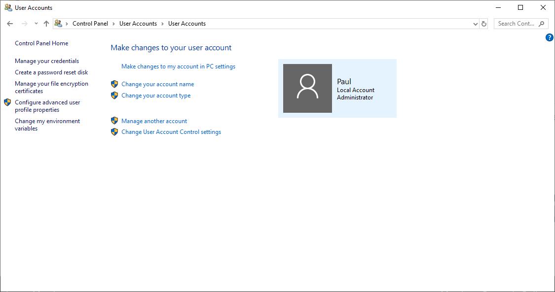

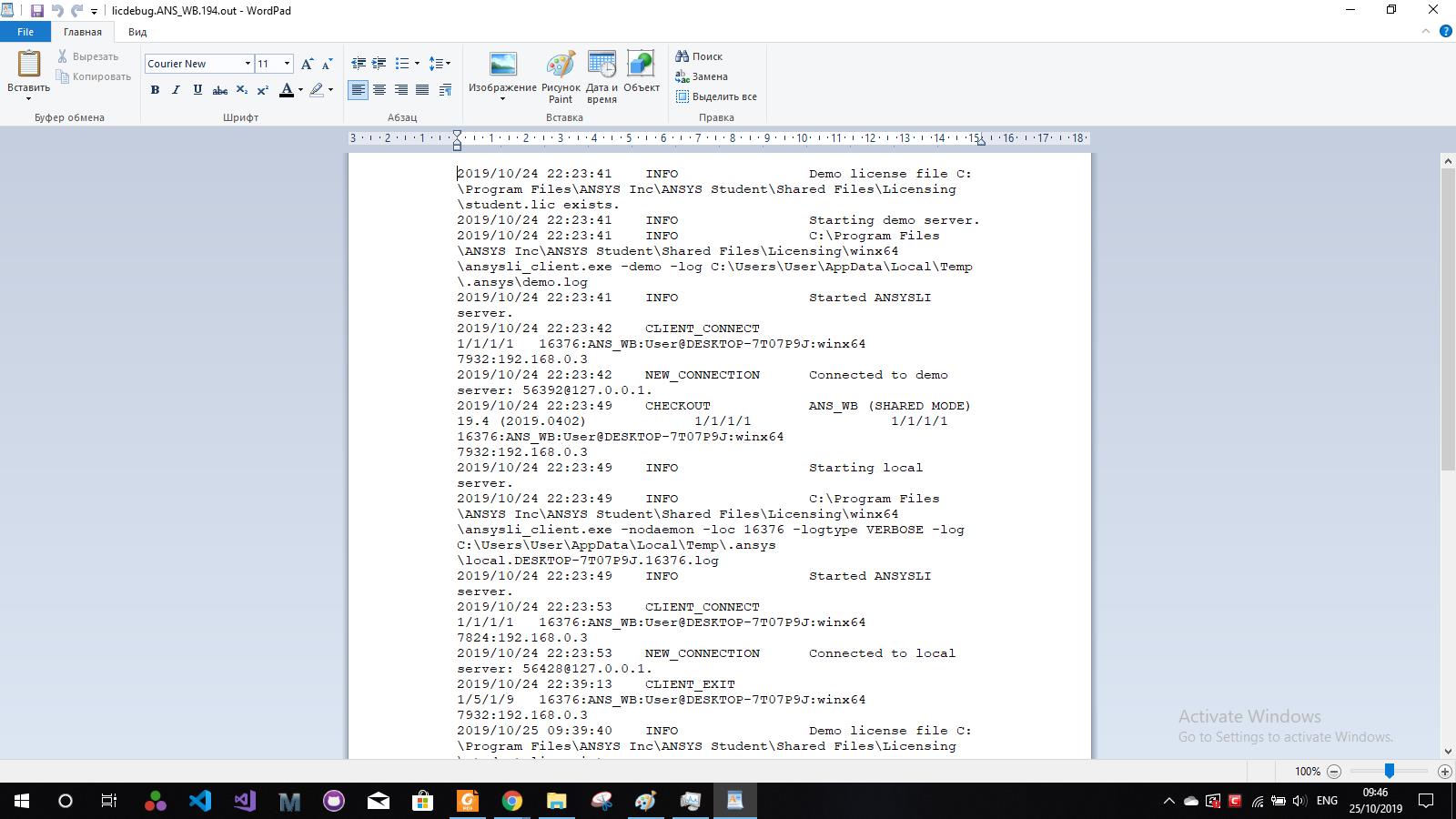

      I try to open ANSYS 2019 R3,but it shows Mechanical failed to open the database: The Mechanical editor does not have a valid license. Please refer the following directory for more information: C:UsersuserAppDataLocalTemp.ansys.I have changed my window account name to Paul ald,but it still shows
    • tsiriaks
      What is the name of the installation package that you used ?
