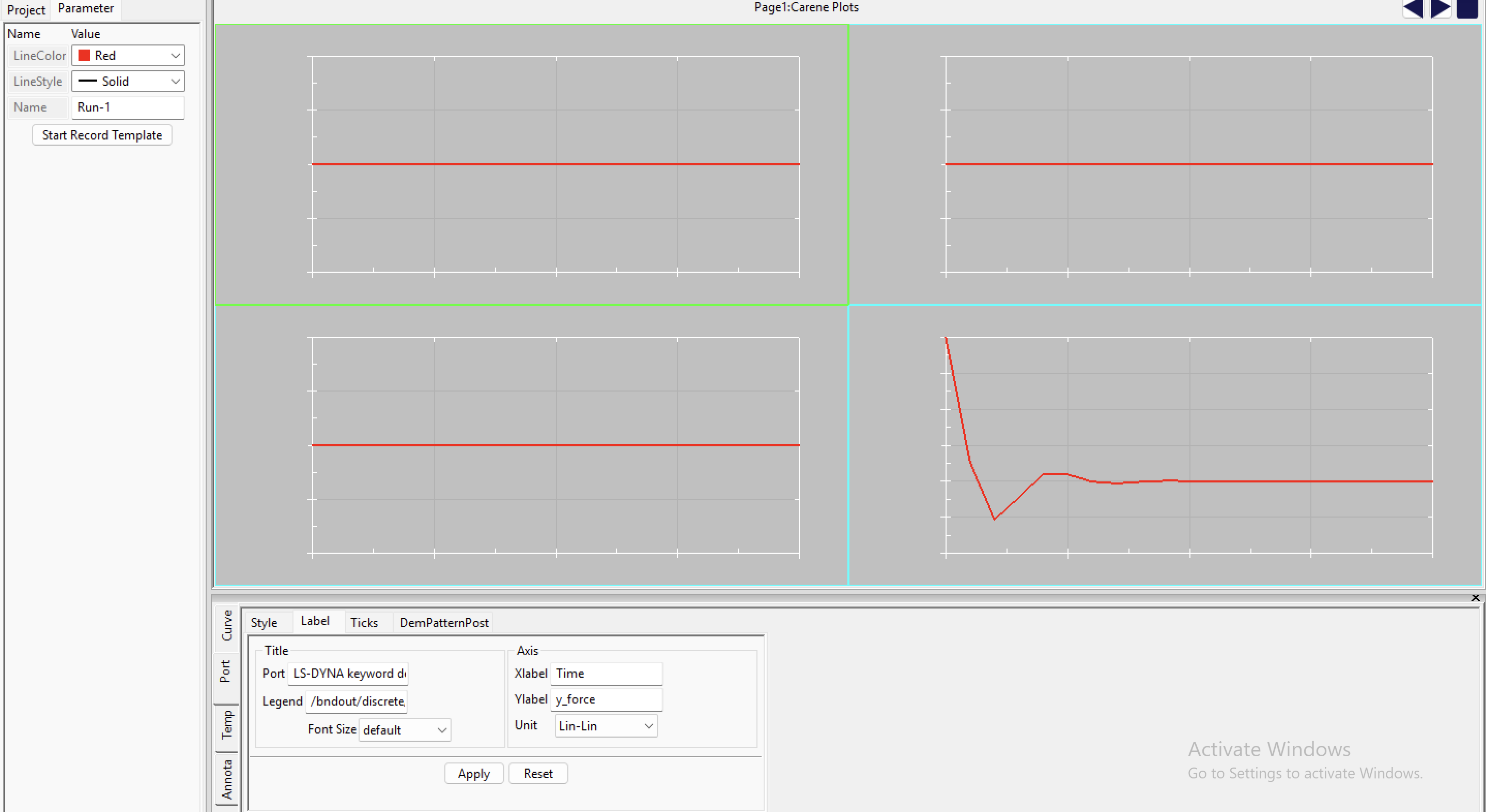

      I am using the latest student version of LS-PrePost / Dyna, and to my knowledge, this has not been an issue in previous versions.  A student is using a Mac with Parallels to make it operate as Microsoft.  When he makes a plot, no text appears.  He has changed colors, so that is not the issue; the text simply is not there.  Any thoughts on how to rememdy this?

      Could you try restting your configuration and let us know if it didn't help? For reference: ls prepost plot tick not shown
