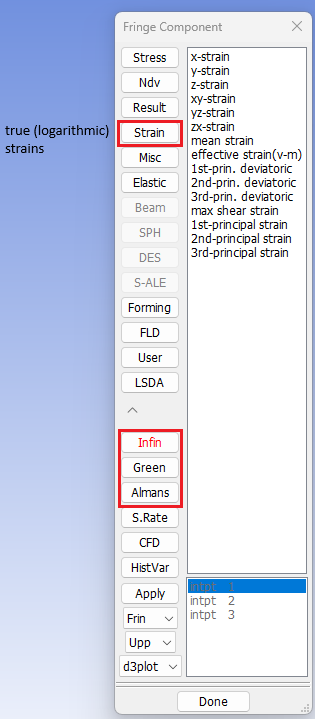

      LS-DYNAで表示されるひずみ(strain)につきまして,公称ひずみと真ひずみどちらを指しているのかご教示いただけますと幸いです.
      よろしくお願いいたします.
    • aabedini
      The strain measures displayed in LS-PrePost are true (logarithmic) strains; however, other strain measures are also accessible by selecting Post > Fringe Comp > Arrow, as shown in the image below.
