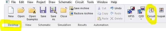

I want to import Spice model in HFSS to design matching network. Please let me know where I can find the tutorials and other resources for this.
April 12, 2019 at 8:42 pm
3Asif
SubscriberHi Ashishgmishra ,
The tool to work on matching network is: Ansys Circuit (already included with Ansys Desktop).
Watch this:
https://www.youtube.com/watch?v=CveDqaMdVAo
Open a circuit project, and then you can include your HFSS results as either (1) s-paramter symbol, or (2) HFSS linked symbol.
(It is basically drag and drop of HFSS design on circuit design).

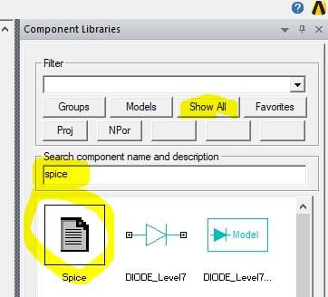

Then, you can also import your spiceÂ

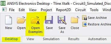

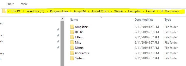

You can learn more about cicruits by browsing the examples included in installation
