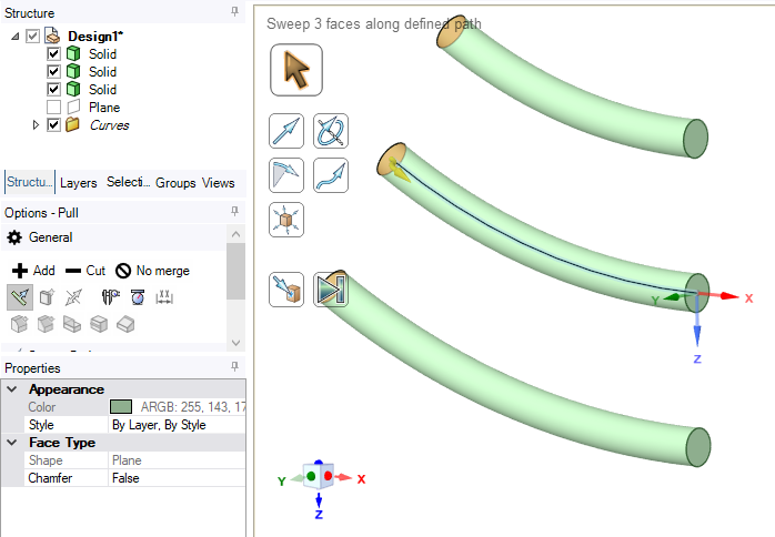

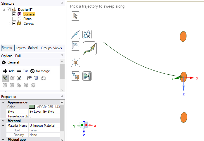

      The Pull tool has a Sweep button that allows you to select a face to sweep along a trajectory.  The face becomes the cross-section of the sweep.  A surface can be created that has 3 faces.  Here is a surface selected with the Pull Tool and the Sweep Button pushed then the arc selected for the Trajectory.
      Here is the result:

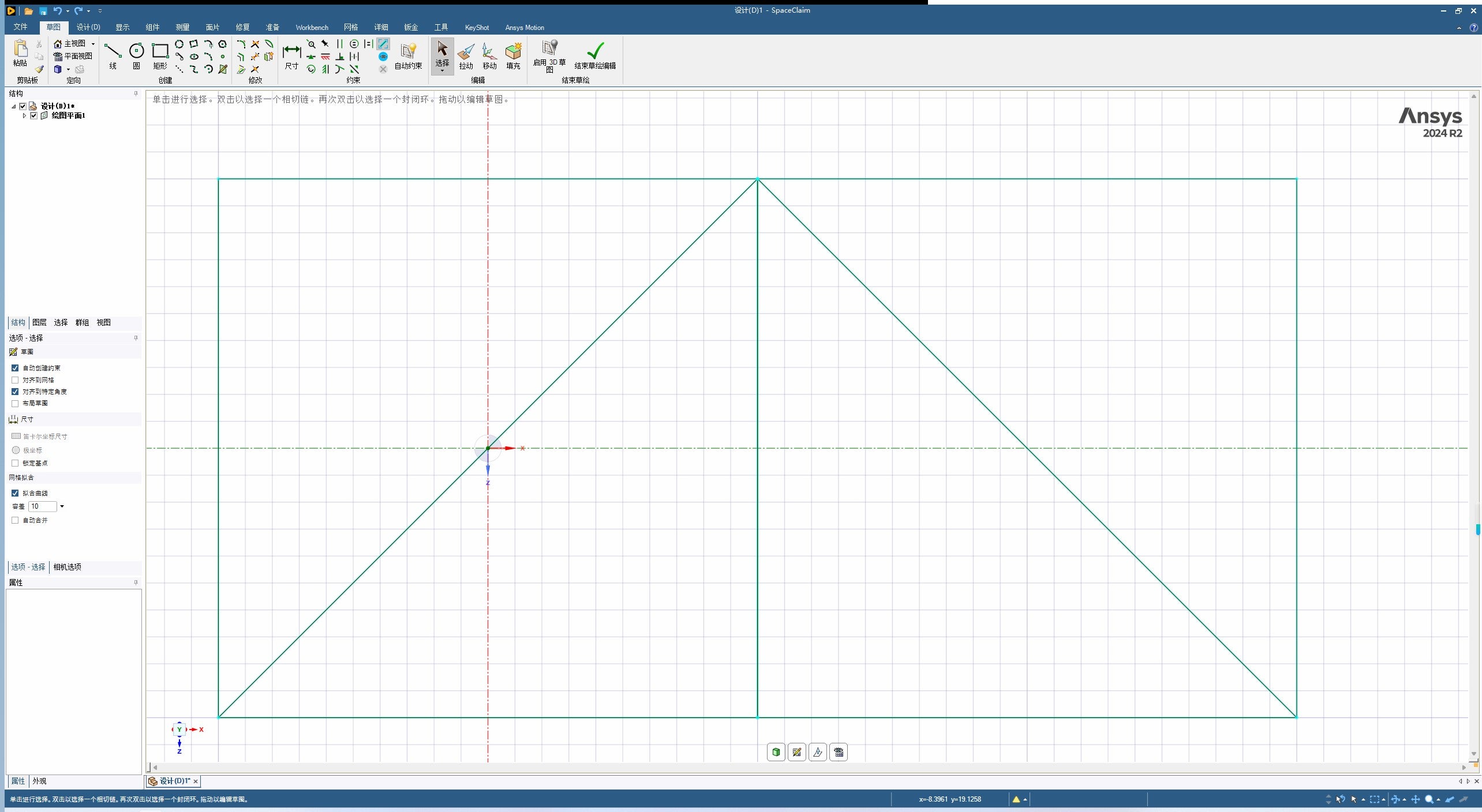

        Actually, I think you misunderstand my attempt on the opposite. What I want is to sweep lots of different lines by a face, instead of sweep a line by creating several faces.
        For instance, as the figure below shows, there are splines of a simple truss. I want to sweep them by a section pattern(such as an "I-shaped" face). How can I sweep all of lines at once?
