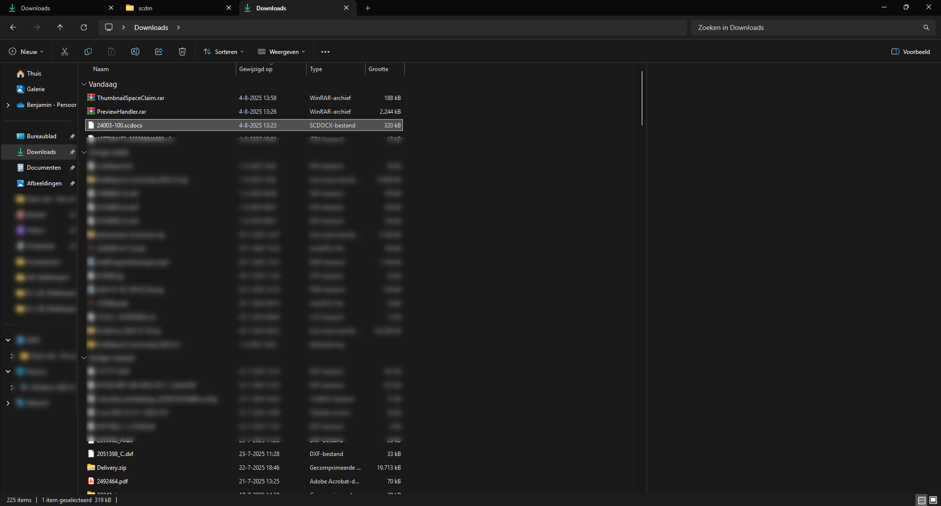

      Im not getting a preview of the following file.
      The small icon i can see but the big preview not:
      I already tried everything with the Thumbnail and previewHandler files but that does'nt work.
      Downloadlink file:  24003-100.scdocx

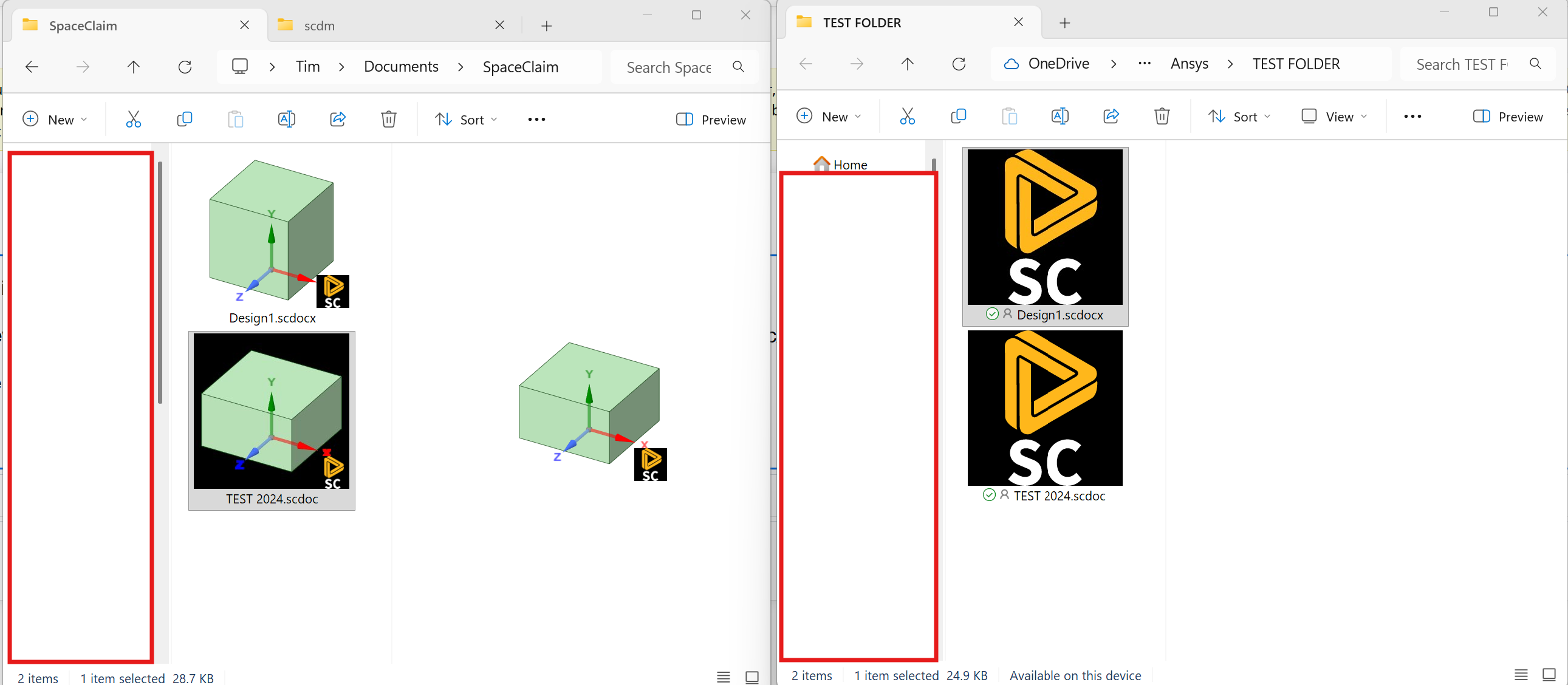

    • Tim Dukes
      Just wondering if there was ever a response to this and whether this is a onedrive issue.
      I can see previews in documents but no previews whenever a file is on onedrive whether scdoc or scdocx.
      I don't even see the small icon when using Onedrive
